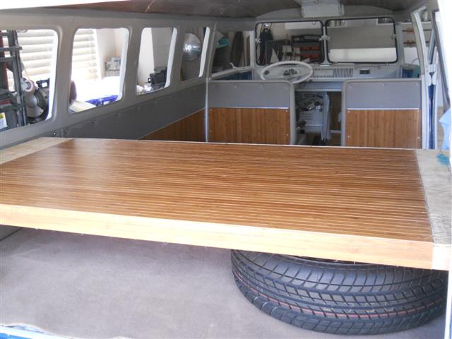

Got the rear area started this weekend. Cut out the spare tire tub a while back when doing body work. Placed sound deadner, heat shield and carpet in.

PostPosted: Sun Apr 08, 2012 6:18 am    Post subject: int Reply with quote
ready to put in the top shelf

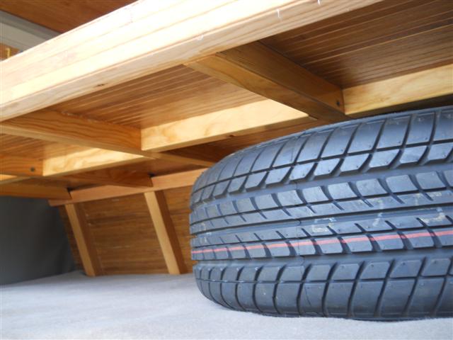

PostPosted: Sun Apr 08, 2012 6:23 am    Post subject: int Reply with quote
shot of the new storage area from below
and above
