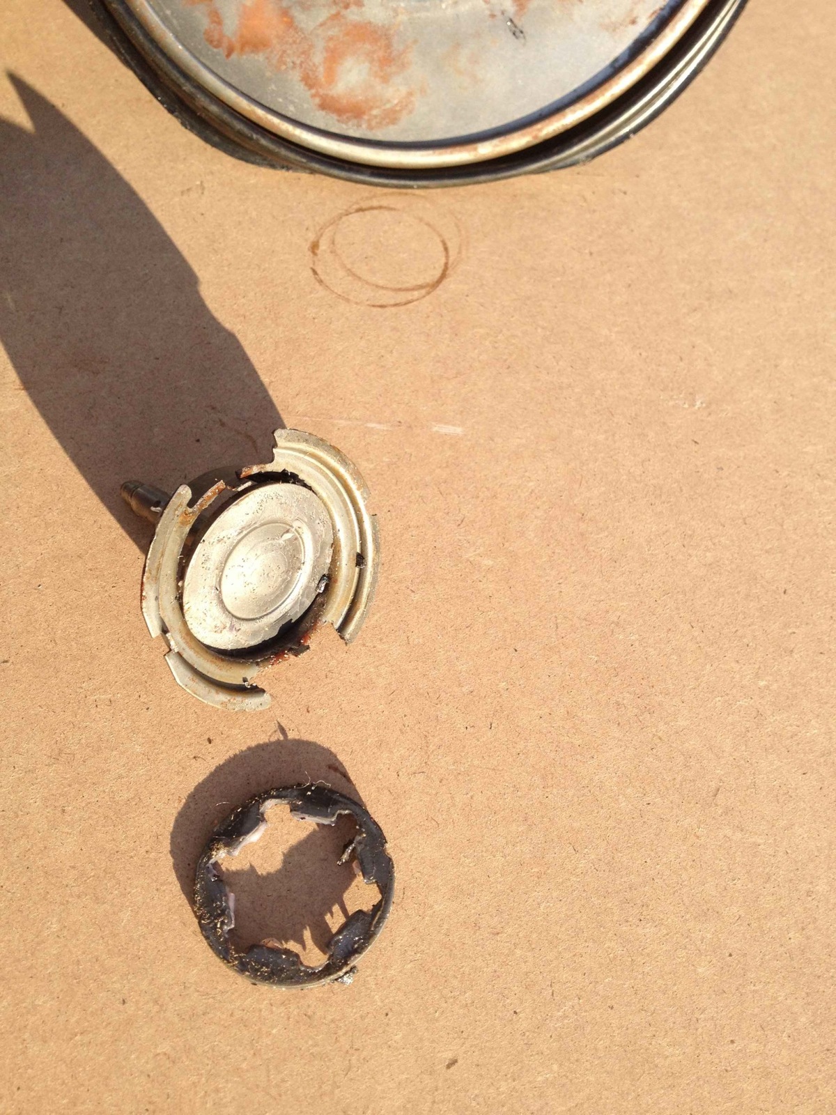

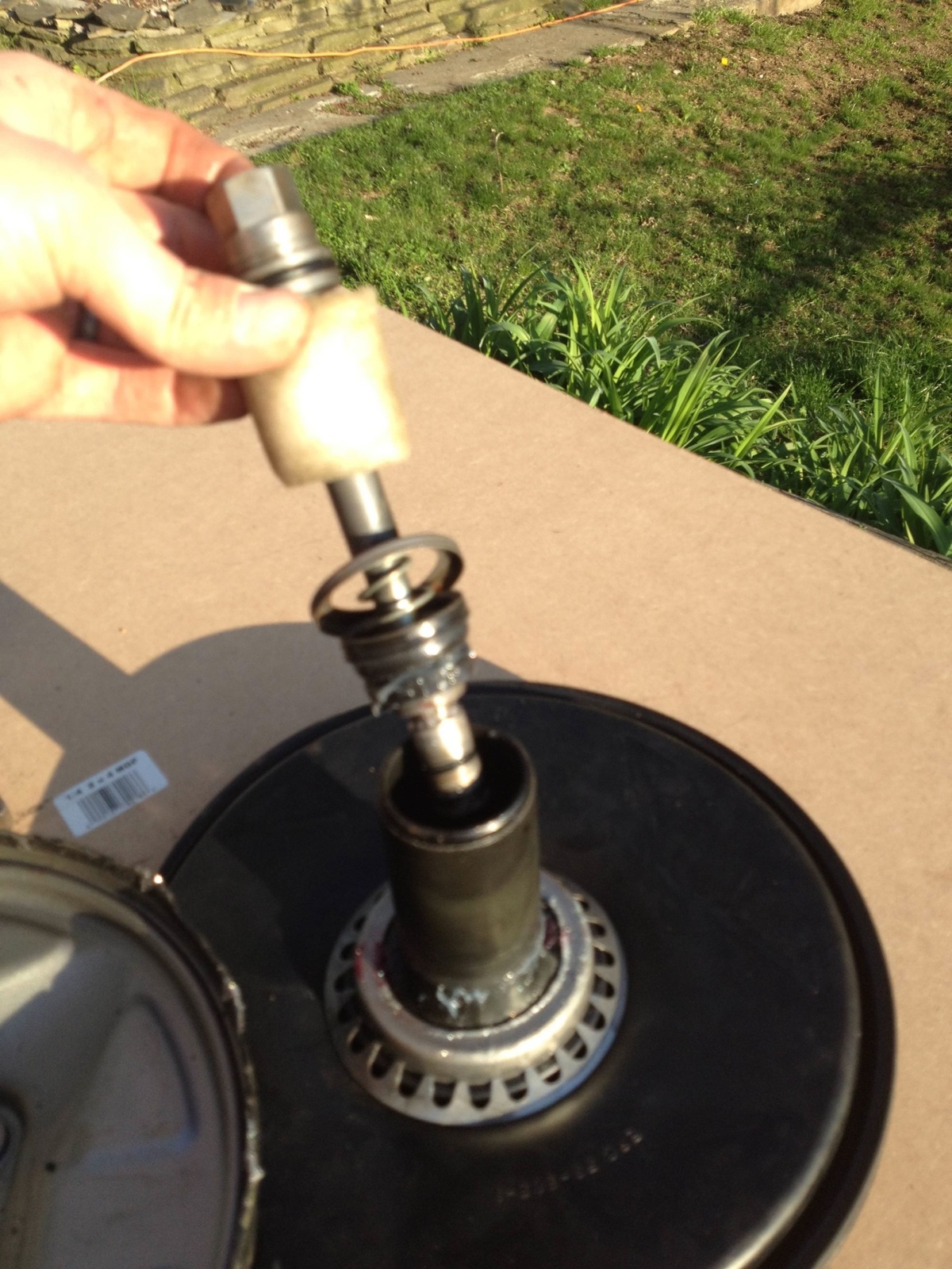

PostPosted: Thu May 24, 2012 6:25 pm    Post subject: Brake Booster, Servo, disassembled, took apart Reply with quote
OK, I have some results to report as promised. I was pretty fed up with the booster and the remanufacturer so I decided to just order a new booster from those folks across the pond that sell new ones. While I was awaiting it to arrive from its sailing voyage I decided to dissect the old one.
I was pretty paranoid after reading about the giant spring in the booster so I took some precautions. First, I built a jig to hold the thing securely in my 20 ton shop press. Then, I snugged it down with the press and pried the two pieces apart still snug in the press. After that I built a completely sealed enclosure surrounding it out of 3/4" plywood with 2" woodscrews and reinforced with 2X4's that would withstand any unexpected occurrences while slowly letting off of the pressure of the press. As I released the press I had a good laugh at myself. Even though the booster was under some pressure, I could have easily done it without the enclosure or the press. In fact, I can compress the spring and whole shebang with my hands. If I ever decide to do that again, I'll probably just sit on the booster, pry it apart, and then stand up. With that said, I would never use a booster I rebuilt and don't recommend anyone else do that either.
Anyway, here are some pictures of the cadaver for future reference if you ever need:

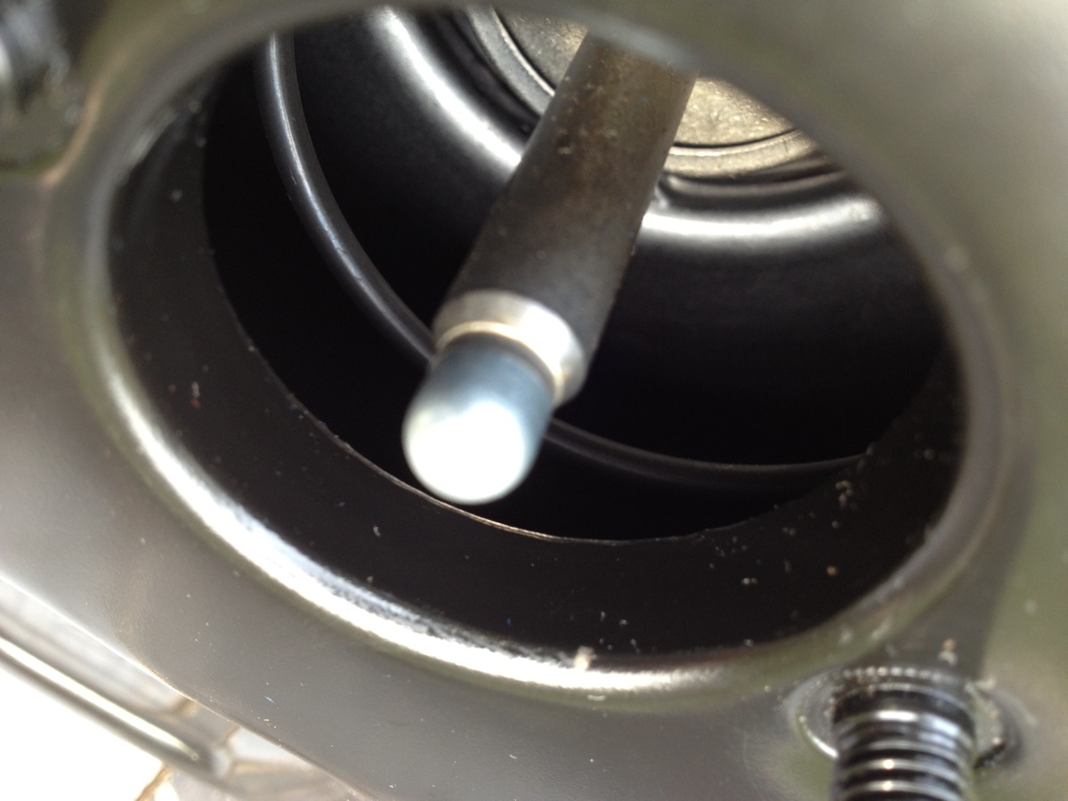

So I waited a couple of weeks and my new booster arrived in the mail. To my shock I had the exact problem as before. I almost fell over. And then I had a closer look..........
It turns out that the tip of the piston of both my new booster and the rebuilt one are removable. Not only that but there was a spacer placed in between the tip and the piston.
Note: some have a threaded adjuster on the end of the pushrod. That can be adjusted with a wrench.
Here is a picture of the piston. On the end you can see the spacer and tip:
Here is another view:
Here is what the piston looks like when you remove the tip and the spacer:
Here is a picture of the tip and spacer removed. They just pull out with some pliers:
It turns out that by removing that spacer, I had a perfect 1mm of play between the end of the piston and the cup of the master cylinder. Problem solved. All I needed was a little circumcision. I've been living in braking bliss ever since.
I hope this helps someone in the future. Hopefully, you can learn from my initial lack of observation. I suspect the engineers put this tip on to be replaceable in case of wear and the spacer to accommodate different master cylinder depths. Anyway, good luck.

PostPosted: Thu May 24, 2012 7:32 pm    Post subject: Reply with quote
Thanks for posting that, not only the dissection but the spacer deal, now that you mention it I've encountered a few that needed the master shimmed away from the booster but now I'll look for the washer first
Any chance of some close ups of the sealing surfaces the 2 valve discs sit on for future reference?
BTW better safe than sorry regarding the precautions. Wink

Yes, if you shim between the master and booster mounting surface you'll need gaskets or some sort of seal.
Removing the washer or shortening the rod or tip slightly is much less trouble (usually).
