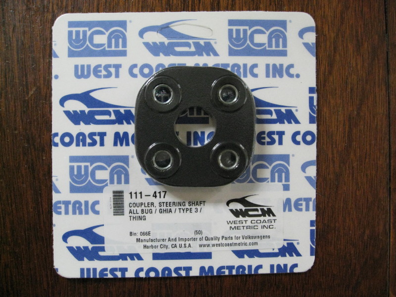

Update:
Called WCM. Guy there tells me that the couplers they sell are Brazilian, and all of them (Bus, Bug, Ghia) etc have those rounded square type design. They get them in bulk and package them themselves.
He was going back to check the bin...he said that they had almost 200 of them in stock (I think the 19 I thought I saw on the website was 191) and thanked me for giving them the heads up.
He is shipping me the correct one free of charge, and I expect that they will have their issues with unshipped stock sorted quickly.

Another Update:
Raoul from WCM called me again this morning. Every one of the couplers they had in stock, almost 200, were bus couplers mislabled as those for a bug. He has no idea how many may have gone out that way already, but he said they would make good on any that were mislabeled.
If you are a typical buggy guy, and buy parts well in advance of installation, AND you have bought a coupler from WCM, if I were you I would haul it out of the box and take a look at it, make sure it is the right one. Bus one is bigger.
For anyone ordering one now, they are currently out of stock, but he says that they will have the correct ones in this week. You could order now without worrying about getting the wrong part....they are very aware.

PostPosted: Tue Apr 27, 2010 4:38 pm    Post subject: Reply with quote
Took three weeks, and a few phone calls to WCM, but I did get the proper coupler. Way too much effort for a 5.00 part, but worth it in the end.
Below is the one that was sent to me originally, next to the urethane one that gets replaced. You'll see that the part numbers are the same, but the black coupler is much larger in this photo...it is for a bus. They had quite a stock of these mislabled parts, so if you have purchased one of these from WCM and thrown it in a box of parts yet to be used, haul it out and check it on your steering coupler hardware to make sure it fits.
