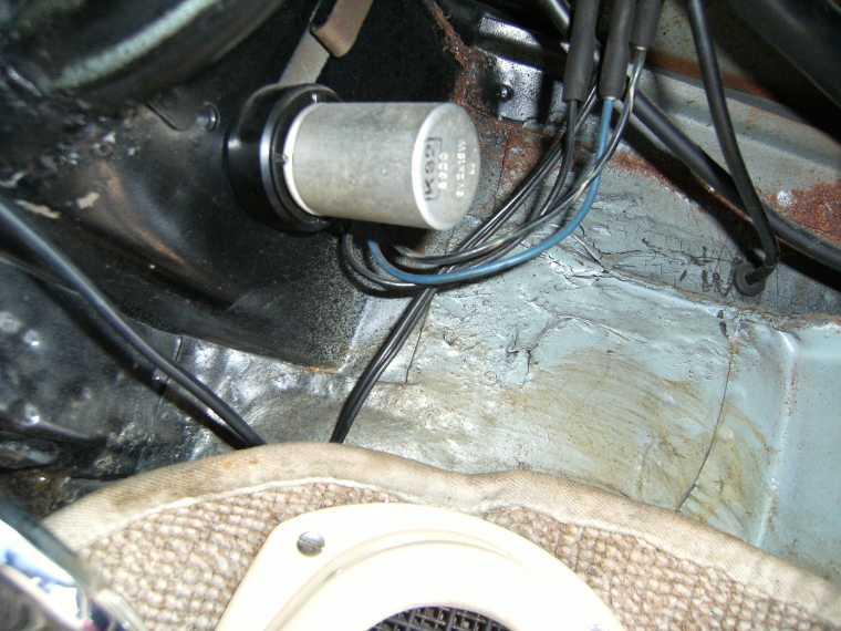

My car is 1953 #51576. I don't know if my setup is original, but it all works properly (i.e., the little red light in the turn signal stalk lights and flashes properly). Mine does NOT have a socket. There are 4 wires as opposed to the typical 3 that are used in later cars. Evidently this is what is required on the earlier cars:
http://porsche356registry.org/356talk/topic.html?p=120401#p120401
Here's an image. The complete part number is Hella 91MS 2x18-20W 6V.
HTH, _________________ Jack Stenner

Thanks Jack,
That would appear to verify the change from the wired 4 prong to the 3 prong socket type occurred at the 54 model. The updated one now available is far superior to the originals functionality. You can actually hear it working and it's never erratic in it's behavior. One of the highly recommended upgrades for your car if you drive it. _________________ Regards,

That would appear to verify the change from the wired 4 prong to the 3 prong socket type occurred at the 54 model. The updated one now available is far superior to the originals functionality. You can actually hear it working and it's never erratic in it's behavior. One of the highly recommended upgrades for your car if you drive it. |
I think if I "upgraded" I'd loose my entertaining little stalk indicator:
Mine makes a nicely audible clicking noise, but, yes, it tends to slow at low idle! _________________ Jack Stenner

Most likely the reason for the 4th tang on the flasher. Very nice. _________________ Regards,

Gentlemen:
I don't think the issue of socket is settled as my T-1 A did not have one. Instead, a clip held the barrel of a flasher with screw-on connectors.
I had to build wire end adapters for the later 12v can I use currently.
I'll have to check later to see if the original was 3 or 4 pole. _________________ Keep 'em flying...
S.J.Szabo |

The 4th wire on the pre a (and some early t1) supplied an external ground for the flasher can. Later model cans did not require the additional wire. The ground wire appears to be an internal function to the can, not the signal system, as I have fitted 2 or 3 prong cans on many early cars with no loss of function to any lights or systems. It is interesting that the 'new' transistorized units (zims etc) require fitting of a ground wire. 3 prong plug sockets for the can appeared in t1 production, and were used until the end of the 356 production _________________ Jack Staggs
Actual name |
