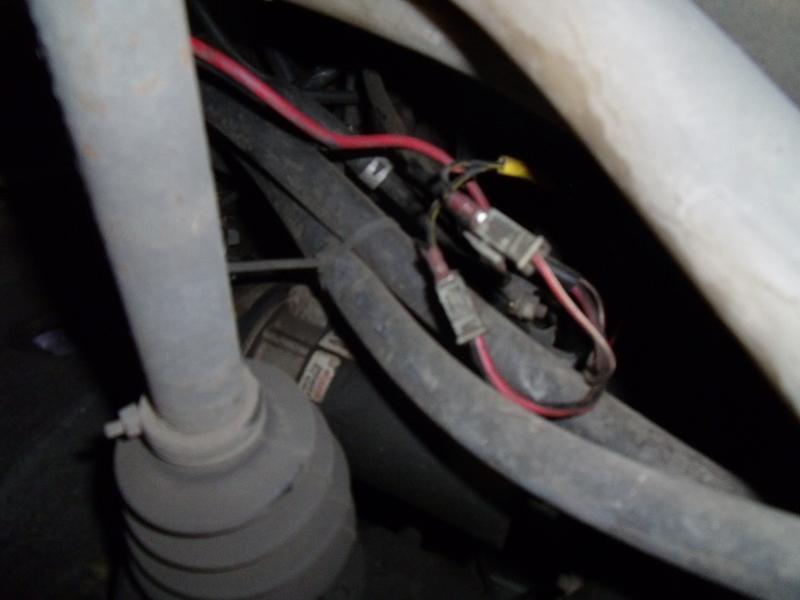

Okay all connections and grounds are good, except these:
These are coming off the solenoid and they are slightly loose and dirty. I will replace with new and see how it goes!

yeah I'd suspect them..
and don't tell me that that spring clamp is on your high pressure fuel line Exclamation
it might be ok. but I'd prefer to have a proper fuel injection screw clamp.
