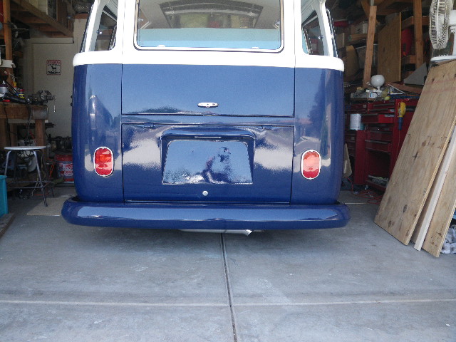

Vintage Speed
President of "Society of Unappreciated Overachievers"
62 - 23 Window Bus
60 - Karmann Ghia Convertible
59 - Convertible Raceable Baja Bug
63 - Dune Buggy
65 - Single Cab
