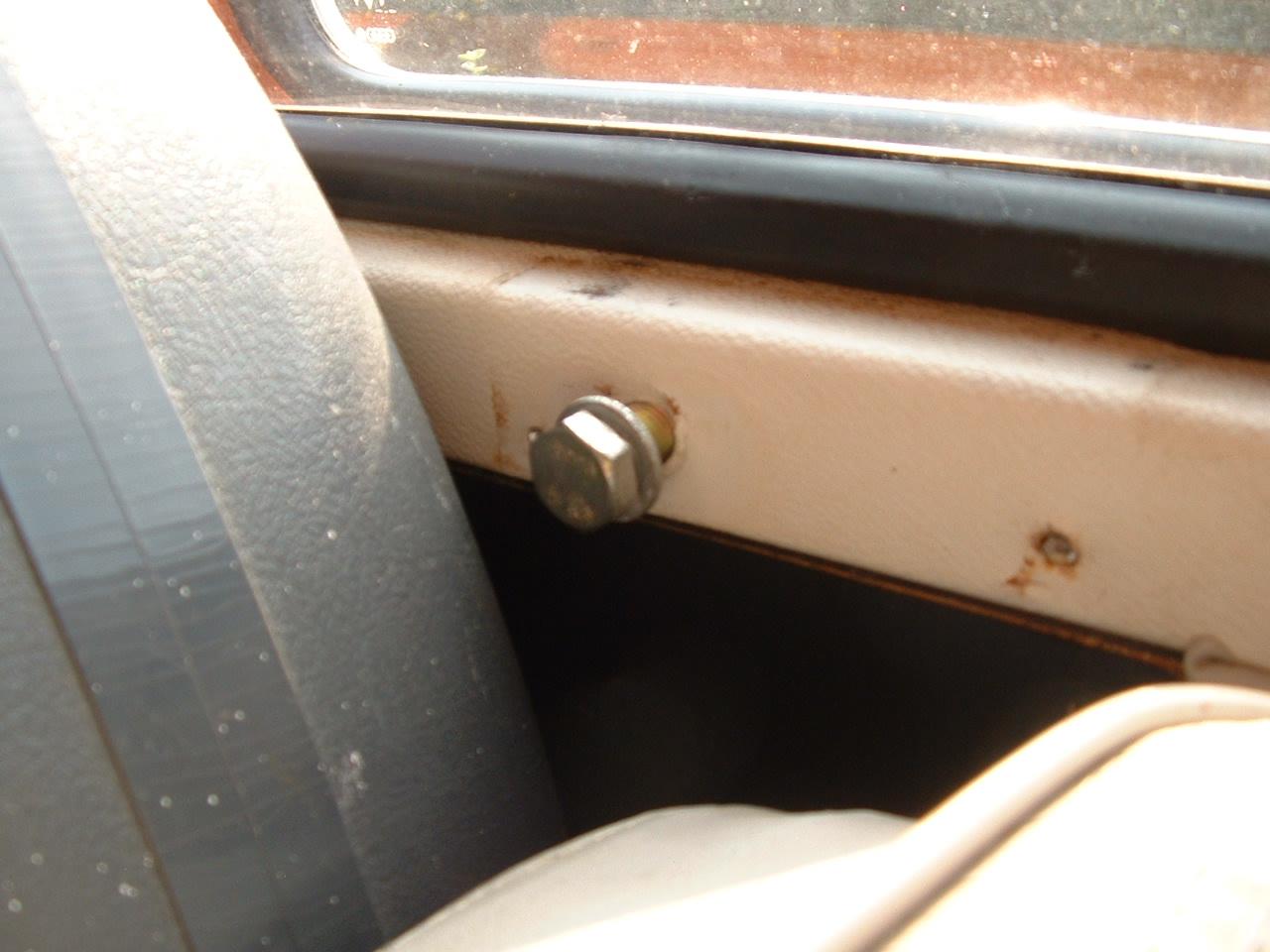

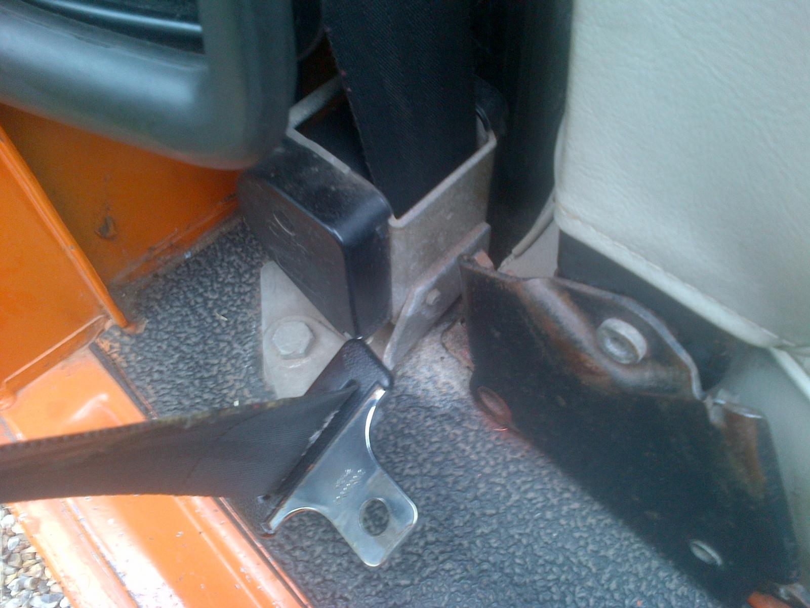

1976 T2 deluxe microbus body, rear seat belt fixing anchor points. On this deluxe frame microbus, I have VW of Australia extension brackets for the near and off side rear seat belts, which were fitted as standard with VW/Audi marked Repa belts to meet what is known as the requirements of the ADR (Australian Drving Regulations).

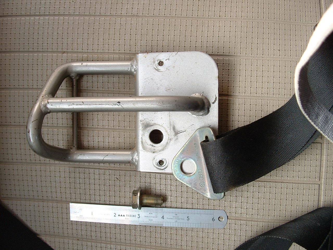

Here is the VW of Australia rear belt extension ADR compliant bracket removed, there is one bracket each side of the rear bench seat, plus a standard lap belt in the middle of the rear bench seat:
On the deluxe body, these 10mm thread fixing holes (17mm spanner) are an integral part of the vehicle body, integrated into the frame during manufacturing. Absolutely solid fixings:

I thought I should add to this thread as an ongoing resource for info, as I stumbled upon some repros of the Australian brackets for the front seats.
These brackets were made by VW of Australia for the T2, pictured below is an original bracket on my 1976 Microbus, with original VW Audi inertia reels by the OEM manufacturer Repa, to comply with the ADR (Australian Design Rules) which required inertia reel seat belts in the front for the driver and passenger, and enabled the repositioning of an inertia reel block, pushing it further back and inwards so they do not clash with the door and seat, utilising and retaining the stock seat belt anchor point.
I found online that repros are now available and made in the UK:
http://www.status-vw.co.uk/bay-van-68-79/main-body...-1979.html
http://www.justkampers.com/211-809-257-cab-seat-belt-brackets-vw-t2-bay-1967-1979.html
The original brackets, and the repros, should fit all years of T2 bay windows, although I assume they are probably of not much use to Westfalia owners with the swivel seats and no bulkhead (bay window Westies were not generally available in Australia in any case so I understand).
