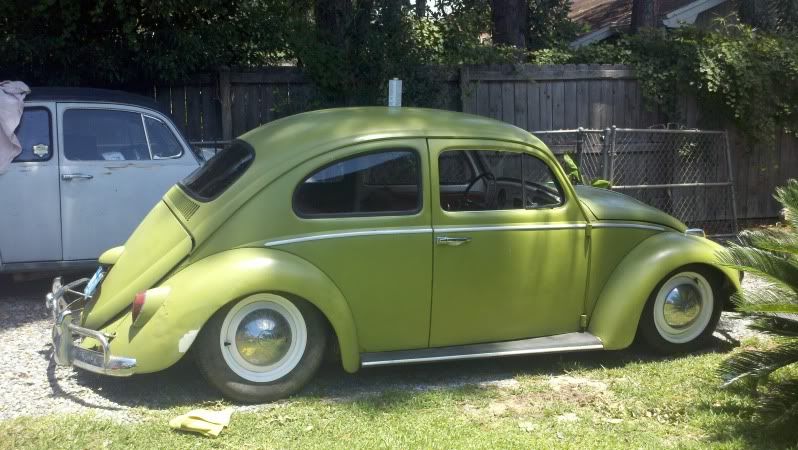

me and a buddy have about 4 hours on this we was useing lacquer thinner and steel wool to get the spray paint off underneith the green is white and patina gettin there slowly but surely.
before
getting there
almost still alot to do

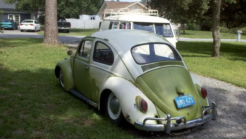

Here is my baby....it took me three years of working on it off and on to get the original indigo blue back but here she is and I couldnt be happier with how it turned out. This thread pushed me on when i felt like just giving up and painting her.

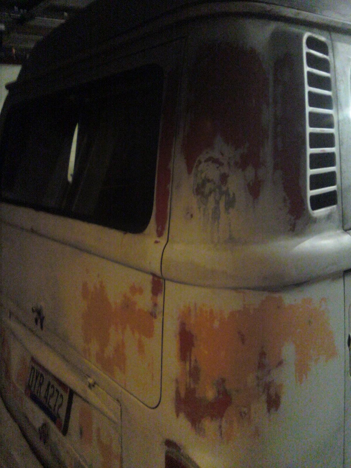

Some jackwagon covered my beautiful bus with white primer before she got to me. In some places it is SUPER THICK.
Observations:
-I dug in and it took me some time to figure out a system.
-Wear a respirator. I was in a ventilated area and I still have a headache
-My bus is a '73.999 and was a nice dark orange from the factory. Started removing primer and the lower half seemed a lot lighter. Since I'm colorblind, I figured it was just faded orange. Then, the "faded orange" started coming up and I started freaking out. Had some kids walking by tell me if it was orange or some other color and they told me it was peach. Looks like my bus was painted two-tone at one point. Applied the same method to the peach layer and it revealed the orange I was looking for.
Here are the results of my first night. Here's the method I settled on after playing with it. I'm no expert. This just seems to be working...
1. Spray a 12" x 12" area with heavy duty dollar general easy off. DG is $2.75 a can vs. $4.75 for name brand.
2. Wait about ten minutes and dab up the excess as it tries to run.
3. It is ready when you can lightly run the point on your plastic putty knife across it and it gouges down to the og paint. Emphasis on "lightly". I would just run lines across the entire area with the edge and where it showed the color I wanted is where I would focus my efforts.
4. Lightly scrape getting rid of the bulk of the paint. You may or may not get down to the og paint with the scraper.
5. Take a no-scratch scotch-brite pad and apply even pressure as you work in circles. Keep the area wet with easy-off or motsenbockers.
6. If it doesn't come off, do the scraper point test again and see if you need to soften it up with some ez-off. DO NOT GET IN A HURRY AND SCRUB AGGRESSIVELY!!!! Let the chemicals do the work.
7. Wipe down with a wet rag to neutralize chemicals.
Sorry for the crappy pic. Got to be night time when I remembered to take a pic. Before pic is a half hour into it.

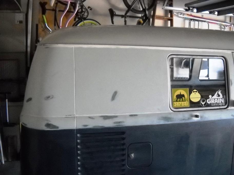

I'm using Jasco and 0000 steel wool. This thread helped alot in getting me started with this. The cargo door was done when I bought her to show whats underneath, and besides the nose damage (which isn't as bad as it looks, but there will be a good amount of attempted paint matching there), I'm hoping the rest of the bus looks that good underneath! Not sure what prior owners did, the paint is thicker in some spots than others, yet I'm finding some spots that were sanded down to bare metal... I've had really good luck so far not going through the OG paint, so I'm just going to continue to take my time, and enjoy the result!
Before:
So far:
