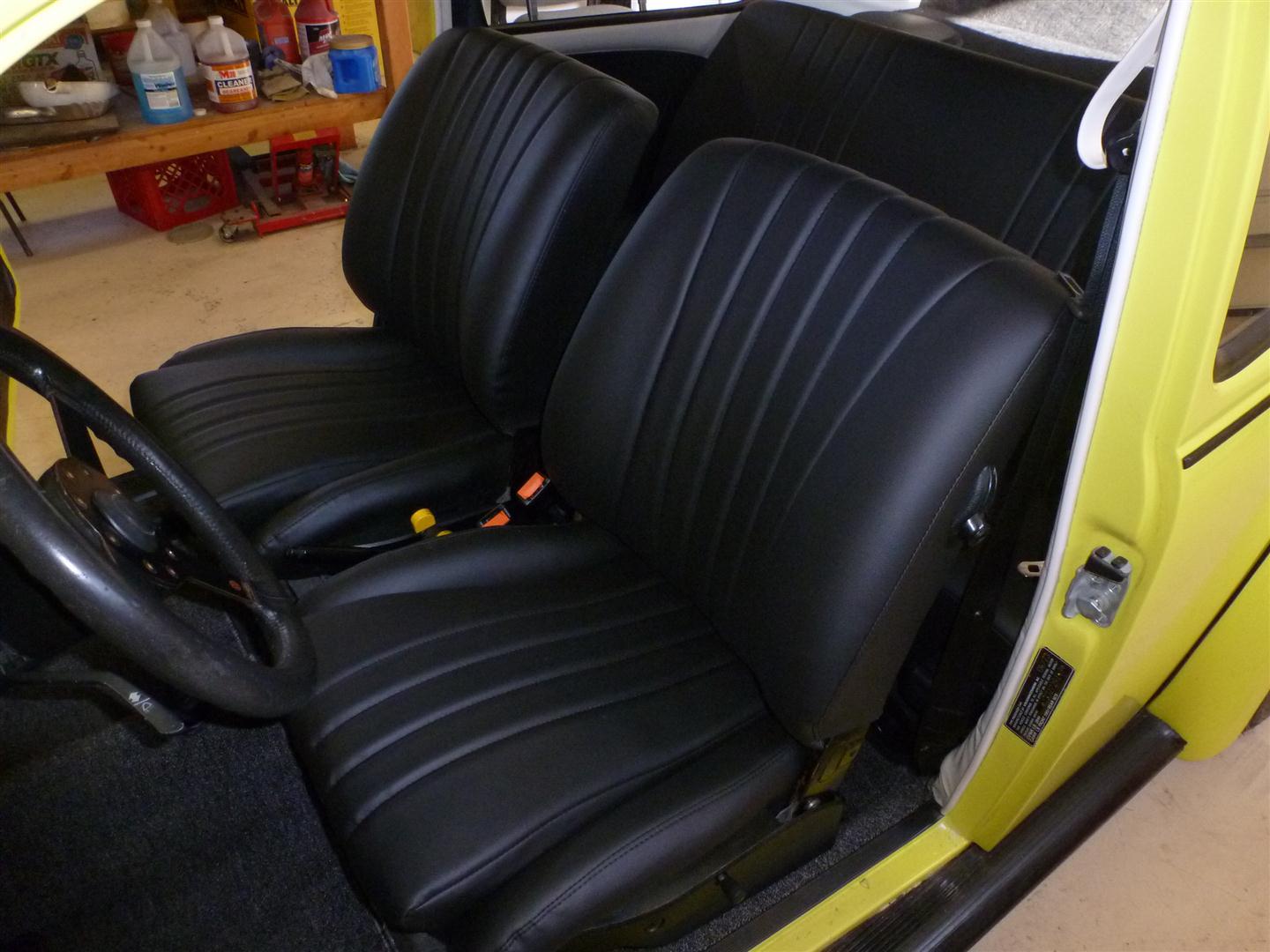

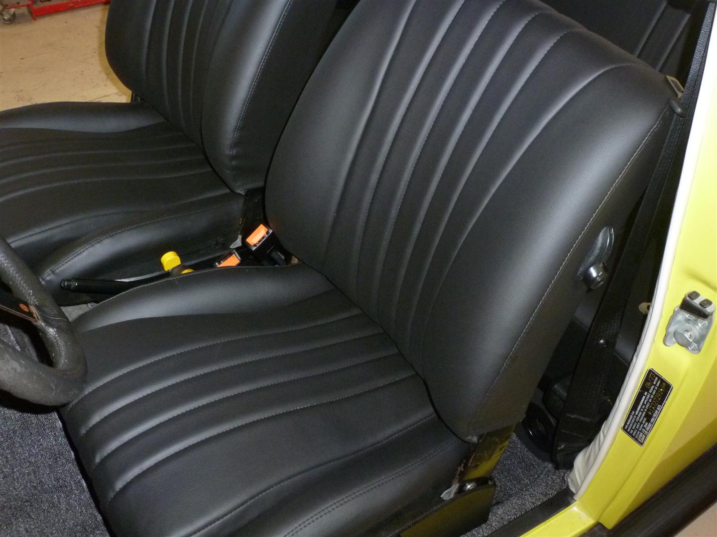

Posted: Wed Dec 12, 2012 6:35 pm Post subject: Sport Bug Seats |
well I got the front end aligned and what a nice difference that makes. steers straight, no pull , no shimmy. rear end was within spec as well.
I bit the Bullet and decided to Cover the seats since my stock seats were so ratty and the foam and coco fiber was gone.
I spoke to Carol at Sewfine for an Hour , friday after thanksgiving and decided to go with her Product. Since nobody can find the Original fabric for the Inserts I went with her extreme vinyl for the whole cover rather than have inserts of a different material.
I ordered the covers in Extreme vinyl, along with Front seat back foam ( from the 77-79 convertible) and rear seat seat foam as well.
I was able to use my front seat bottoms and since the bolsters were pretty broken down I was able to glue them together and pad them with felt padding and wrap them with a fabric material. I also added some felt to the metal frames that the Bolsters sit on - to make them a bit more padded. the Bolster covers she supplied had 1/8 scrim foam inside which covered up any imperfections I may have added to the bolsters.
Currently I am running them Without the Headrests - for now. I can add them at a later date, but I kinda like the Nostalgic look they have as Lowbacks. It really opens up the interior and makes backing out in reverse a lot nicer.
Please Post your thoughts with or with out Headrests ?
I must say the quality of Sewfine seat covers is amazing! everything Fit like it was supposed to. they are more expensive but the quality is there ! and the extreme vinyl is very nice and leather like.
here's a couple Pics:
I have pics of the Recovering process if anyone needs more information.

docdanracy Samba Member
Joined: June 26, 2012 Posts: 1119 Location: Auburn, CA
Posted: Wed Dec 12, 2012 6:40 pm Post subject: |
Seats came out great!  _________________ Doc

flierbob Samba Member
Joined: August 21, 2008 Posts: 538 Location: Silverdale WA
Posted: Wed Dec 12, 2012 6:47 pm Post subject: |
Looking good, looks like you made a great choice.

I also picked up some vinyl 3/4" yellow for the Bumpers shown in the photo's. I removed the bumpers to put the vinyl on in one piece.
I also added the headrests back on to the seats as shown below. I do kind of like the headrests on and am pretty happy with the results.
thanks to steve at beaverstripes for setting me up and thanks to the other Samba member whom took the old stripe to them to create the copy.
