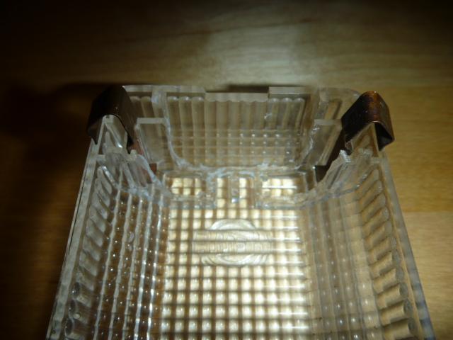

I wanted to use the full width of my light, so some cutting in the light cover was necessary. You could use smaller cathodes, but that's not what I wanted. I had a spare light assembly so I can always go back to stock if I like.
Disassembly of the light is pretty self explanatory, so I'll just jump into the modification.
Here it is pre cut.
And after trimming the plastic out of the way with the dremel and sanding it a bit. Be sure to leave enough plastic on the sides so that you can still reinstall the mounting plate.

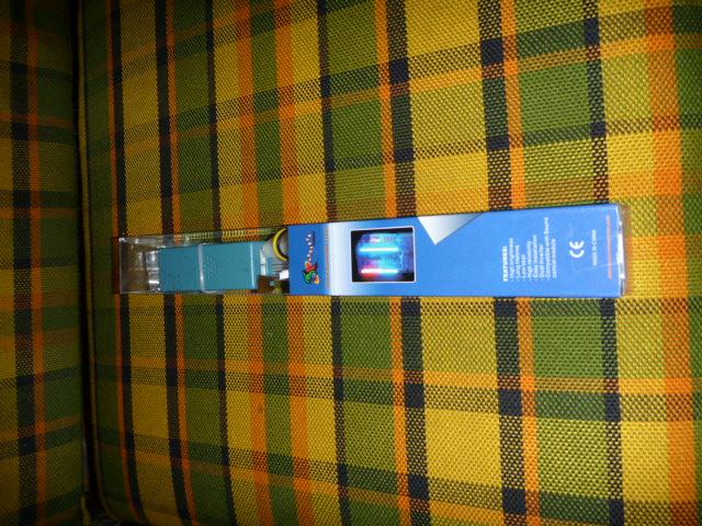

Here is the kit I used. It looks well made and is only about 7 bucks.
Once you remove the old transistor circuitry the new inverter from this kit fits perfectly in place. I used the velcro tape provided to mount this as well as the tubes, and zip ties to keep the wiring secure.

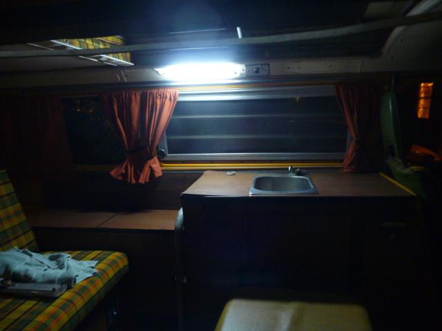

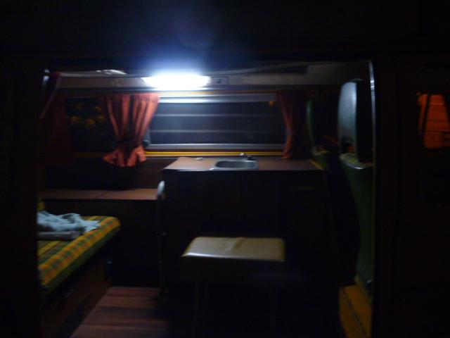

And, here are some before and after.
And a big improvement.

The pictures make it look a little harsh, but in reality it doesn't blind you and really cast some good light around.
