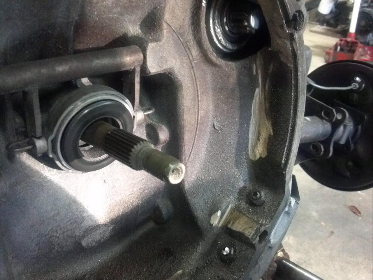

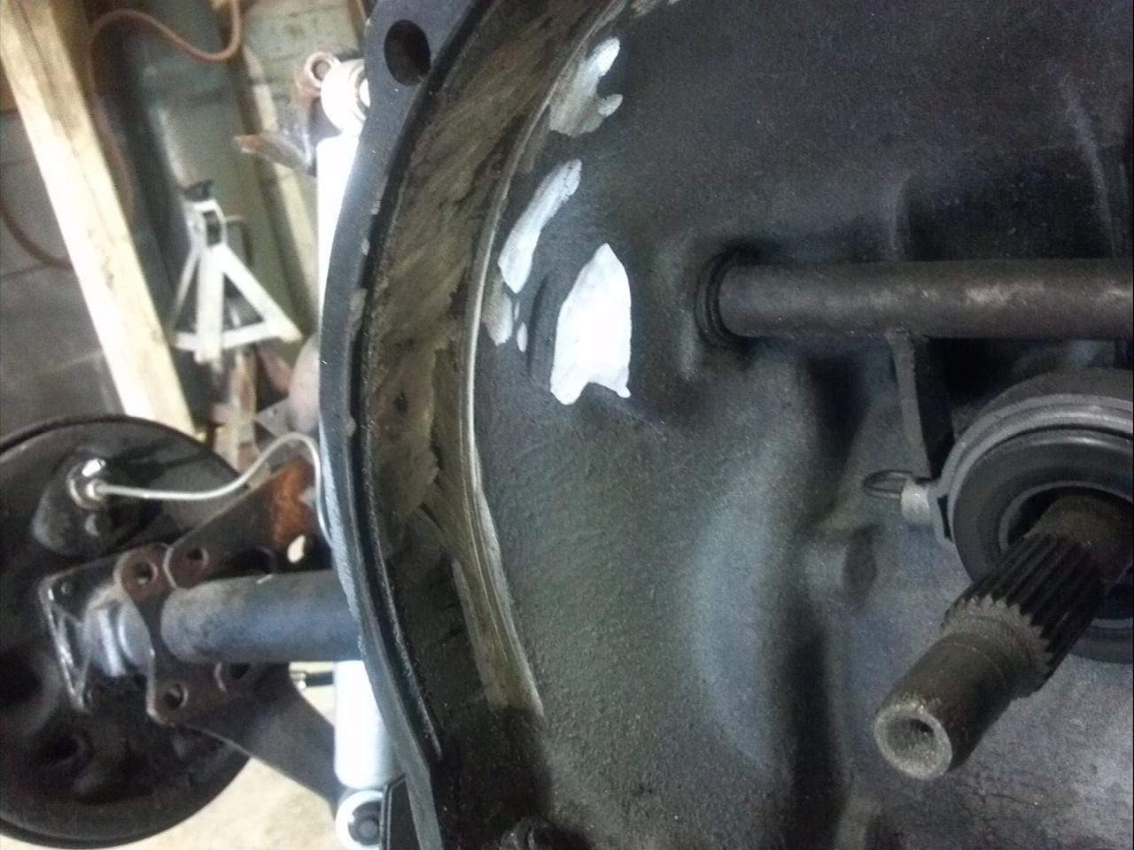

drs1023
Joined: October 20, 2011
Posts: 1682
Location: Georgia, USA
drs1023 is offline
PostPosted: Wed Jun 12, 2013 11:29 am    Post subject: Reply with quote
Takes less than an hour to make the larger flywheel fit into your early transmission. Here's what my '63 trans looked like - the shiny spots are all that need the touching up, not the entire transmission.
Install the engine and flywheel until it touches. Remove all spark plugs from the engine and turn it with a wrench/ratchet until it leaves score marks. Back the engine out and remove the material. It may take a cooupla' times to get the flywheel to spin without hitting the transaxle. I used a flap wheel on a 4" grinder and a Dremel with a small spiral cutter to get rid of very little material.
