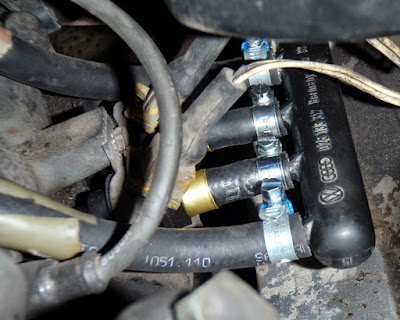

i did a lot of reading on fuel hose, and my research led me to find a pretty good deal on some dayco J30R9 rated hose. hopefully someday i'll get as many views on a thread about something slightly more interesting!
after a few more lunch breaks spent reading about fuel injectors here on the samba, i decided that replacing my aged (and perfectly functional) bosch injectors with new sorenson ones was preferable to my other options (keeping the old ones and hoping they don't fail, buying $$$ new bosch ones, or sending my existing ones out for ultrasonic cleaning and leaving the van off the road while i wait for their return). for a little more than the cost of cleaning my existing injectors, i got a set of GP Sorenson 800-1206N rotary injectors from autozone ($113 with coupon code).
with all the parts amassed, i figured i could take care of the job in a weekend afternoon and not be without my van for a single work commute.
VC was out of the fuel line sleeve material, so i slit my old ones and reused them. i realize they are mostly superfluous, but they are pretty easy to install when slit and give me peace of mind in a few locations (such as the sharp flange in the intake manifold just to the right of the pressure regulator).
i replaced the fuel pump and filter as well. the pump was working fine but was needed on the rusty van to replace a leaking one. i went with the chinese rebuilt replacement from VC after they assured me they'd had no reliability issues with them.
i hooked up my fuel pressure gauge to check everything out, and noticed that i was measuring 34psi at idle, rather than the 29 speced in bentley. oh well, i felt bad about replacing all but one component anyway, so i ordered up a new bosch pressure regulator from gowesty autoparts. that completed the replacement of every part of the fuel delivery system.
there, now i feel better. time to work on something a little more fun.

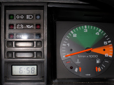

that was fun... but my fetish for blue LEDs was not yet satisfied. the next step was replacing the incandescent gauge illumination with, you guessed it, blue LEDS! i noticed that the diodes used in these modules had enough output in the UV spectrum to cause fluorescent painted items to glow, so i ordered a set of different colors of fluorescent paint from blacklight.com. i was pretty unimpressed by the luminance of their paint, and even less impressed by its uneven coverage. but i'd spent $35 on the stuff so i felt compelled to use it!
it took about 5 coats to cover up the white of the gauge needles completely. to anyone else trying this, i have subsequently found fluorescent marking paint available in rattle cans for $7 at some ace hardware stores. i would recommend this as an alternative to the crappy paint i bought.
while the gauges were out, i applied the 10cent fix to the odometer drive gear.
i had the great idea of resetting my odometer to near zero, but didn't realize that the numbers could get stuck halfway between digits. i had to use a scary amount of force to get the shaft pressed into the grey drive gear by the 1's place wheel, so i'm not excited to take this apart again some day to fix my error. in fact, i used a small gear driven press at my work to do the assembly and was quite terrified that i'd broken an expensive syncro speedometer when it finally snapped into place!
while i was installing LEDs, i also wanted to replace the burnt-out high beam indicator. i've always wanted to swap the weak little incandescent for an LED (that would actually be visible in daylight) and this was my chance. most blue LEDs have a very focused 15 or 30degree beam pattern that would result in a very bright glare directly in your eyes when viewed straight on, and little visible light when viewed from an angle. i wanted a more diffused light source that would look the same from all angles. fortunately such a product exists:
5mm Blue LED with 360degree beam pattern
after trimming the leads to the correct length and verifying the polarity, this LED plugged into the existing connector and fit perfectly into the existing opening.
the LED i used is rated for up to 20mA of continuous forward current, but i knew i would want much less than that to avoid being blinded by the indicator at night. the factory configuration of the dash has a small resistor in series with the incandescent high beam indicator. i cut this out and replaced it with a 10k ohm resistor in series with a 10k ohm potentiometer. this way i could fine tune the brightness of the LED under different lighting conditions simply by turning the pot. once i settled on an ideal value, it could be replaced with a fixed resistor.

i sprayed it with primer, but wasn't happy with the results (see first pic), so i sanded it down and applied some bondo, then shot it rattle can black. not perfect, but better than the rusty, wrinkled mess that was there before.

my first install attempt did not pass the leak test, so i pulled it and used 3x as much RTV the second time. i was not impressed with the fit of the "OEM German" hirschmann antenna, but hey, it was only $20.

i took this opportunity to install the (conveniently color coordinated) oil pressure gauge from my other van. i had always been a little bothered by the reflection of the gauge face illumination on the windshield, so i painted the chrome bezel black to knock the reflection down a bit.
a nice color scheme (as long as you like blue!)
