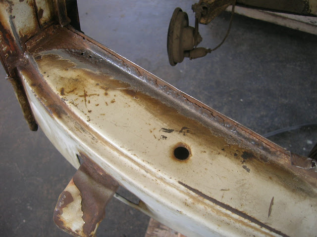

PostPosted: Mon Aug 05, 2013 2:19 pm    Post subject: Reply with quote
After dropping the steering column out, I decided to attack the old floor where it was spot welded to the support in the center...where the shifter and e-brake attach. I planned on wire brushing the rusty surface to make the spot welds visible and then drilling them out with a spot weld drill. Instead, I just grabbed the edges of the remaining floor (bulk had been sliced out with a cutting wheel) with vice grips, and rolled the grips until the closest spot welds just peeled away. Rust does nice things sometimes. Then I'd grab another part and roll away. Worked very nicely.

All that's left of the old floor now is the section right at the bulkhead. The plan (let's see if I stick to it, is to use the spot weld drill bit). Then all I need to move is the heat tube to have finished demolition.

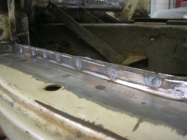

Here's a pretty full shot of the final result. You can see the remains of the spot welds. They will grind out very easily and leave more material than if I'd used the spot weld drill bit.
