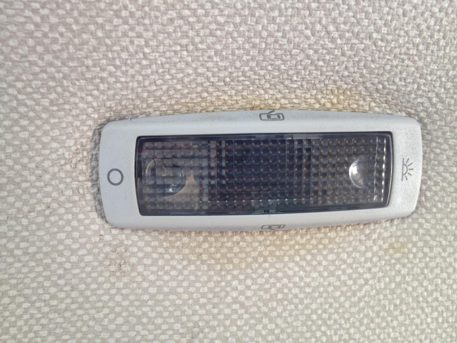

I originally installed this early MkII Jetta item, but at some point it developed a stress crack and fell apart.
I then swapped in a later (MkIII?) unit in the overhead duct--much much nicer light and placement, and has the delay feature.

MK IV dome lights. To remove them you need to push on the metal clip at the top with the O icon.
They are available in this grey and a beige color depending on interior color.

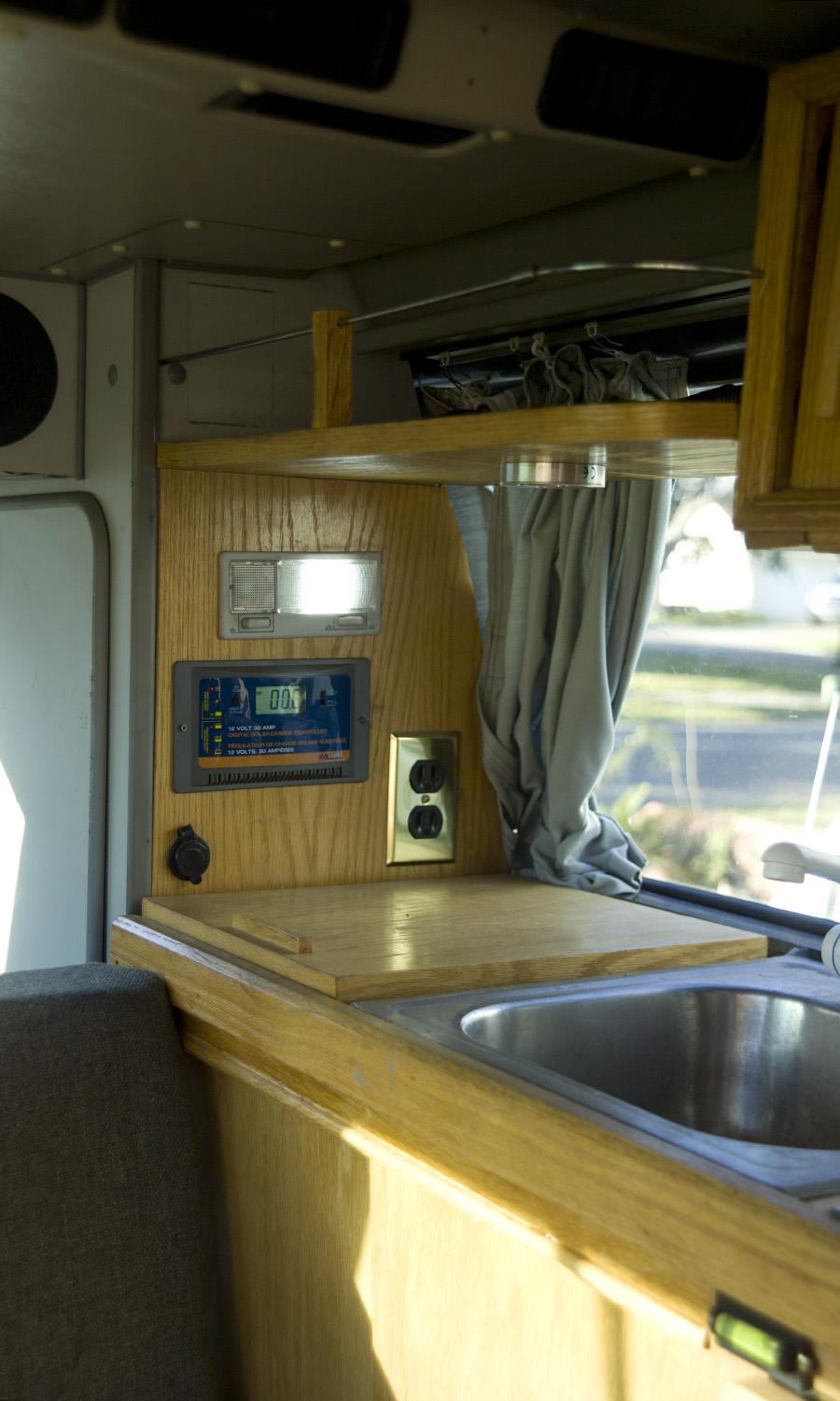

I installed four Jetta lights from 90's model I used led's for the bulb.

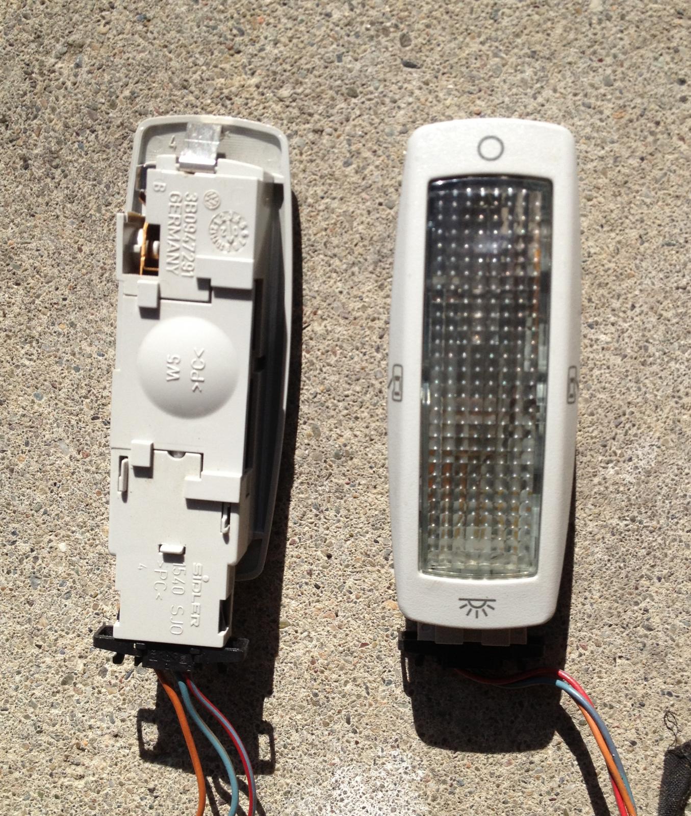

They don't dim but they are more durable than the stock clear units. I was at the junk yard earlier and I stuck this into a vanagon hardtop for the photo op while I was there.
They work well in the rear where the kids can use them and they aren't found magically broken later.
The earlier dimming jetta unit is nice to have up front.

syncrodoka wrote:
They don't dim...
...when removed from their original vehicles without all necessary hardware. Wink As an owner of a Jetta IV, I can tell you that the lights do dim on a time delay, but that function resides in the "comfort system central control module" (which is buried inside the dash).

PostPosted: Sun Jan 26, 2014 7:21 pm    Post subject: Reply with quote
The lights don't dim like the earlier units that have to just be wired up. If there is some other module and associated wiring in the vehicle that can make it dim it isn't nearly as easy or obvious to make it happen as the earlier units. Adding complexity and expense to a simple system isn't something that many are looking for. The dimming isn't a function of the light and if one wanted to do it the hard way there are any number of modern cars that have a dim delay function module that could be added.
FWIW the lights are located in the rear passenger overhead area of the donor cars.

rc3 wrote:
Digging your custom cabinet modifications and extensions. Got a build-thread on that?
Yes, I know that; I was merely making a clarification of your post. The lights do, in fact, dim; but, as I said, that function resides in the comfort control module (which, admittedly, would be a bear to find a place for in a Vanagon, let alone wire up), not in the light itself. The light housing alone is a nice upgrade without the dimming feature. I was merely providing info in case anyone out there should want to attempt a full transplant.
