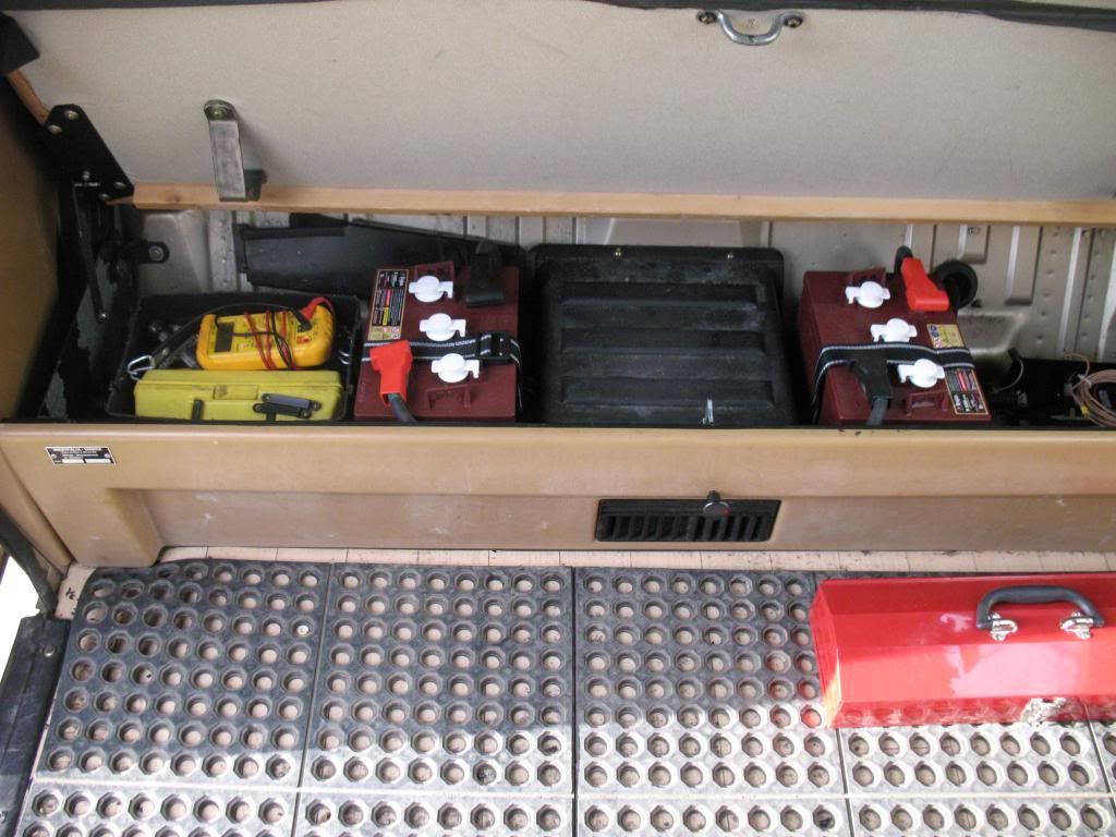

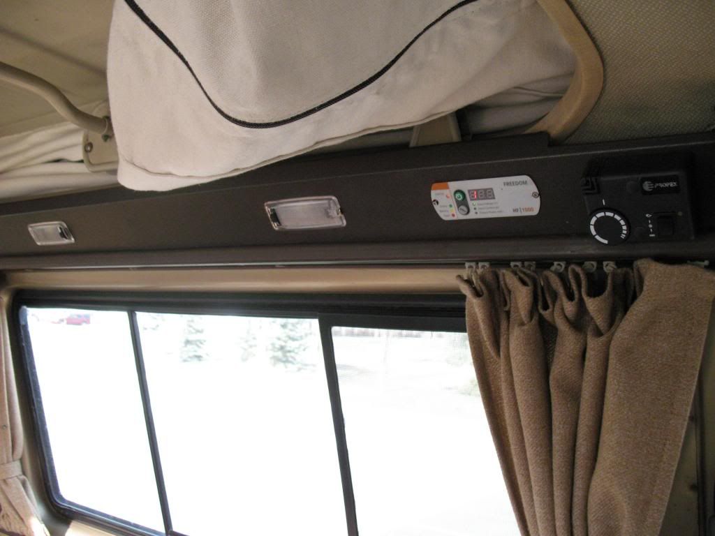

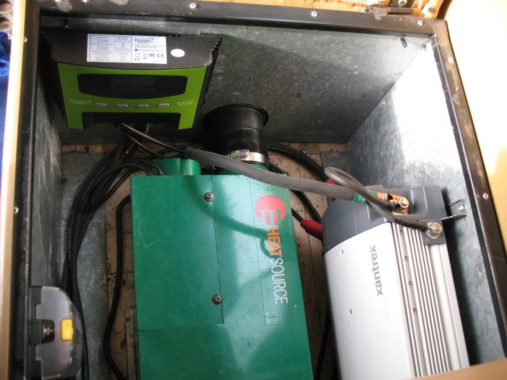

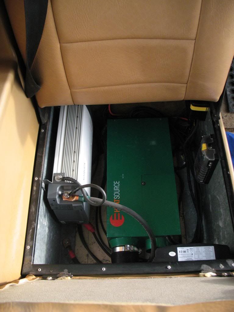

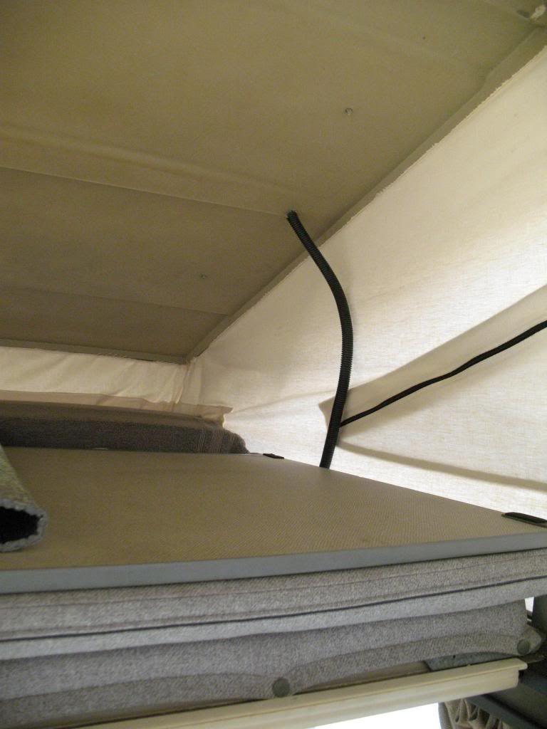

Nice install Ryecatcher.
Here is mine. I chickened out and used nuts and bolts along with the velcro. Since I drilled holes for the panel, I figured drilling for the wires was inline. I used two Trojans under the seat, they are a tight fit! I've tried to make use of the space under the weekender seat by mounting the inverter/charger, charge controller, breaker, panel, auto charging relay and Propex. It still leaves room for my tool box and and other knick knacks. So far I'm happy.
Smile
