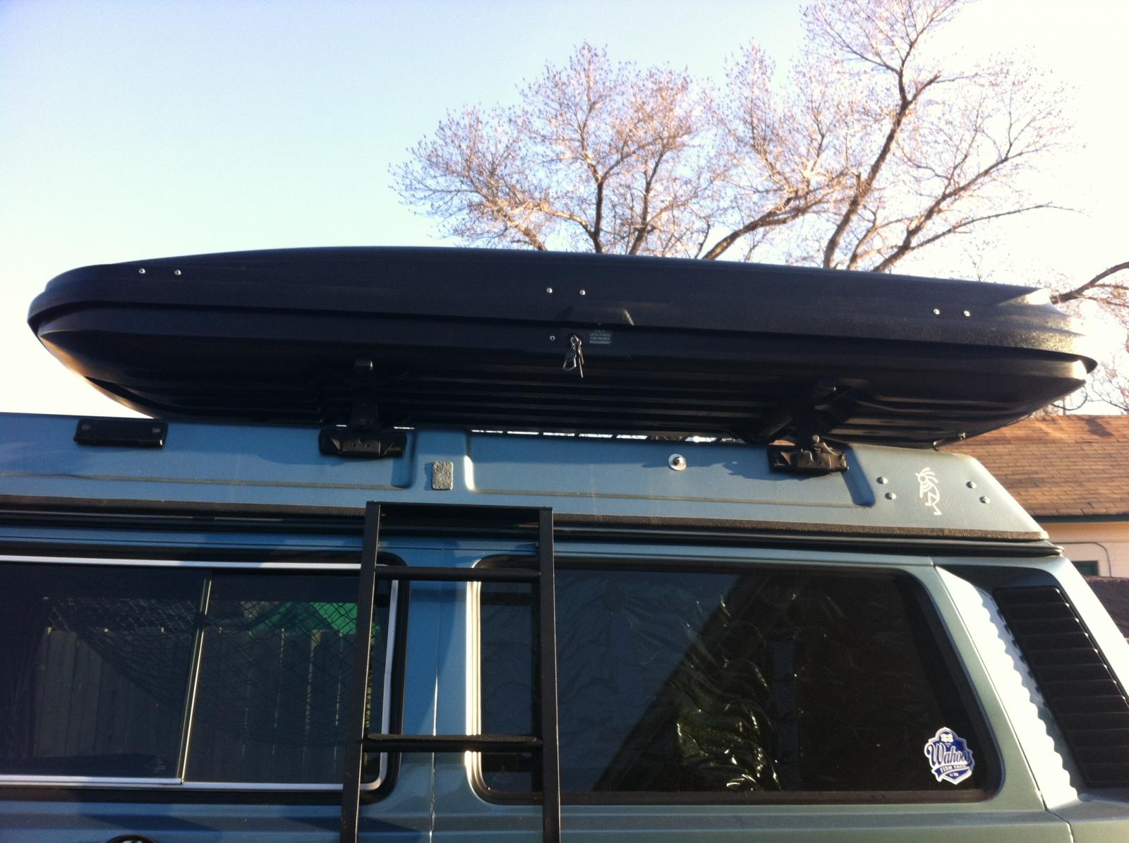

I too wanted to add a small panel on top of the Westy.
Since I carry a kayak on my rack and have a Rocket Box on the other side I really needed to find a solution without taking my storage spot above the cab.
So I went this route and attached it to the top of the Thule Box. It is only 28W but during the day it can put a few AH into the house bank. It will also run my ARB Fridge/Freezer during the day.
http://www.selectsolar.co.uk/prod/404/powerfilm-r28-28w-rollable-solar-panel
I have a portable that I use when camping. But this way even when I am just parked hiking or biking, and do not want to set out the portable, I still have something going back into the batteries. Leaving your solar panel out on the ground might lead to someone borrowing it for a while? Shocked
It is pretty stealth up there on the Thule! Cool

Here's my rig, charging on the beach this past weekend:
We basically ran the stereo, lights, Truckfridge on its highest setting, phone chargers, iPad, wifi, LED christmas lights, ham radios, and anything else we wanted for three days with no fear of depleting the 165ah house battery bank. The bank was recharged each day with ambient sunlight. In this photo the van tailgate is pointing south. We probably could have oriented the panel for more efficiency, but it wasn't necessary.
The panel mount is solid and doesn't rattle. It appears permanently installed to the casual observer, but can be removed with a little effort and knowledge.
