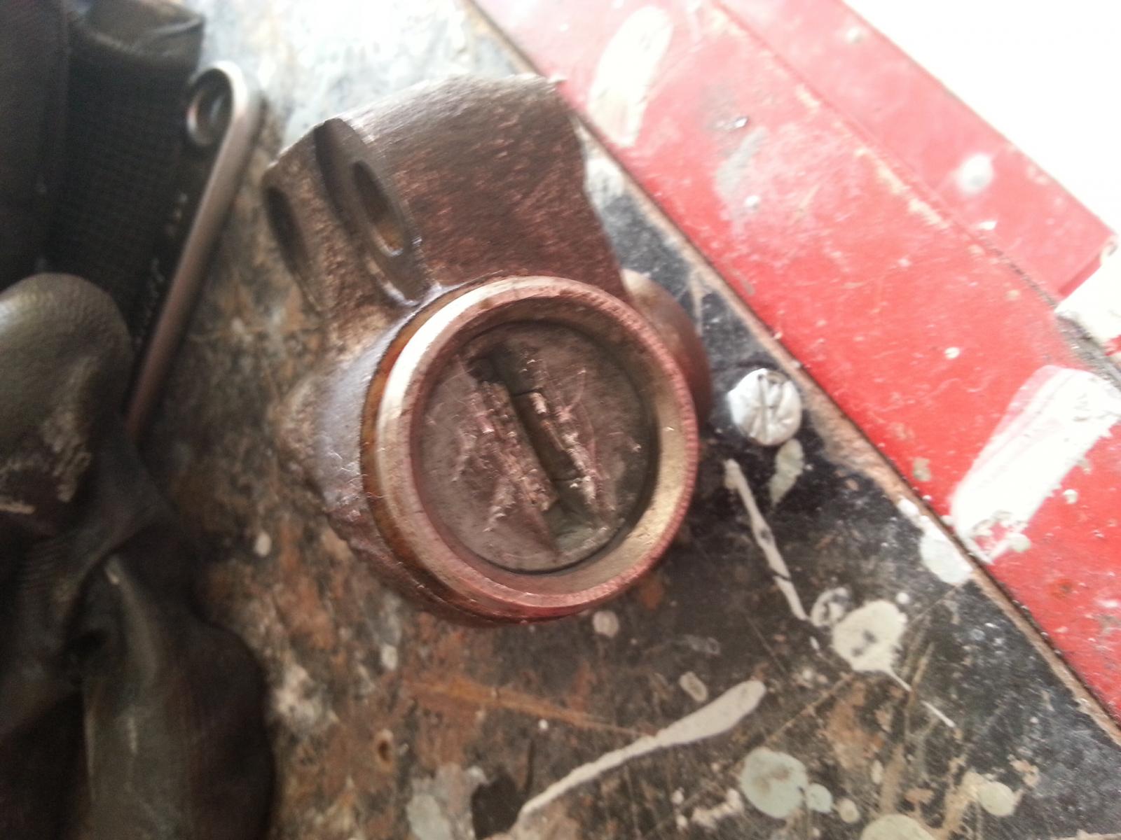

So, on todays agenda was the scary as hell brakes. Something was seriously wrong with the front brakes.
I lifted her up and put her on jack stands. I spun the RF wheel and the bearings felt ok but there was no drag from the brakes at all. I pulled it down. Everything looked good. No leaks, good brake pads, drums looked good, no leaking wheel cylinders.
I went to spin the LF wheel. Oh boy.. Frozen solid. Wouldn't move. I took the wheel off it. The drum was frozen solid. I cracked the brake bleeder to see if they would release since it had the original, 44 year old rubber brake lines. No luck. I was able to get inside through the adjustment hole that was luckily simi lined up to the star and back the brakes off and the drum came off. Again, everything looked ok in there as well. The wheel cylinders looked fairly new as well. I was suspicious of the rubber brake hose so I went and bought a new one. I installed it, bleed it and the brakes where frozen again. Damn.. I fought to get the drum off. I then had my son gently push the brakes down and one wheel cylinder moved and the other didn't. I took it off. The piston was frozen solid. I hooked up 110psi to my air gun, pointed it away from me and it wouldn't budge. Here's the offending POS.

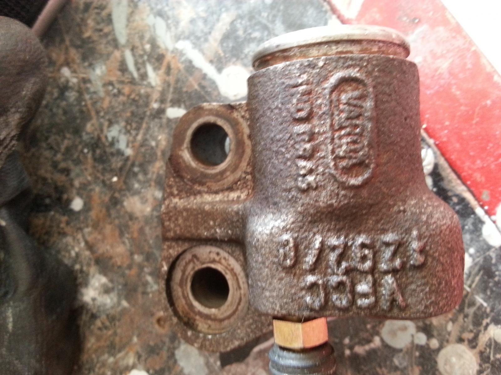

I've never had much luck with Brazil parts, Varga in particular. This piston is frozen solid in there. Shocked
Well, tomorrow will find me going to PU a new upper wheel cylinder. The owner had a new lower one already. I wonder why.. Hum..

X2 on the Varga parts!

As far as Varga I've had absolutely no problems or concerns.

Well-maintained Varga parts will probably outlast neglected German VW parts.

As far as the Varga parts, I'm hoping they will work out ok. This cylinder that was stuck/frozen didn't appear to be that old, so that was odd. I took it to the parts place to insure I got the right one. He said he also likes Varga, runs them on his bus and thought this one must of rusted up inside. The fluid didn't look too bad when I bleed out the lines. I had some Varga brake parts in my 69 bug and the wheel cylinders and master cylinders both started leaking pretty bad. These parts only had a few thousand miles on them though they were 10 years old. I had flushed the fluid one time during those 10 years but perhaps that wasn't frequent enough. I should probably do it every two years. Embarassed

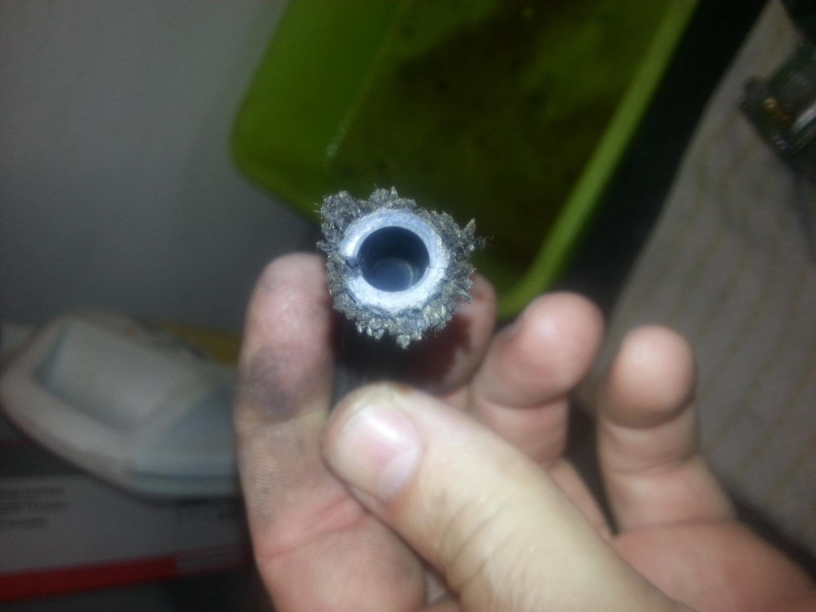

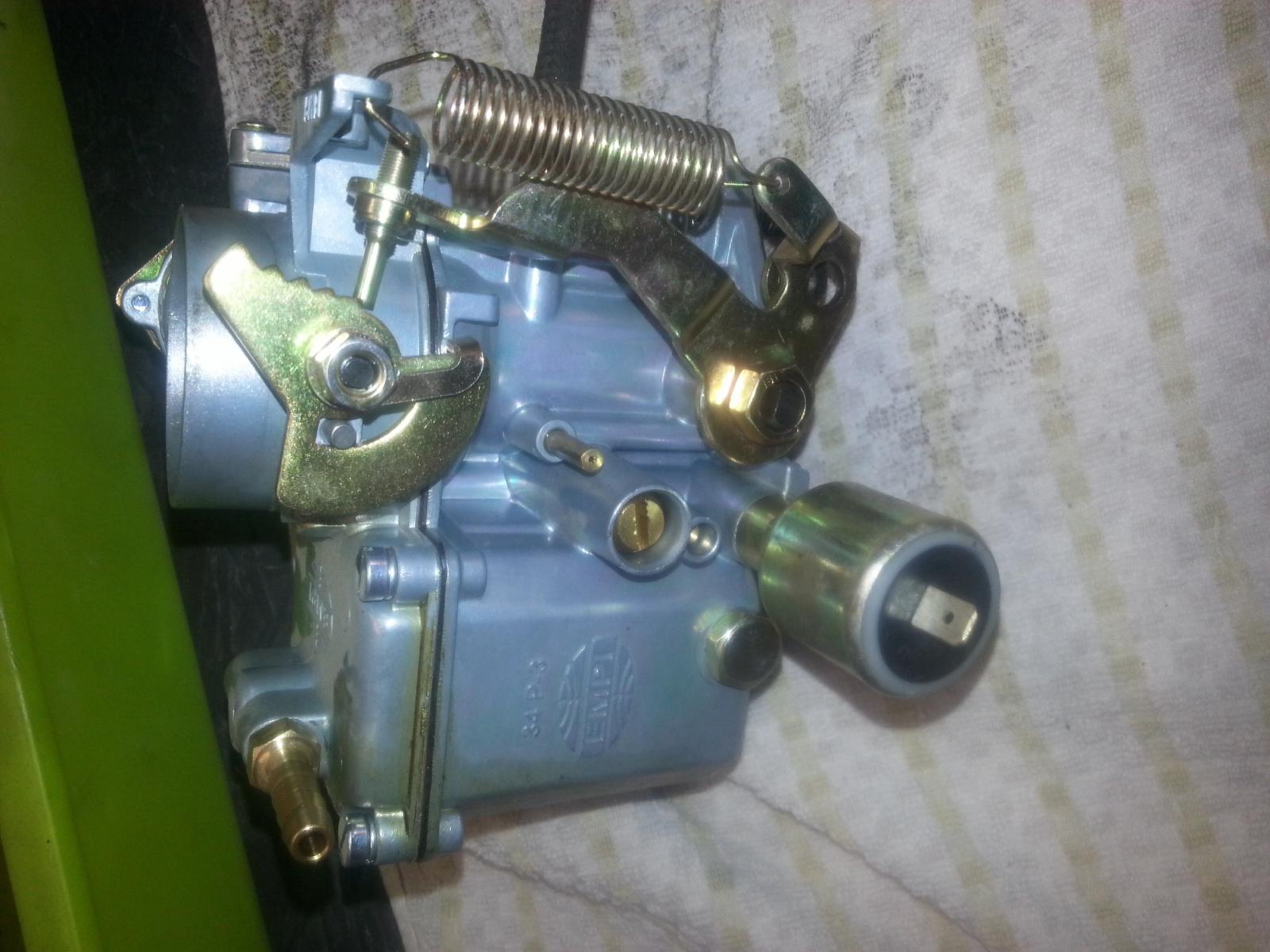

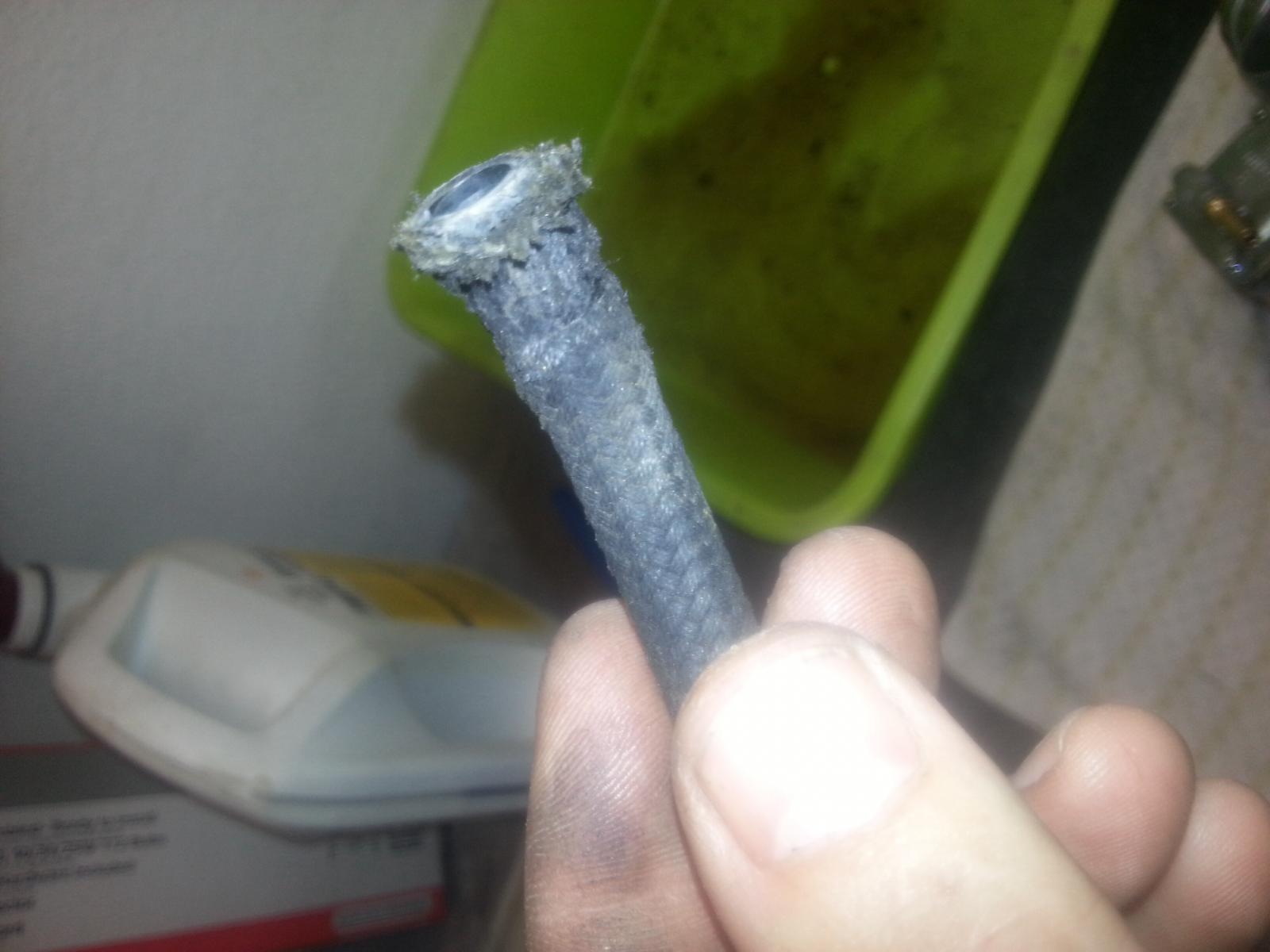

Alright, so, todays adventures in bus system discoveries was on the engine. It was said to have been rebuilt roughly 3k miles ago. It was built as a 1776, is full flowed w/an external oil filter and oil cooler that stuffed up near the drivers side rear bumper bracket.
When I drove the bus a second time yesterday, it was running like crap. It was stalling, not idling well. I decided to turn right around and put it in the garage before having to deal w/a potential break down.
This am, I pulled the valve covers off and adjusted the valves. Whoever built the engine didn't put the distributor drive in the right place. The rotor points 180 from where it should. It has an 009 distributor w/an electronic module. The valve adjustments were all over the place. Most were tight, especially the exhausts. Some were 4 thousandths. I should of put a magnet on the push rods to see if they were chromoly but forgot. I was wondering if they were since most were tight. I decided to adjust them to 4 thousandths and call the builder of the engine as I have the receipt. I'm curious as to what cam is in it too.
I then took off the brand new EMPI carb for closer inspection.
I took it apart to check it out and see how it was jetted.
Overall, I was pleasantly surprised by the quality of it. Someone changed the fuel insert nipple to a screwed in barb style. It only had a minor amount of dirt/crap on the bottom of the fuel bowl. I checked the jet sizes and saw it had a 127.5 main, 55 idle, 70 air correction and a 26 venturi. It wasn't very tight on the manifold and I changed the gaskets since I had some. I blew the jets out and re-installed it. I changed the fuel lines since they were old, dry and smelled.
I guess hose like this is why we see bus/bugs burning on the side of the road.

Its an SVDA by Kuhltek. I did some research on these 034's and they all appear to be made in China. I got a price from Antonio who sells the Mexican parts but it was going to be $275 shipped to me. I didn't feel it at that cost! I'll post up how this distributor does when I install it tomorrow. I hope it alleviates the off idle hesitation/flat spot.

PostPosted: Fri Jun 20, 2014 5:28 pm    Post subject: Reply with quote
asiab3 wrote:
Glad you're enjoying it Very Happy
Did you lube the points rubbing block in the new distributor?
Did you time the 30* with the advance hose off?
Can you please post a pic of the part number of the distributor? Also a picture of the inside, top down with the cap off? I ask, because some of us have had great success with a 009 and 34pict3. That being said, the distributor and carb were both clean and made in Germany, so I'd like to see yours.
Oh $hit.. Shocked I didn't set the timing with the hose off and blocked! DOH! I guess my thinking is I wanted all the timing in, vacuum and centrifugal. Oh well, won't take a minute to double check it tomorrow. Thanks for the tip! Very Happy
Which distributor are you asking for photo's of? I'm assuming the new 034? I'm surprised to hear that some are having luck running the 009 and 34-3. This thing really fell on it's face off idle. You'd have to rev up the engine when you were about to let out the clutch. The guy at the parts place said he's running that combo but has the carb running really rich. I think he said he had a 135 main jet.
