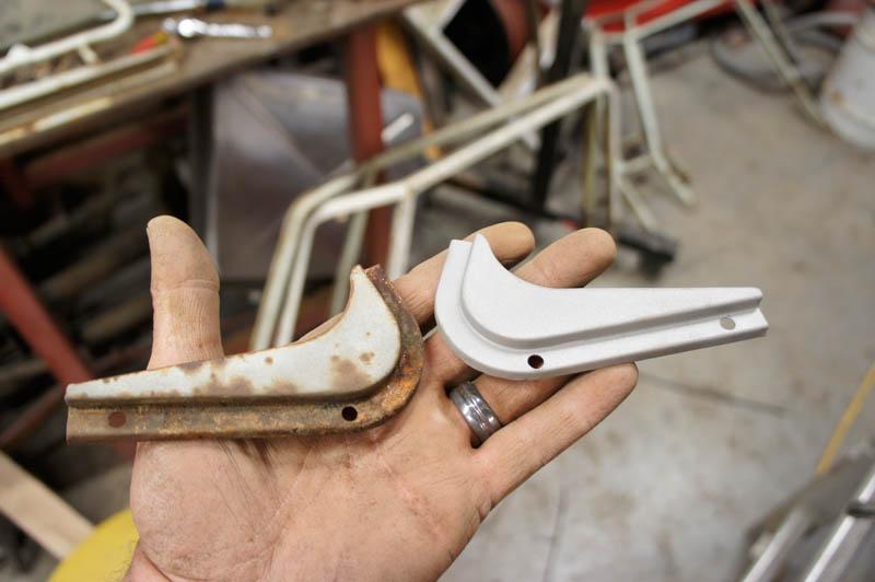

I was in the mood for some blasting so I grabbed some random parts. The shutters are already treated with phosphoric acid. That will keep them from rusting until I get them all etch primed.
My '59 came with this thicker style so I will keep them.

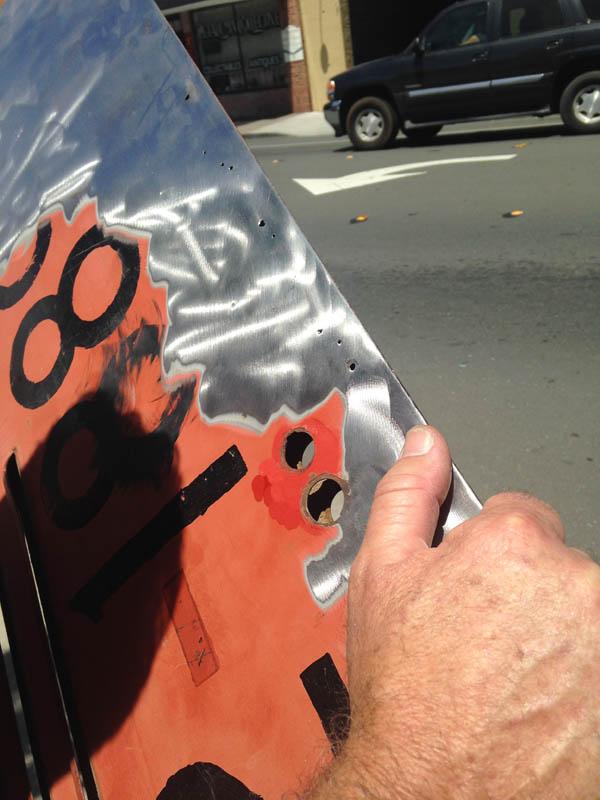

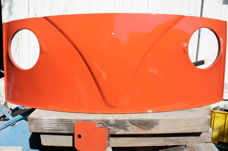

I had read that this was going to be a challenge. Red is an extremely difficult color to get right. Our eyes are very sensitive to slight variations. Add to that the variations from the factory over the years and differing ages and oxidation. I am working with my second paint mixer. The first one did not work out. This new guy is very interested in getting it right. We spent three hours on this today. Our first attempts were all to milky then they went too much magenta. I don't want a lipstick pink single cab! It is worth getting it right as this paint is very expensive. My single cab needs at least two gallons.
The treasure chest door and gas flap are from different vehicles from swap meets. The gas flap was under three other colors and polished up ok. The area under the treasure chest lock still had the original gloss and the deepest color so we chose to match to that. We started with a Nason chip and ended way out in custom land.
The orange spot was the best match from the first guy. This is just finger painting. The bubbled area above my thumb is from the pint I will spray out this weekend. He won't give me the formula until I buy my first gallon. I will share it with you if it turns out to my liking.

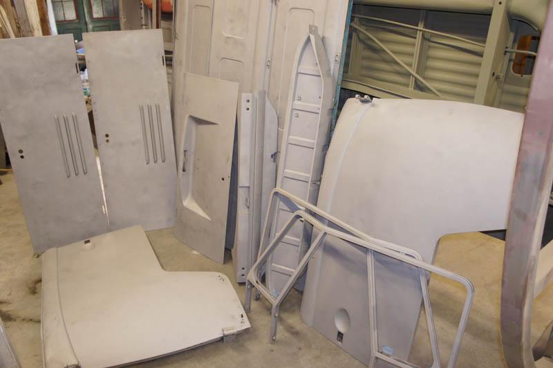

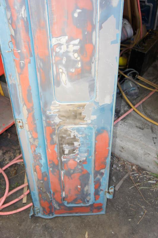

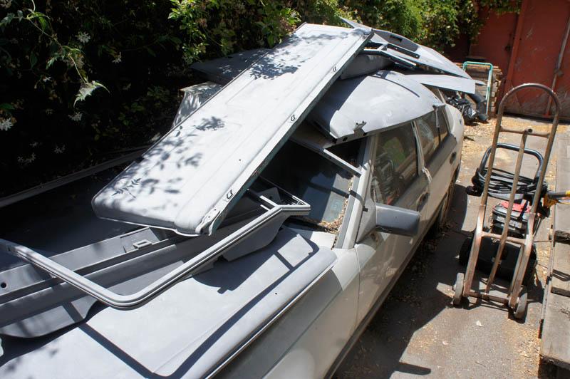

No slacking! I have been working hard. While waiting for the paint chip from cru62 to verify the sealing wax red color formula, I have been doing the rest of the blasting. I am now done with all the large parts blasting. I have cleaned the garage. What a mess! Any small parts blasting will be in the cabinet.
Scrapped off some layers with a razor blade. It was thick and came off in sheets.
Used a disk sander to remove most paint. Way faster than just blasting alone.
Blasted the rest off. This is a rare picture as that much bare metal is not left lying around for long.
The Mercedes is being used as a drying rack for the acid washed parts.
The gates will be disassembled and worked now that they are clean.

PostPosted: Wed Jul 02, 2014 5:49 pm    Post subject: sealing Wax Red L53 finding a good match Reply with quote
I sprayed out the test pint of SWR on an unused scrap left over from the nose skin replacement. I will test color sanding and polishing. There is a drip so I can experiment with sanding and polishing that out to see if there is a color shift. Gas flap is original SWR. I will post another photo when other original samples arrive in the mail.
