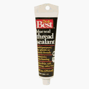

PostPosted: Fri Jul 04, 2014 8:31 am    Post subject: Reply with quote
Teflon tape is a valid solution... However the bad part is getting onto fitting and getting fitting seated without shredding it....
Yellow or white tape same formula chemically so either will do....
How about plain old hardware store thread sealant... Recommended for almost any type of liquid or gaseous fuels including "gasoline"...
Pretty much thrown my rolls of Teflon tape in trash after finding this product (by brand) ...
Dale

This stuff is the best. It's on TV so it must be awesome. I use it on the old cracked rubber fuel lines over my exhaust.
