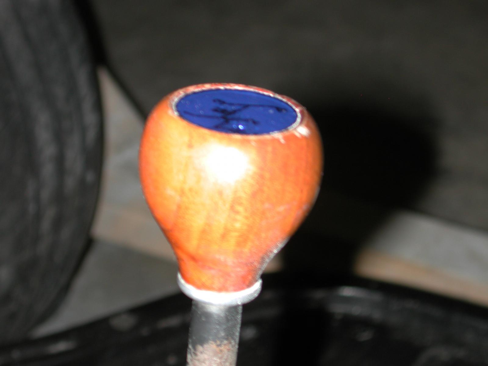

Put a shift print out and piece of blue glass in my wood shift knob. Original center emblem was missing.

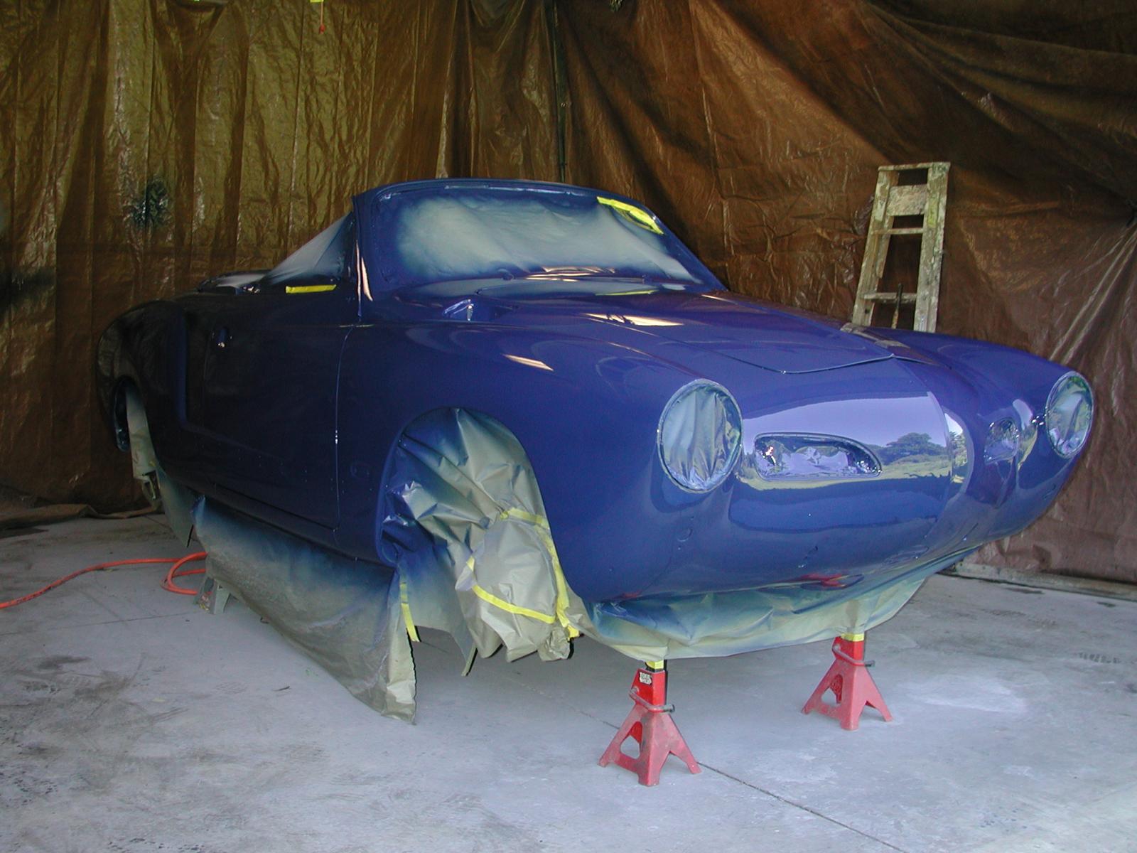

Well I painted it.

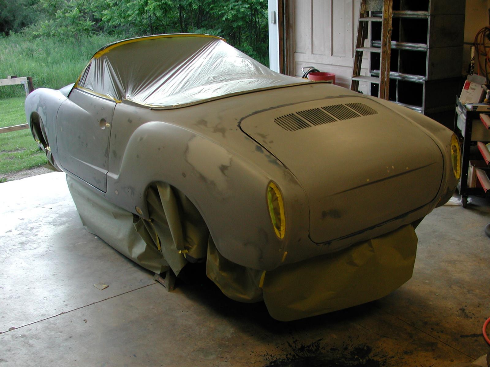

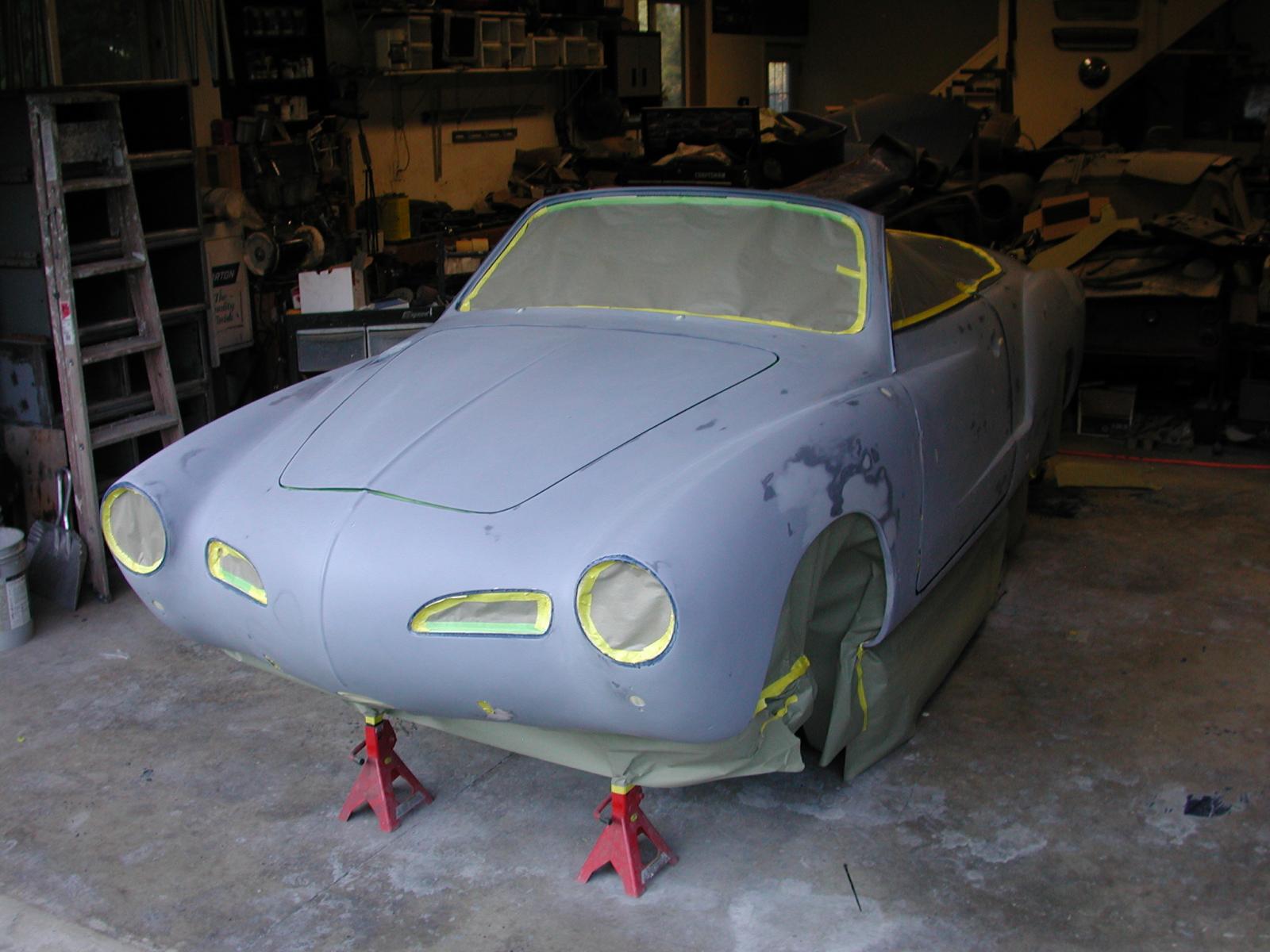

It was a decent morning to paint. A good dew to keep the dust down. Little wind. Not too many bugs. But of course a little of all that. Plus there is my tendency to run the clear which I did. but not till the second coat. So, two coats of color and 4 coats of clear which should give me enough to sand my runs and the dirt, bugs and orange peel out. I hope.
Also I painted over a couple of minor dents, so the good news is I don't have to worry about putting the 1st dent in it. Smile

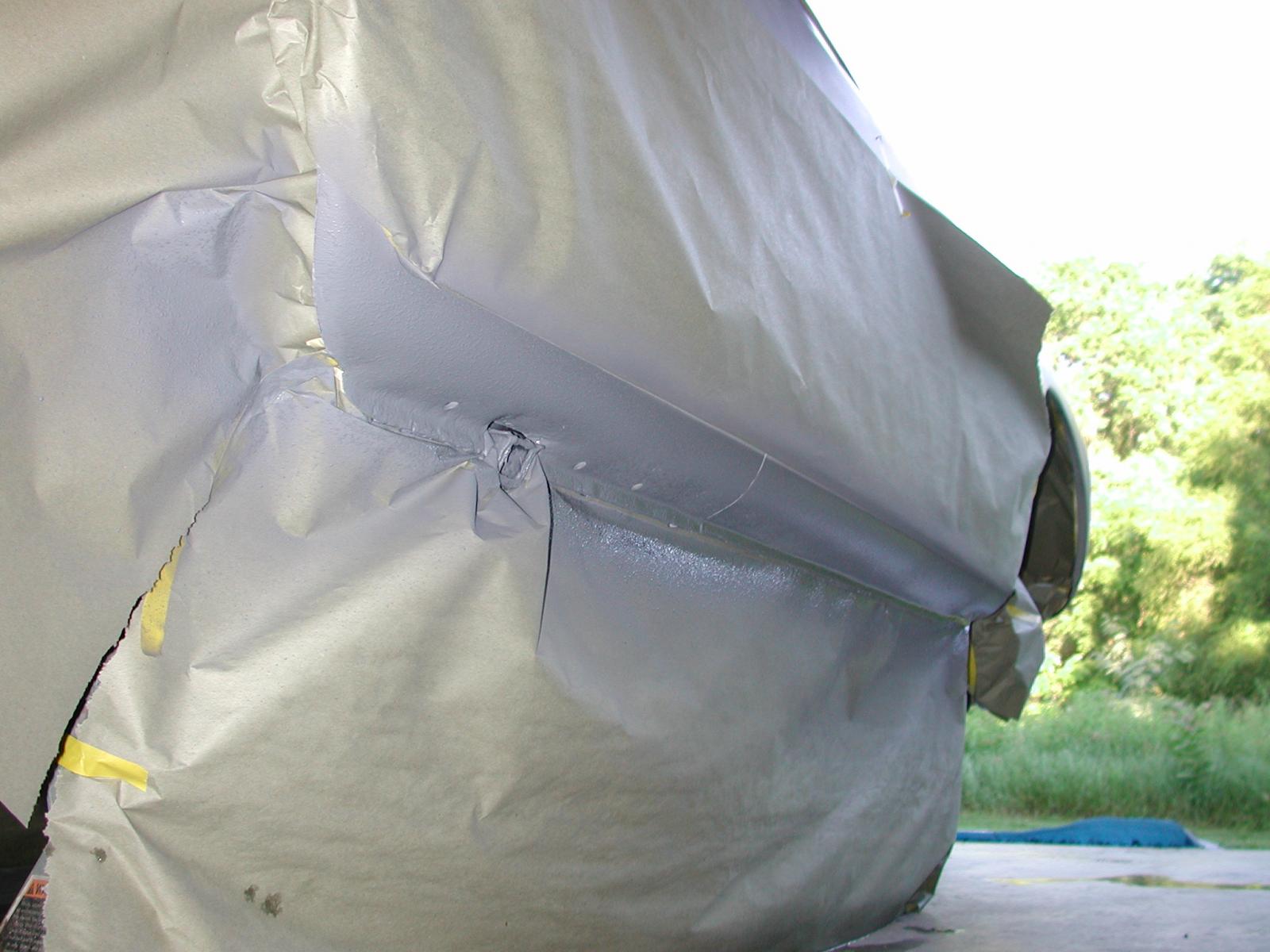

Rockguard (40% of the roads in my county are dirt roads, and sometimes I get stuck going on one.)

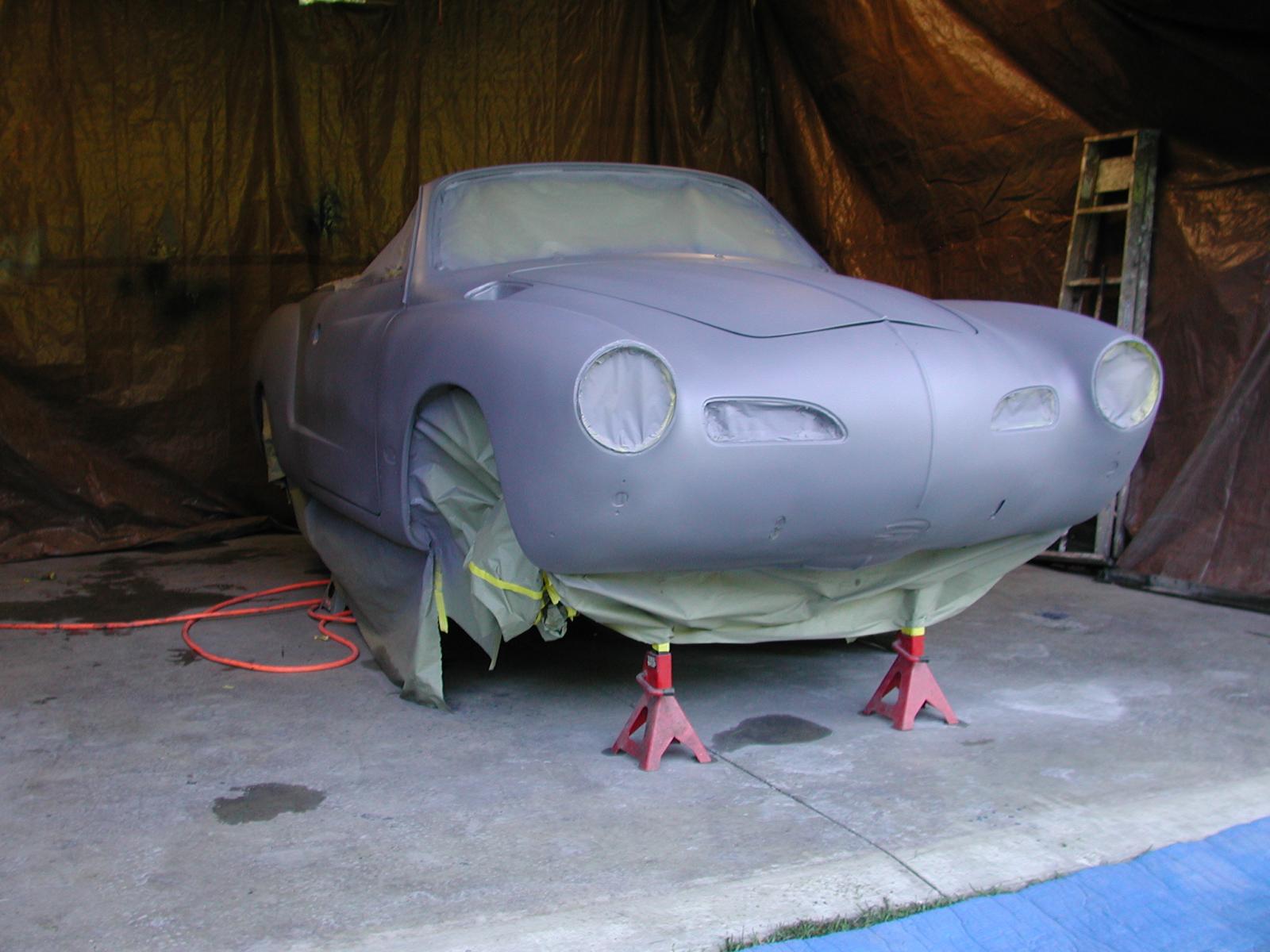

Epoxy sealer

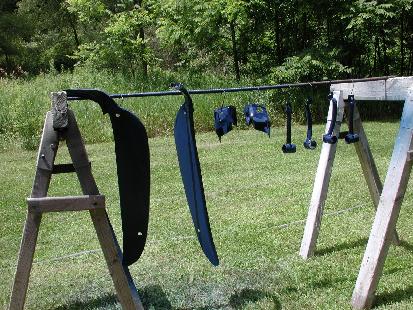

After 1st coat of color (notice I wet the floors a little to keep the dust down)

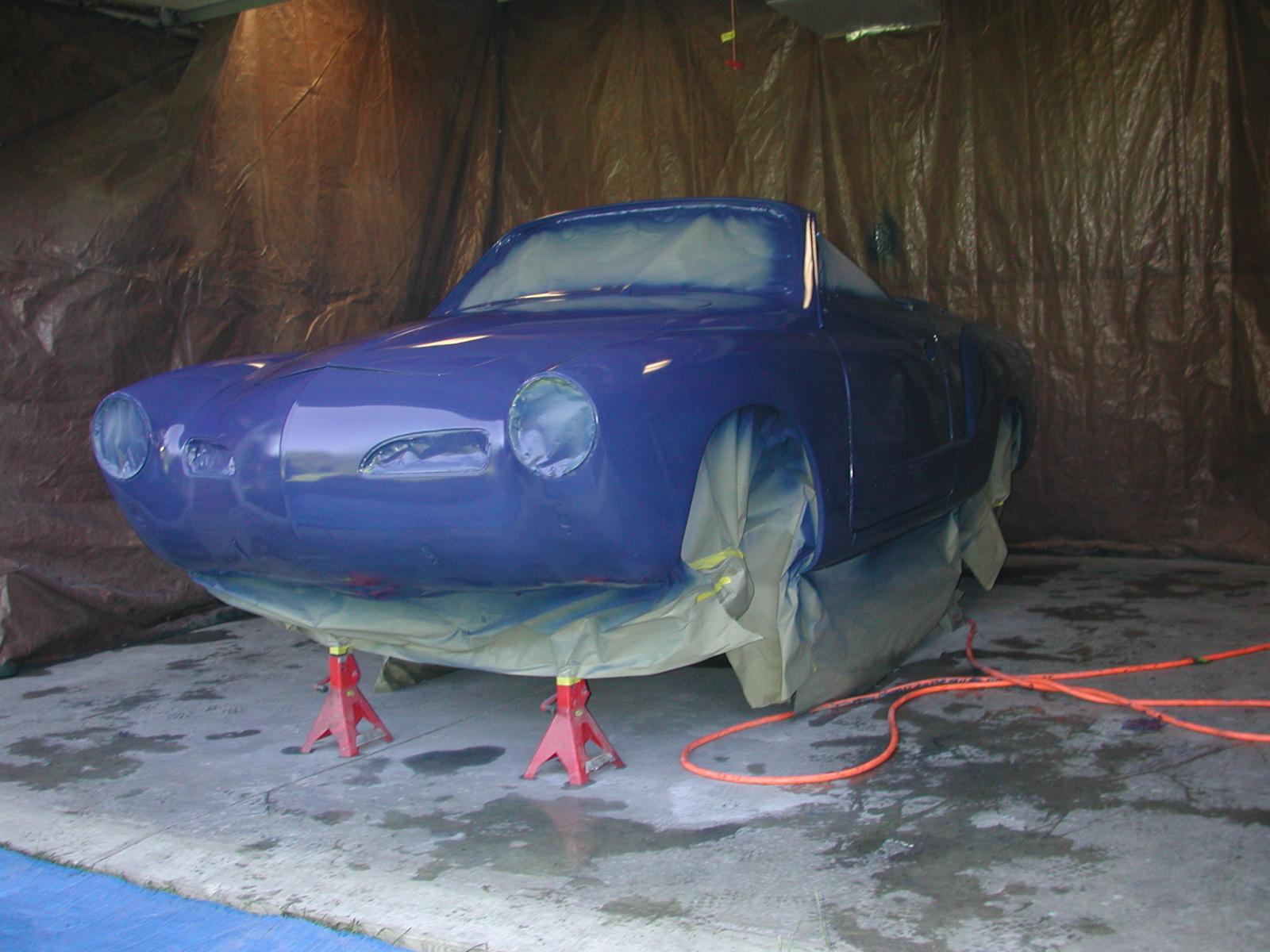

After 4 coats of clear. and some decent sized runs.

PostPosted: Thu Jul 10, 2014 8:12 am    Post subject: Reply with quote
The color is almost as beautiful as it is shiny!
Lookin' good.

PostPosted: Thu Jul 10, 2014 11:07 am    Post subject: Reply with quote
Doh! some of the runs really took off, and a couple of sags developed. I guess I'm used to just putting 2 coats of clear on, and I'm a bit rusty, and the lighting conditions suck when I put the tarps up. Excuses. excuses. I'll be a challenge to get these out without having to reclear. We'll see.
I had an emergency afternoon painting session after having to mix all of the color I had left to paint. It was either prep and paint all this extra stuff or buy more paint. Soooooooo.

I wanted a single stage with clear over it. Non-metallic, solid colors look best to me on classic cars. I pretty much limited my choices to the Kirker line of single stages and picked one. It's basically a color both me and the wife can live with.
The complements are nice. But in reality it's going to take quite a bit of doing to get this paint job looking the way it's supposed to. The dirt nibs will come out easy but the runs, jeeze. I pretty sure the clear picked up some of the color and ran that too. If that is too bad and too visible after taking the runs out then I will have to spot color and reclear.
But I love doing everything twice apparently.

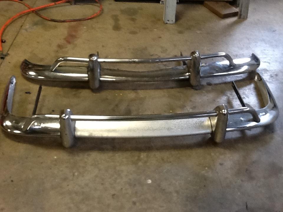

Question: How do you save money?
Answer: Use the crappy bumpers you have.
The middle section of the rear was so pitted that I blasted it and put silver paint on it. Almost every section has problems, so it is what it is. Here are some pics after taking apart, tapping and drilling broken bolts ,blasting and painting the backsides, and reassembling.
I put rockguard on before painting a lot of the inside of the car but it was still a bit tinny so I got som 50 mill GTMAT and corrected the problem. I like that it isn't printed on the outside. I used about 35 square feet. I taped the seams with aluminum duct tape. They have 80 mill and 110 mill too. Diminishing returns and all. This didn't cost too much.
