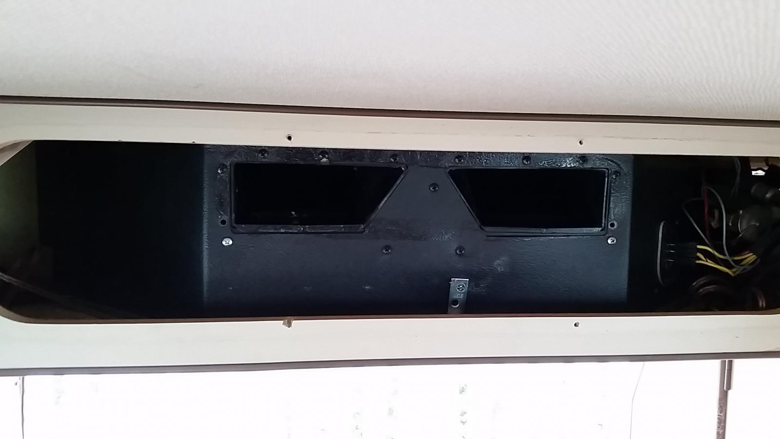

I recently ran some new speaker wire to the rear deck. Had to drop the headliner, and discovered some sunflower seeds and mouse poop. No big surprise, really. Well- I was investigating a rattling AC fan in the rear deck, and in the process, stirred up an old mouse nest. It looked like a freakin' ticker-tape parade inside the van. The fan was blowing stuff out like a wood chipper. So- I've vacuumed, picked out a bunch of stuff (tissue paper, insulation, string, etc.) with my handy giant tweezers, but there's still more in there. Is there an easy way to remove the housing around the squirrel cage fan?

You are probably going to have to drop the whole thing to get it suitably cleaned out. I did it last fall and it was a fun afternoon. The Bentley has step-by-step instructions on how to do it.

Thanks- why compressed n2? I know it's a bit of a hack, but I'm contemplating using a dremel to cut an access door in the plastic plenum. All the debris is on one side- I really don't want to drop the whole unit.
Terry Kay
Banned
Joined: June 22, 2003
Posts: 13331
Terry Kay is offline
PostPosted: Mon Jul 14, 2014 5:53 am    Post subject: Reply with quote
One question;
If you know it's a hack job, why even do it?
You'll never get all of the garbage outa there with just an inspection port.
Drop the evaporator portion of the unit, and blow it out good.
I'd skip the nitrogen and just use compressed air--work just as good.
Be sure to blow out the coils of the evaporator good--along with the vanes of the fans, before you button it back up---
T.K.

furrylittleotter
Joined: May 19, 2008
Posts: 1506
Location: West Seattle
furrylittleotter is offline
PostPosted: Mon Jul 14, 2014 6:58 am    Post subject: Reply with quote
I mentioned the nitrogen because of the higher pressures the tank and regulator allow. My tanks come with about 2000 psi and I regularly test ac systems with 400 psi. Most air compressors do not run that kind of pressure and are not nearly "just as good" at dislodging foreign material from air conditioning systems.
We bore holes in ducts for air testing all the time, just make sure you aren't boring into a drain pan, hose, wire, or coil and put a plug in it when you are done.
I meant to be suggestive. If you would rather spend a day dropping a brittle old Van ac, knock yourself out. My suggestion would take less than a minute.

Terry Kay
Banned
Posts: 13331
PostPosted: Mon Jul 14, 2014 10:30 am    Post subject: Reply with quote
To bring a little more light into this exersize, I know full well that just trying to blow the mouse crap outa that evaporator box may not get it all.
But OK , just for the sake of conversation here, lets say it does, & from any pressure supply you've got.
But wait a mimute----
There just happens to be another common problem up in that cabinet which you slid right past.
How about that condensation evaporative foam that covers the evaporator that's plugging up the fins on the evaporator?
You can huff & puff till you blow the house down externally, and you'll never get all of that out ---no way Jose from the outside.
Drop the box, get the rat shit outa there, clean up the old broken up foam off of the evaporator coils, & you'll more than likely find that your AC unit will be blowing more cold air forward than it ever has before.
The foam rubber issue is a known AC problem and should
be addressed.
T.K.
