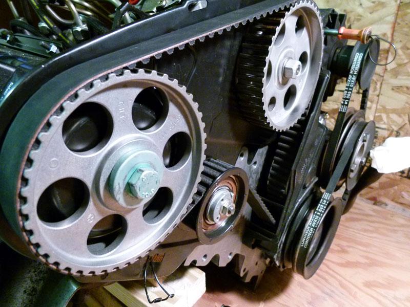

To the_bard: just to clarify, NONE of your belts should follow the path of that shown in the photo of the AAZ 1.9 above! As Gizmoman says, his AAZ is pretty seriously modified and uses a completely different belt arrangement. You should indeed use the stock Vanagon diesel V-belt setup; besides ensuring the proper rotational speeds for water pump and alternator, the stock setup also has the added advantage that the primary drive belt contacts about 50% of the water pump pulley circumference, for a good no-slip connection.

bugeye72, all years of the Vanagon diesel use the same pulley setup. For reference, here's what the bone stock original 1983 1.6NA "CS" Vanagon diesel looks like, in all its sooty glory, with the pulley end clearly visible. The crank pulley drives the water pump, which in turn drives the alternator. The center, water pump pulley is the one requiring adjustment using the integrated shims.
I can't say whether a Jetta diesel would use one belt or two. Every *gasoline* VW car I've owned (nearly identical engine layout to the Vanagon diesel) has used one common belt to drive both water pump and alternator, similar to Gizmoman's setup above. As have most other cars prior to the widespread use of modern serpentine belts.
But as Gnarlodious points out, it's possible VW felt the Vanagon's rear-engine design warranted a more secure water-pump drive, hence the dedicated belt. Since this would NOT be the case on a front-engined Jetta, maybe they used a single-belt arrangement? Only speculating ...

The crank pulley, like the water pump pulley, is DOUBLE, with TWO grooves, though the innermost groove is unused in the stock configuration. The WP belt runs in the outermost groove, as can be seen in the identical 1.9NA pulley setup.
The inner groove is *close* to being aligned with the WP inner groove and the ALT pulley groove. It's possible that a previous owner found the correct belt setup to be too fiddly — as previously mentioned Wink — and decided to instead cobble together a much longer single belt somewhat similar to Gizmoman's but WITHOUT his proper alignment.
This misaligned belt setup may work for awhile, but would likely prematurely wear the V-belt, leading to a cooling failure, possibly catastrophic in a rear-engined Vanagon.
The proper belts should be installed on the correct pulleys.
