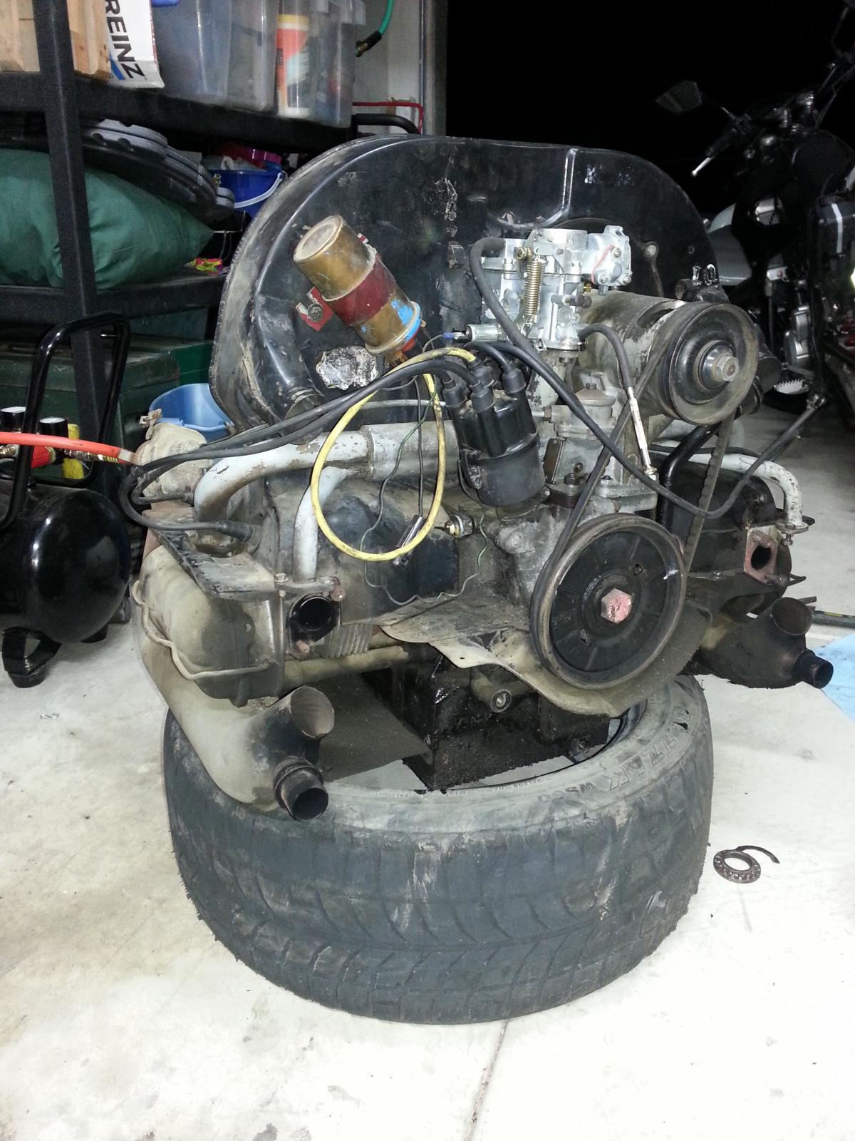

I have a single port 1600 (70 Bay). I got it with a new carb, I am unaware of the brand. It is running rich so while the motor is out I want to re jet it.
My buddy is familiar with Carbs and will jet it for me but he is making me do the foot work.
First: I am having a very hard time finding JUST the jet kit for my carb on my motor.. all I can seem to find is whole carbs.
Second: Once I order said kit I'd like to know if there is a chart that exists that shows what jetting to do for my elevation (4400 feet).
Thanks for any help my eyes hurt from scrolling through numerous threads.
Here is a pic for good measure.

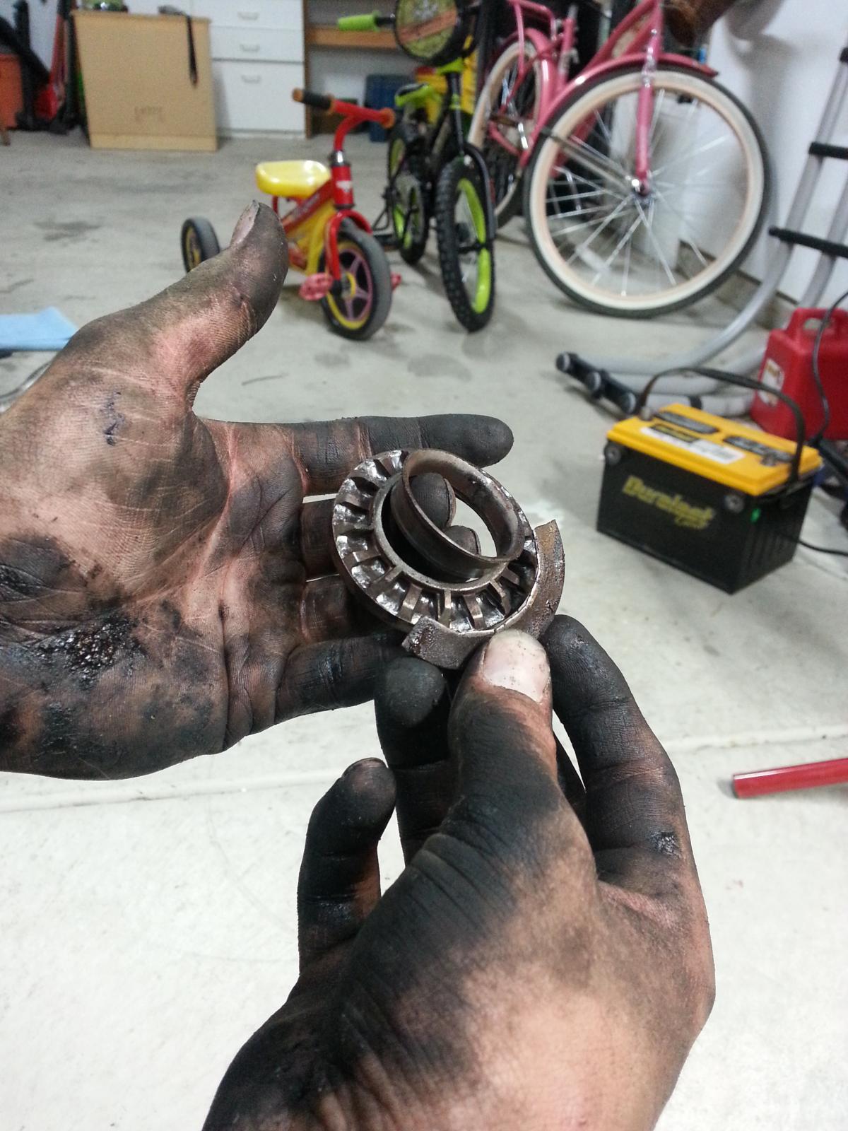

and here is what was inside my transmission bell housing..(TOB)

T/O bearings are relatively cheap (I keep telling myself) so that's not a huge loss, but a bummer.
Are you sticking to a 1600 Single Port? That carb is either a bocar or solex, doesn't matter get a refurbished one. Not new, refurb. http://volkzbitz.com/ talk to him direct and ask for some jet advice, this guy does carbs so I would trust what he has to say. If you're looking to have a growing motor, choose wisely.

Ok so ive just discovered I have an aftermarket 009 distributor. I dont believe it was the one intended for my motor ( was swapped out at some point). My Carb has vacuum ports to be connected to a vacuum assist distributor.
Carb is a Solex H30 31PICT on a 1600 single port.
Should I change the distributor and to what?

You need to know what jets are in your carb at present to know which ones you need to buy.

That is a part of the pressure plate, not the release bearing.
A common mix up on those carbs is the idle jets get switched.
The 50 should be in the "normal" spot and the 65 should be in the diagonal spot.
009s work well with the H30/31s.
I live and work on VWs @ 5500ft and don't normally re-jet Solex carbs on stock engines.

That carb you have is typically a good aftermarket one vs. say a EMPI carb. I'm running one w/my 70's bus that has a 1776 in it. I'm also running a German 009 and it works ok. I personally prefer original vacuum distributors so I bought a used 205T distributor that was on these bus's back in 1970. I have the shim kit, new fiber washers and a NOS vacuum can for it as well. I also bought a used German steel/copper vacuum line too. Both of my bone stock bugs are running their original, rebuilt distributors 205k in the 67 and 205T in the 69. They are ssoo smooth and responsive. Some love the 009 and have good luck with them as well.
As far as your jetting, most of those 30/31's have big main jets out of the box. I bet your's has a 127.5 in it. If you're running a 1600 at that elevation, you should try a 116 or 120 in it. When I lived in Denver, I had both of my main jets set to 116 and both engines like it. Now in PHX, I'm running 125's in them.
http://www.vw-resource.com/mihov_index.html
This VW site I linked to has some great information on most of the carbs and distributors we use. They also have some jetting recommendations as well.

Take a close look at the side of that carb and let us know who makes it.

brazilian solex

Ok so Current Jets installed on Carb
Idle fuel Jet - 65
Auxiliary Fuel jet- 50
Main -120
Air correction- 125
So again I am running rich, I would rather be a little rich then too lean. So where to go from here to get a good mixture as well as pass smog. Thanks!!

Those are all stock jets but I'm surprised it had only a 120 main.
Question, how do you know it's running rich? Smell? Soot on the exhaust tips? Was the carb adjusted correctly when it was running? What's the compression like? Where the valves adjusted? How are the spark plugs, cap, rotor, points, etc? If you're not sure of any of these things, I'd start there. Adjust the valves. Check the compression. If the compression is good, replace all the tune up stuff if you're not sure how old it is. Cap, rotor, points, Condenser, spark plug wires, etc.. Then adjust the carb to spec.
Is it a 1600 engine? If it is, I'd be leery to go lower than a 120 main with a 1600 in a heavy bus. As you stated, you don't want to be lean in that situation.
