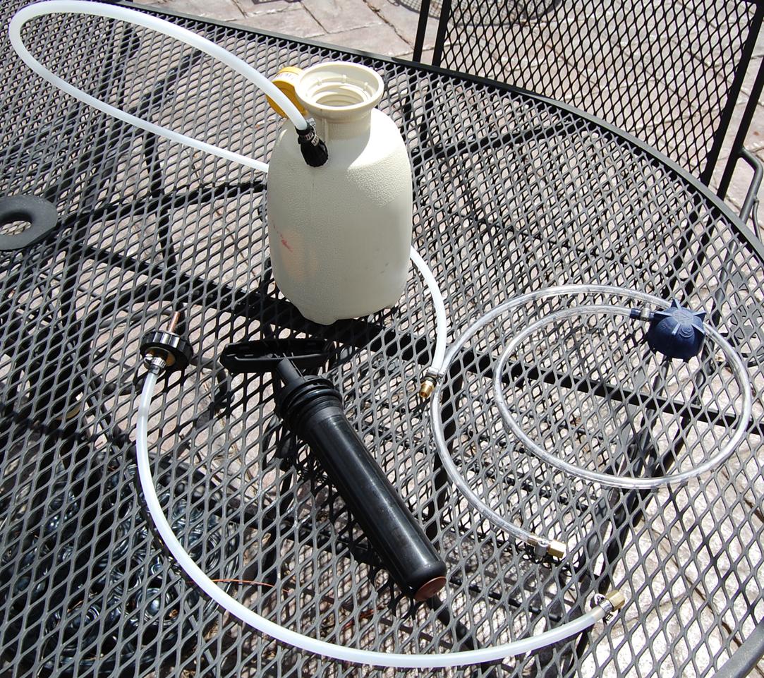

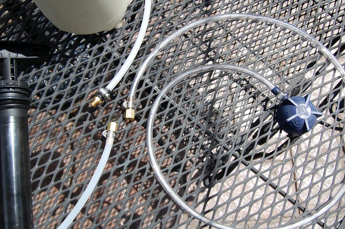

PostPosted: Tue Oct 14, 2014 3:46 pm    Post subject: Built Something Like That Myself Reply with quote
I built my own. I use the same gadget--after a rather thorough cleaning--to bleed my coolant system, and my brakes. Have a look at this:
and THIS:
and... THIS:
http://www.thesamba.com/vw/forum/viewtopic.php?p=1135773&highlight=#1135773
and...
http://www.thesamba.com/vw/forum/viewtopic.php?p=3760952
I've since replaced ALL the plastic hose with the vinyl and sealed the fitting to the pressure sprayer's tank with sealant.
Not to knock GoWesty, but this thing works pretty well on its own for more than one use. That's not a bad price, though. Mine's just useful in more ways.
