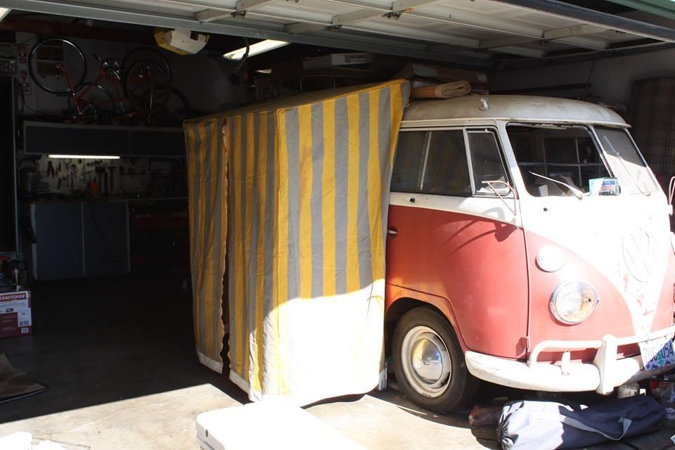

Longer ago than I care to admit, I purchased this bus from a Samba ad right after selling a hard top ’70 Westy. It was up in Portland Oregon which is a 12 hour drive but I didn’t care, it was a SO34 Westfalia! Lucky for me a friend up in Southern Oregon offered to tow the bus back to her place a little south of Eugene! We ended up having to drive to Eugene anyway because of a Uhaul screw up but it wasn’t that bad. Anyway, thanks to Susan for dragging that bus down for us.
Back at our place-
After I got it home I took a real good look at it. Man, was I missing some hard to find stuff! I didn’t know if I’d ever find all that stuff so there it sat for a LONG time while I pieced together all the missing stuff. I’m at about 85% as far as having all the stuff it should have, but it’s better than the 45% I was at when I bought it!

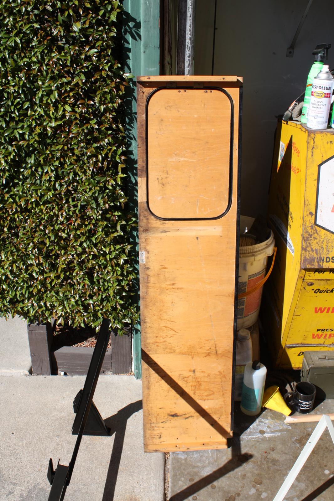

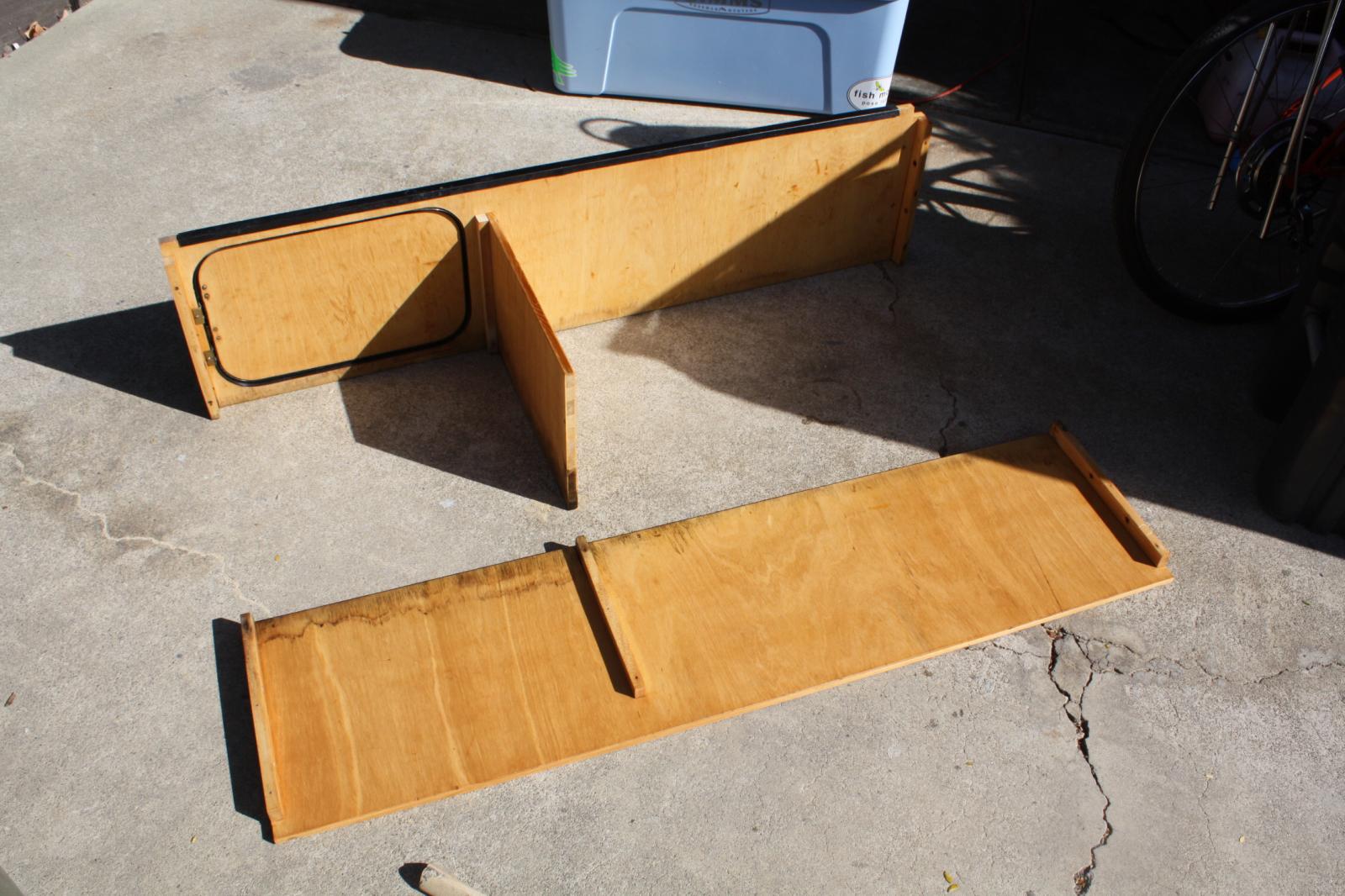

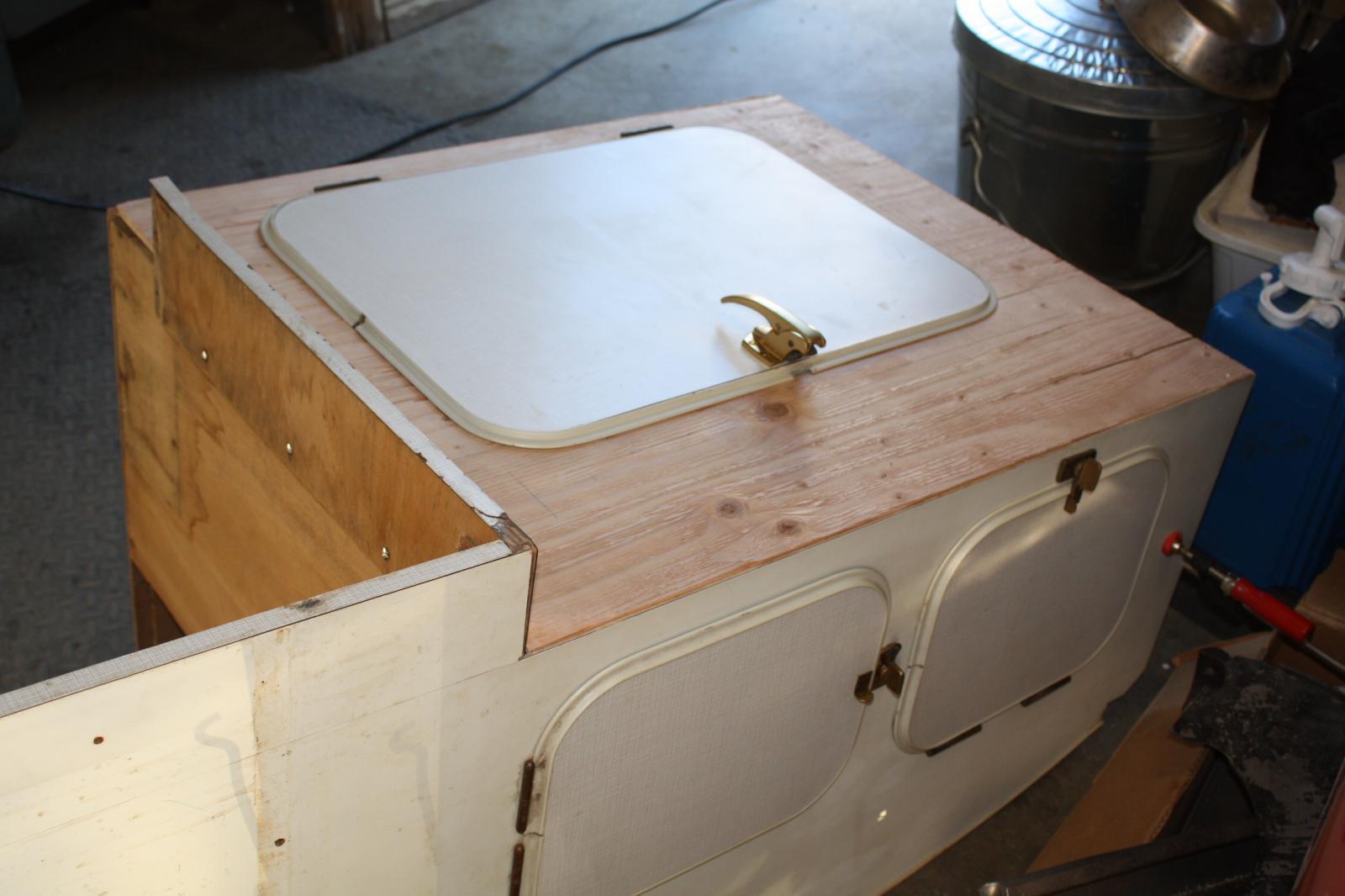

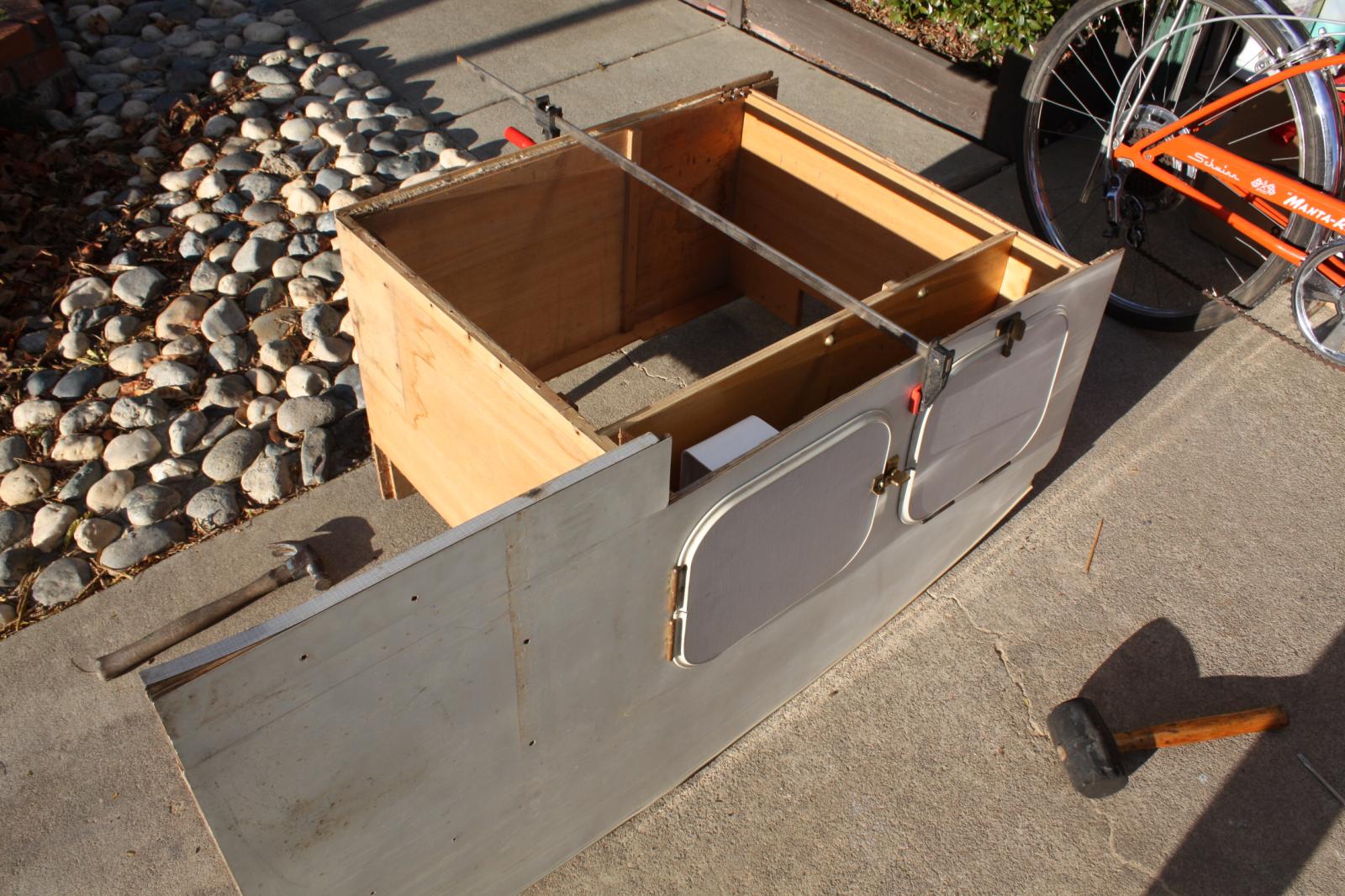

While I'm waiting to do a metal order I started cleaning up the interior kit
Hacked icebox
Icebox panel removed
new Icebox panel installed
Roll-around cabinet before
post redo

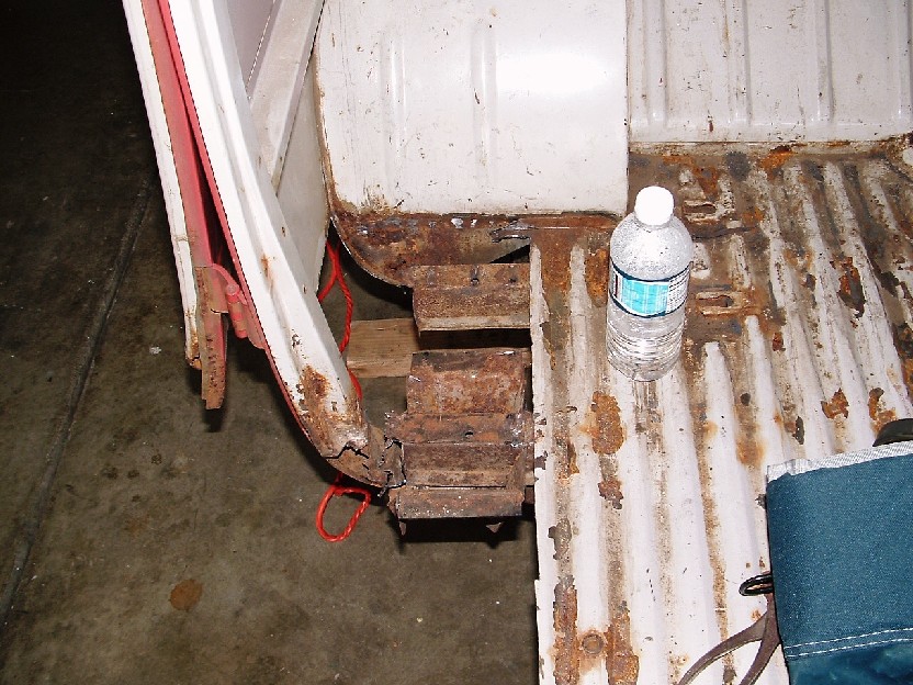

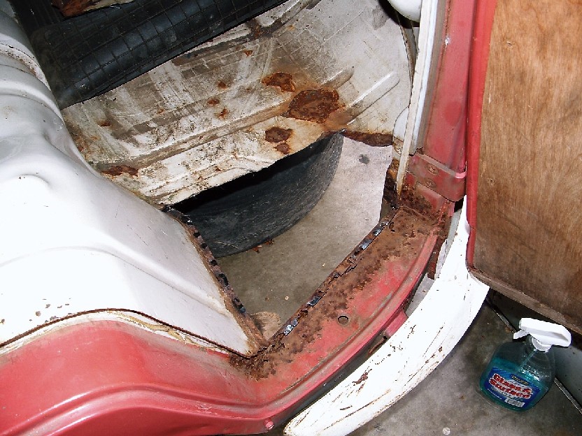

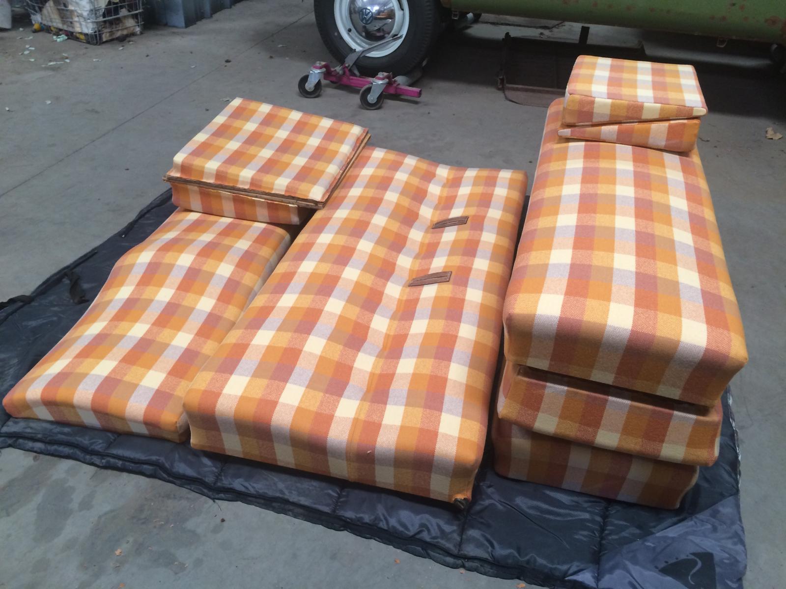

Somewhere in between. I'd like to be driving it next spring. I have sent the seats off to be reupholstered already and should get them back soon. I was lucky enopugh to get some of Alex's orange plaid years ago.
It needs rockers, A and B pillars, drivers battery tray, some roof repair and outer front floors.
I'm going to install a BN4 as well.

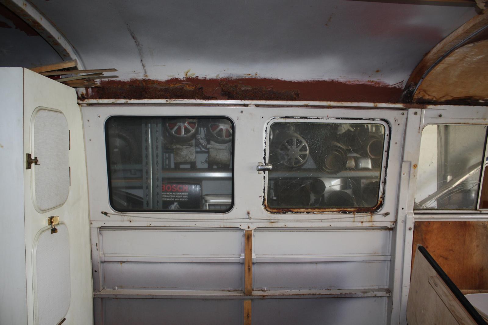

very cool bus. What is the that mystery hatch/panel on the drivers long panel above the rear wheel?

The previous owners at some point had hacked in a propane fridge and 5 gallon tank into the rear cabinet. I think the tank is in the fourth pic above. The hatch on the side is to access the tank and fridge from the outside.

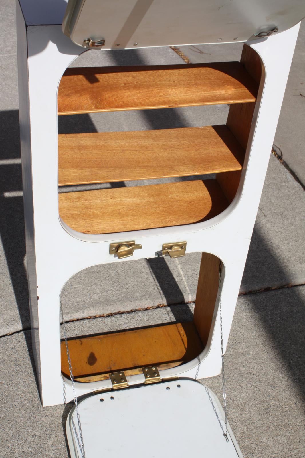

Door cabinet before/during
Post clean up

If anyone has the measurements for the mirror that goes in the door cabinet I'd appreciate it. I'm guessing 9x10"

This is an old pic so know that I’m not using that rocker!

Wow those seats turned out very nice! How much plaid fabric was required to redo all of them?
