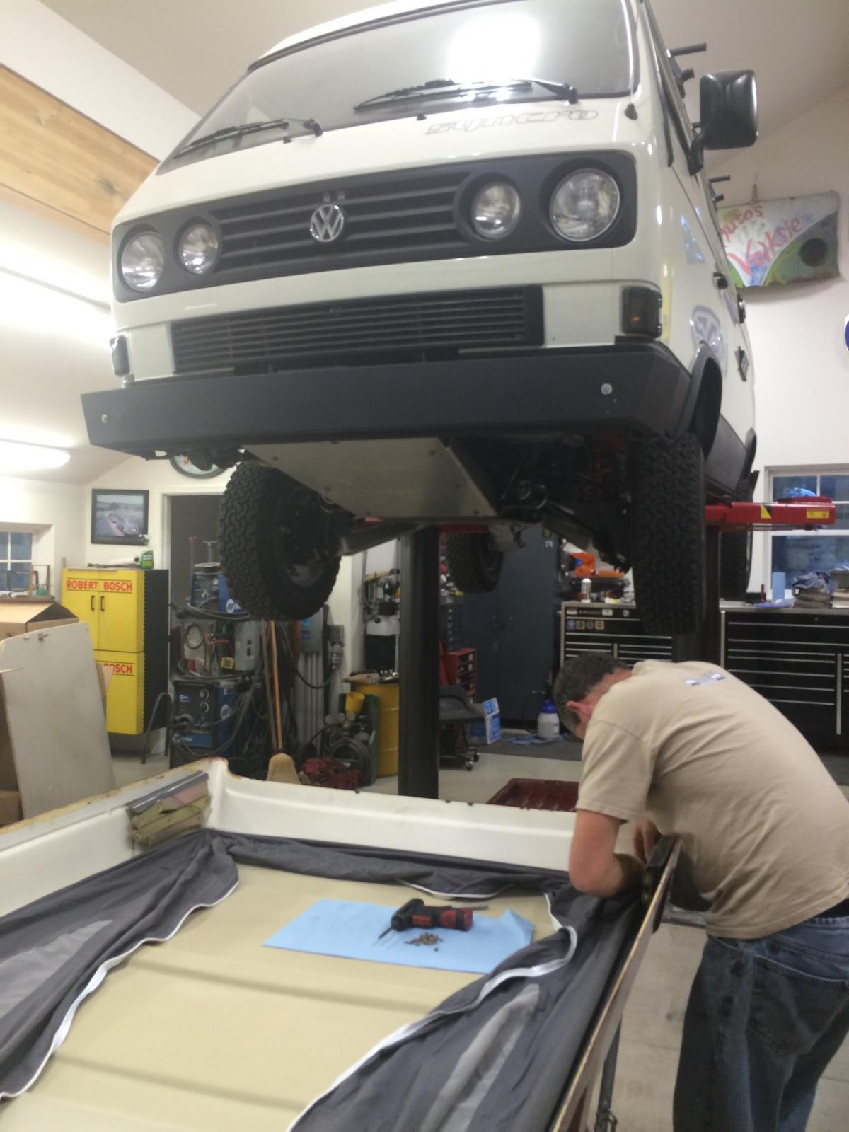

For the last image and post of this large mass build pic upload thread, I present the not so small upgrade...
Pop Top Westy Conversion here we come.
Done professionally to Factory Spec by the guru, Syncrozilla.
I'm very stoked for the opportunity to work along side a genuine craftsman and solid friend. I consider it a gift to learn by his side.
Oli is looking at her donor top prep work in anticipation:
The plan is to build a slightly modified Syncro H6 Suby Powered Westy Weekender. The swing out Aluminess Box will be our outdoor Kitchen Platform, A Yeti 50 as our refrigerator. It will still be lightweight, very off road capable, and offer great power. Keeping it simple while creating a highly functional camp mission, kiddo running, around town daily rig. Life is too short, I simply want to drive something I enjoy every day.

Seth Hathfield, aka Syncrozilla, and one of the key contributors to Syncrofest, has graciously allowed me to "help" and "work" by his side as we have dismantled, drilled, ground, cut, and welded our way through this. What a learning experience it's been from a very talented friend! This job is of the highest quality and every detail attended to.
This is a like-factory conversion and will post many photos below of the work.
Warning, Pic Heavy...

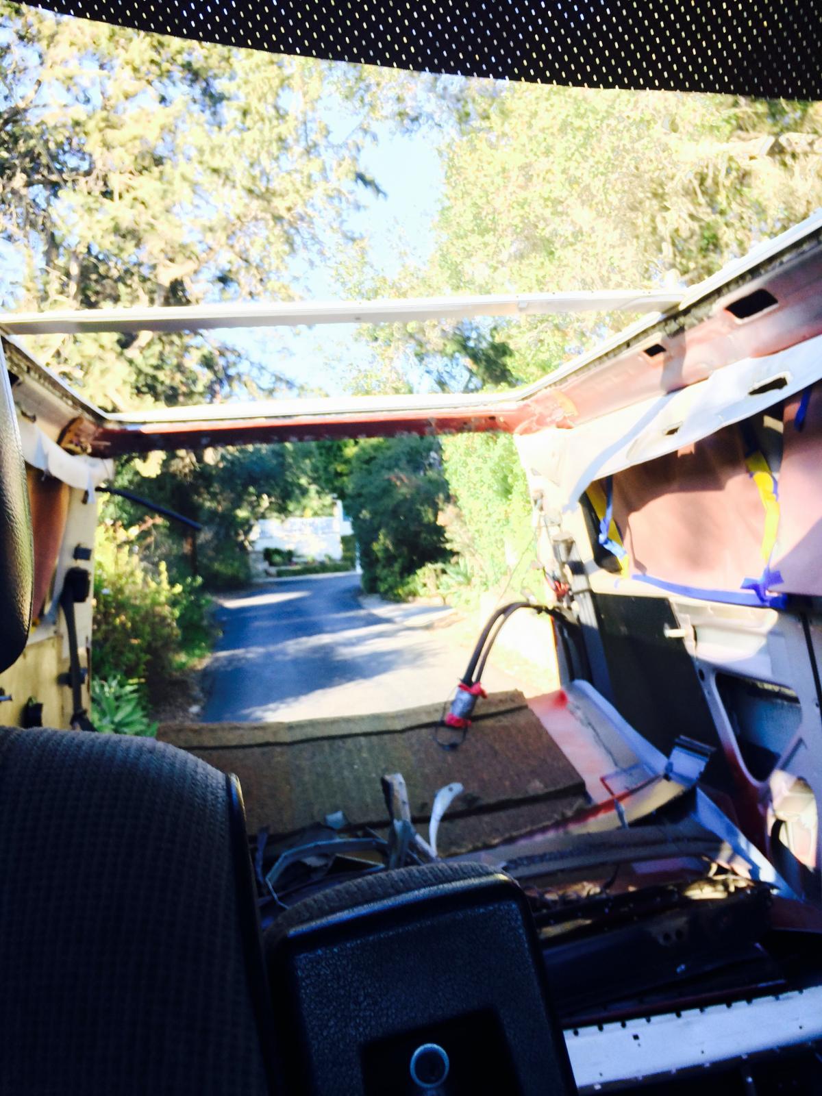

Headliner removed.
First big cut. Fully committed now!
Before and after initial cut (this was a great feeling!):
We ended up discarding the front of the donor clip due to a minor crease and opted to cut and weld right along where the canvas and luggage rack meet. The weld (although you wont quite be able to tell where it is once finished) will be fully covered. This decision didn't compromise the structural integrity and deemed a better overall finish once done.
Some Close Ups:

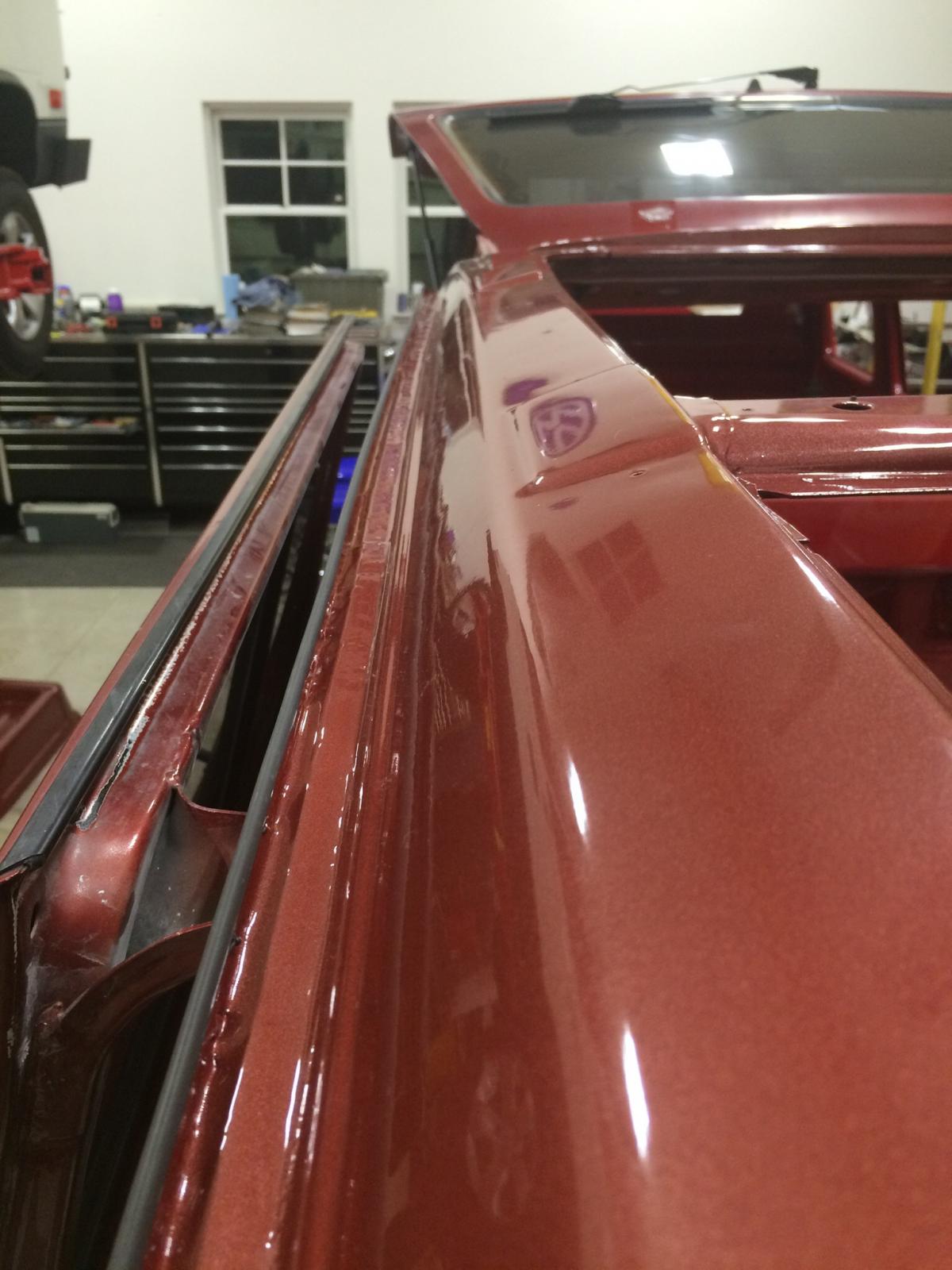

Tons of progress since the last posting.
Here's a few shots after Body & Paint:
I addressed a number of other small snackels over the last 25+ years of use while I was at it.
I decided to color match the top and keep it looking as original as possible.

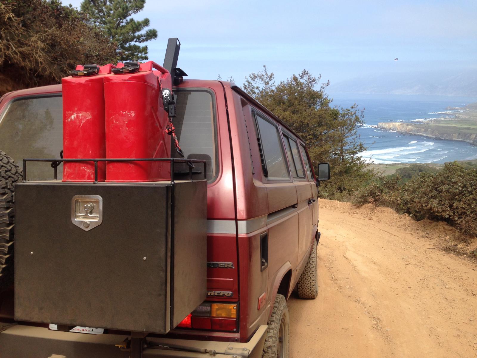

The BOX custom modification.
I owe all credit to the design to samba member 'whynotvw', who is a gem of a man btw, to the creation and implementation of what i like to call the BOX.
It's an Aluminess box (all aluminum with all stainless hardware for zero rust) mounted to the gowesty swing arm with ladder/uni pole using a custom built base.
This mod was one of the more functional, fun additions i did to the syncro thus yet.
It holds a surprisingly large amt of gear when traveling, stores a grip of wetsuits (keeps the wet stink out of van), and is the perfect outdoor camp cooking platform. Our Coleman fits perfectly in the fold down lid. This was my solution to cooking inside a Westy Van. Cooking outside is my preferred method.
One note of suggestion. Use 2"x2" square tubing for custom built base in order to keep box height high enough above brake and turn signal lights. Its critical that drivers see taillights. The box could interfere with rear taillight visibility if box sits any lower when mounted.
I also installed a third brake light purchased from Gowesty to add to the safety of potential rear end accidents.
Custom base to mount to Gowesty swing:
Box installed on Day 1:
H
Holds Jerry cans easily:
See cooking in action at base camp:

Thanks for the compliments. I Have learned a ton and really enjoyed the build. Hey m Goerzen- the aluminess box is a great addition. I highly recommend it on many levels. Extra storage, jerry can holder, kitchen set up with tray down, won't rust, wetsuit and gear keeper, etc.
couple words of advice for anyone installing the box. I recommend adding a 3rd brake light. Gowesty sells an inexpensive one or you can take the route Abel (Houston photog) did by integrating a couple different Leds.
The other word of advice. Assure you build a base at least 2" higher from gowesty swing arm base to clear the tail light visibility. Those two recommendations will keep folks from rear ending you. Smile
I just let the propane green Coleman tank hang off the side of stove - easy peasy.
I also just got a Partner stove and have to say it's the stove to have. The partner stove fits perfectly in the aluminess tray. It looks like it was built for the stove. The mini propane tank can sit in the ground or up above. I will have to take a photo of it.
