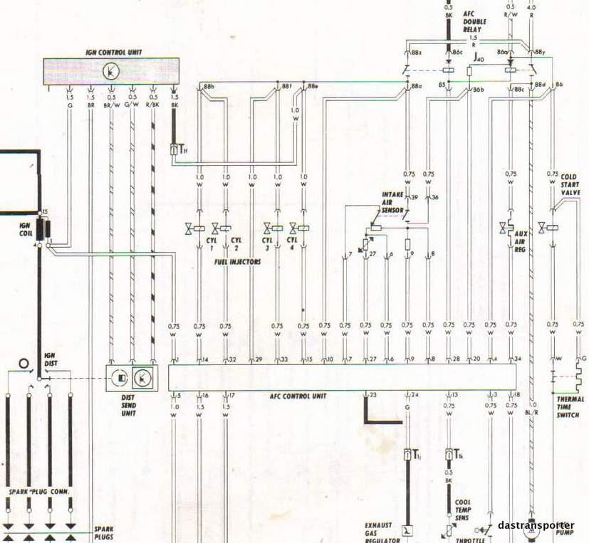

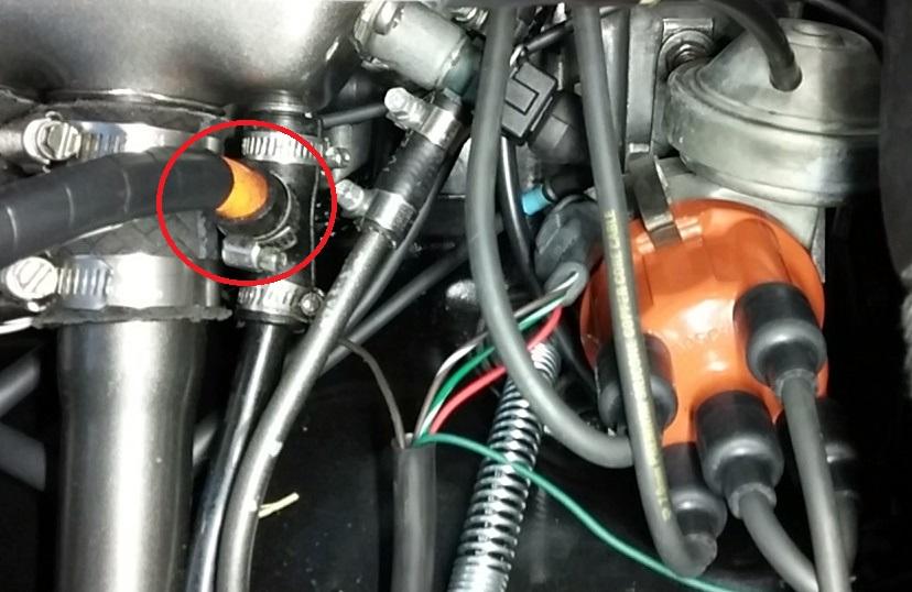

There are 3 wires coming from it, outside of the connection to the distributor body. One of them is green, which goes to the special Coil. One of them is brown which ive connected to the grounding spade below the 3/4 intake runner.
The remaining wire is black, which I believe goes to that little connection hanging from the bottom of the double relay. At least, that's what it looks like it's supposed to connect to when checking the wiring diagram.
Can anyone with this system confirm this is the correct setup for the factory electronic ignition system?

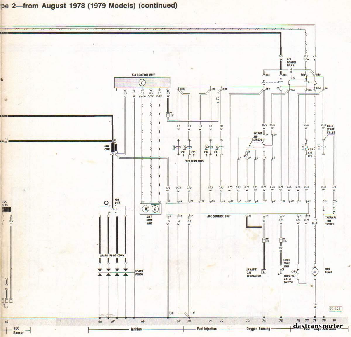

Indeed, there is a cable going from the Ignition Control Unit mounted on the firewall to the distributor. In addition to that cable, the loom leading out of the Ignition Control Unit has 3 addition wires.
Brown is ground, I got that and it's connected.
Green goes to the special coil, which ive got.
Black looks like it goes to the little wire that dangles out of the bottom of the double relay. I think the pic above confirms this in the factory wiring diagram, but I was hoping to get confirmation from someone who's actively using this setup currently.

Green to coil - (#1), brown to ground, black to switched power, which I usually pick up from coil + (#15).
