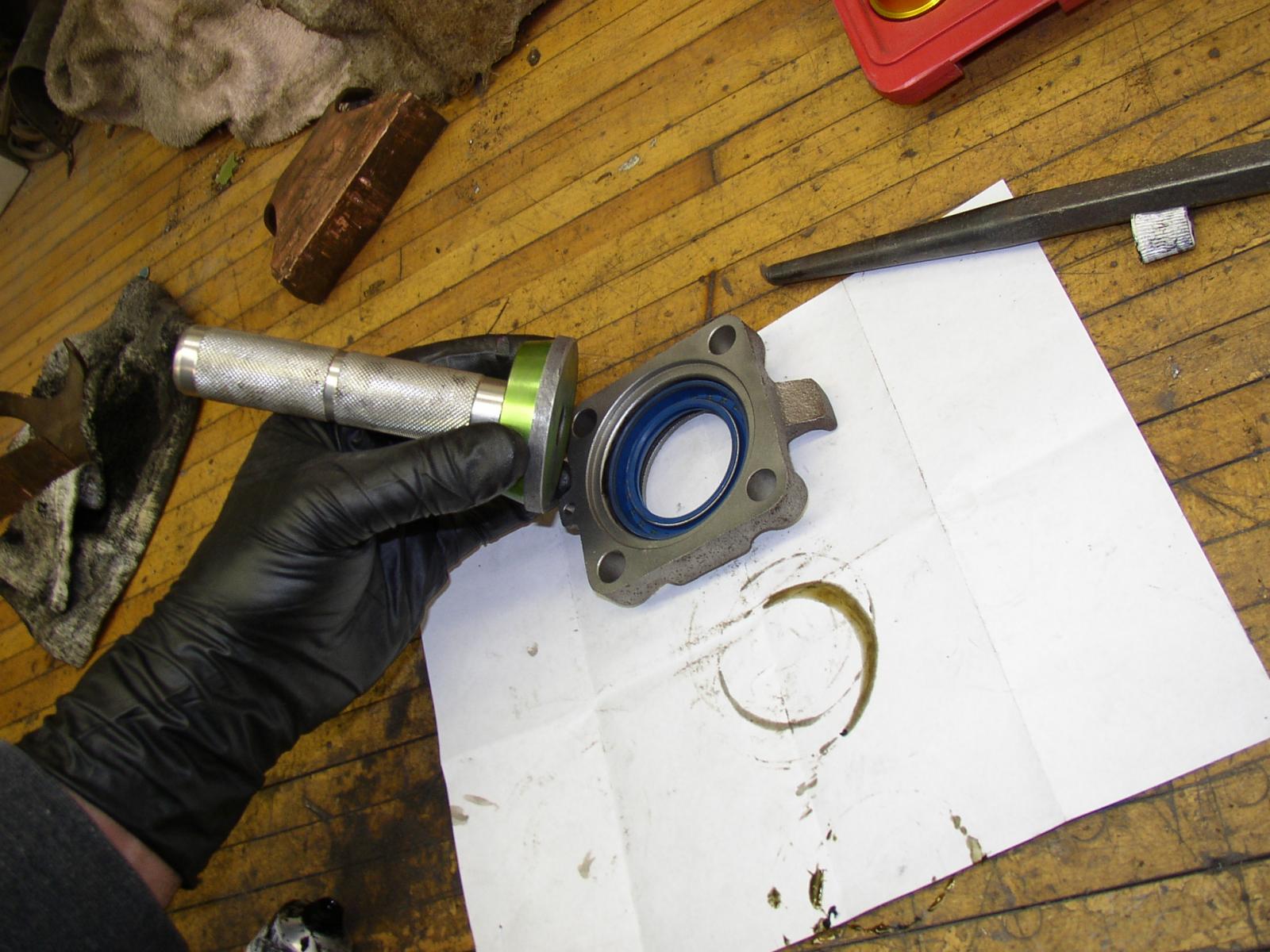

Here's how I did this recently on my '66 big nut:

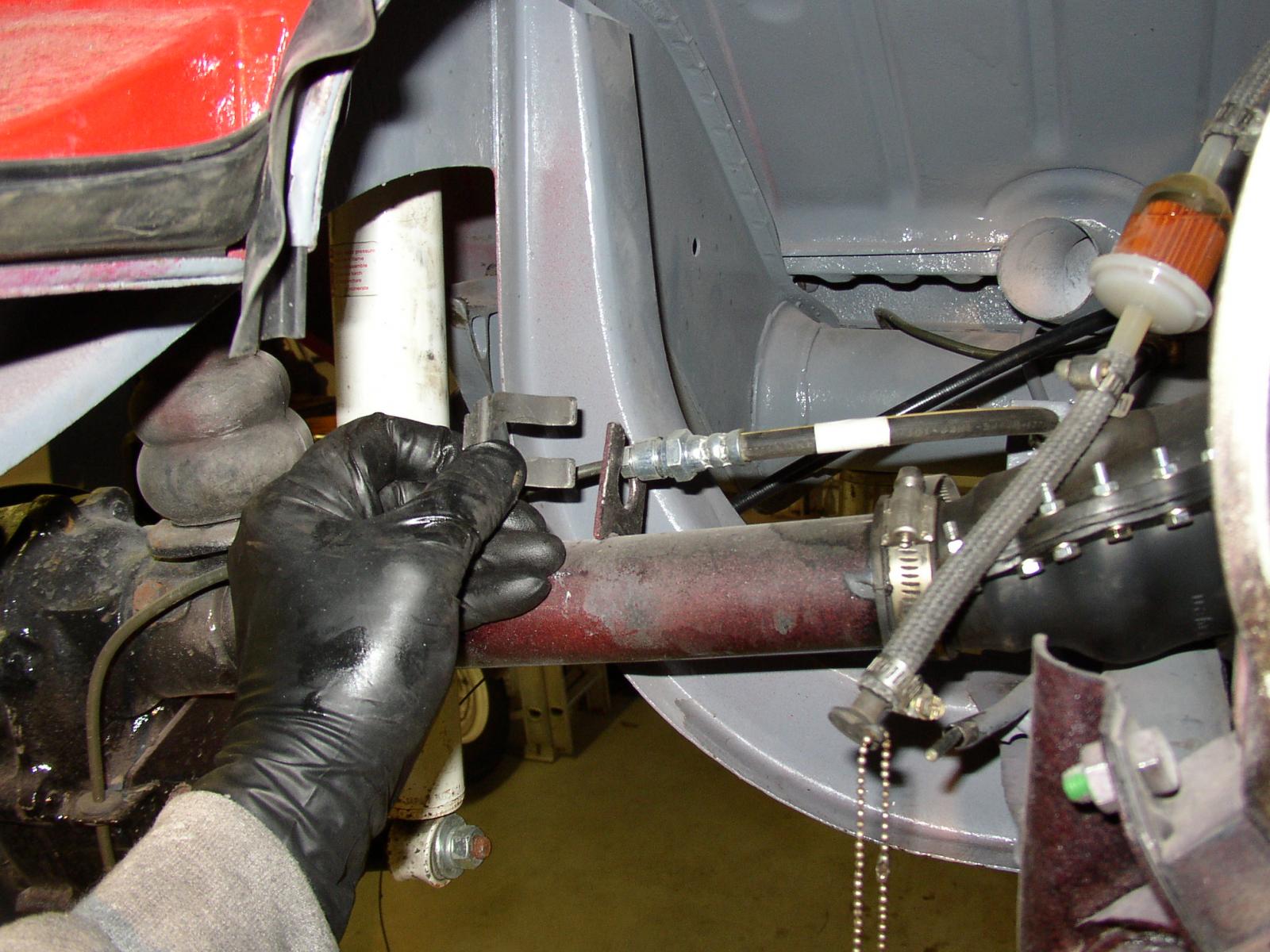

Remove the wheel and drum and disconnect the parking brake cable. The Bentley says you have to unhook it up front to remove the backing plate but that's not true, it pops right off at the lever inside the drum.
Pull the cable and hide it out of the way, it's a slip fit in the backing plate.
Remove the clip from the brake hose and loosen it from it's mount:

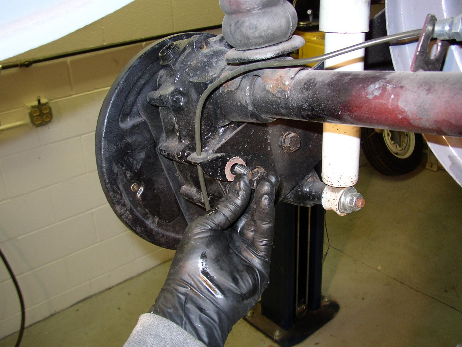

Remove the one bolt from the RGB holding the brake line retainer:

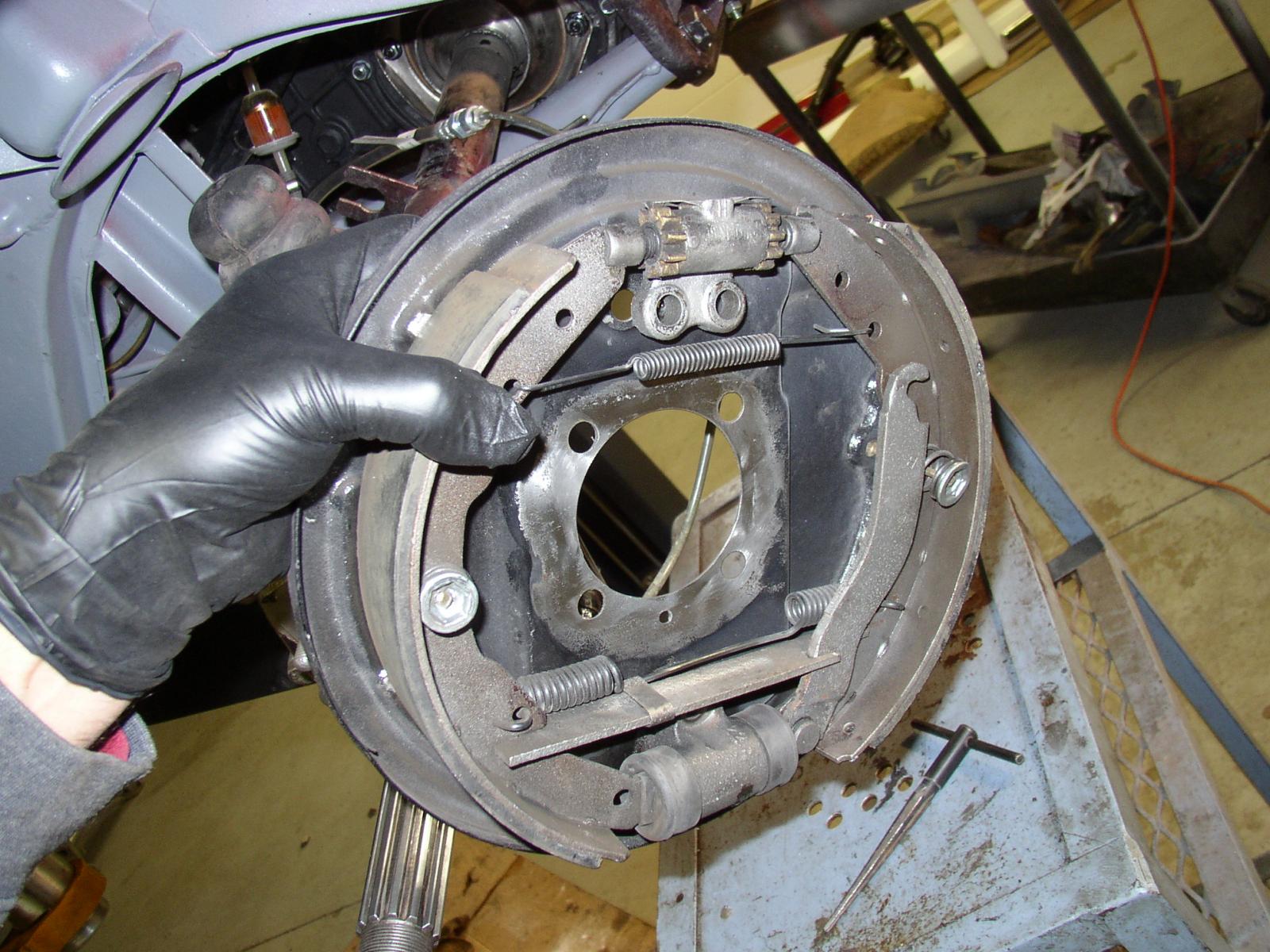

Unbolt the 4 bolts from the seal retainer and remove it and the backing plate. Hook the backing plate on the torsion housing using a S hook from a bungee cord. It's not necessary to disconnect the brake hydraulic line. It's necessary to remove the backing plate because oil can/will seep between the BP and the RGB housing mimicking a seal leak.

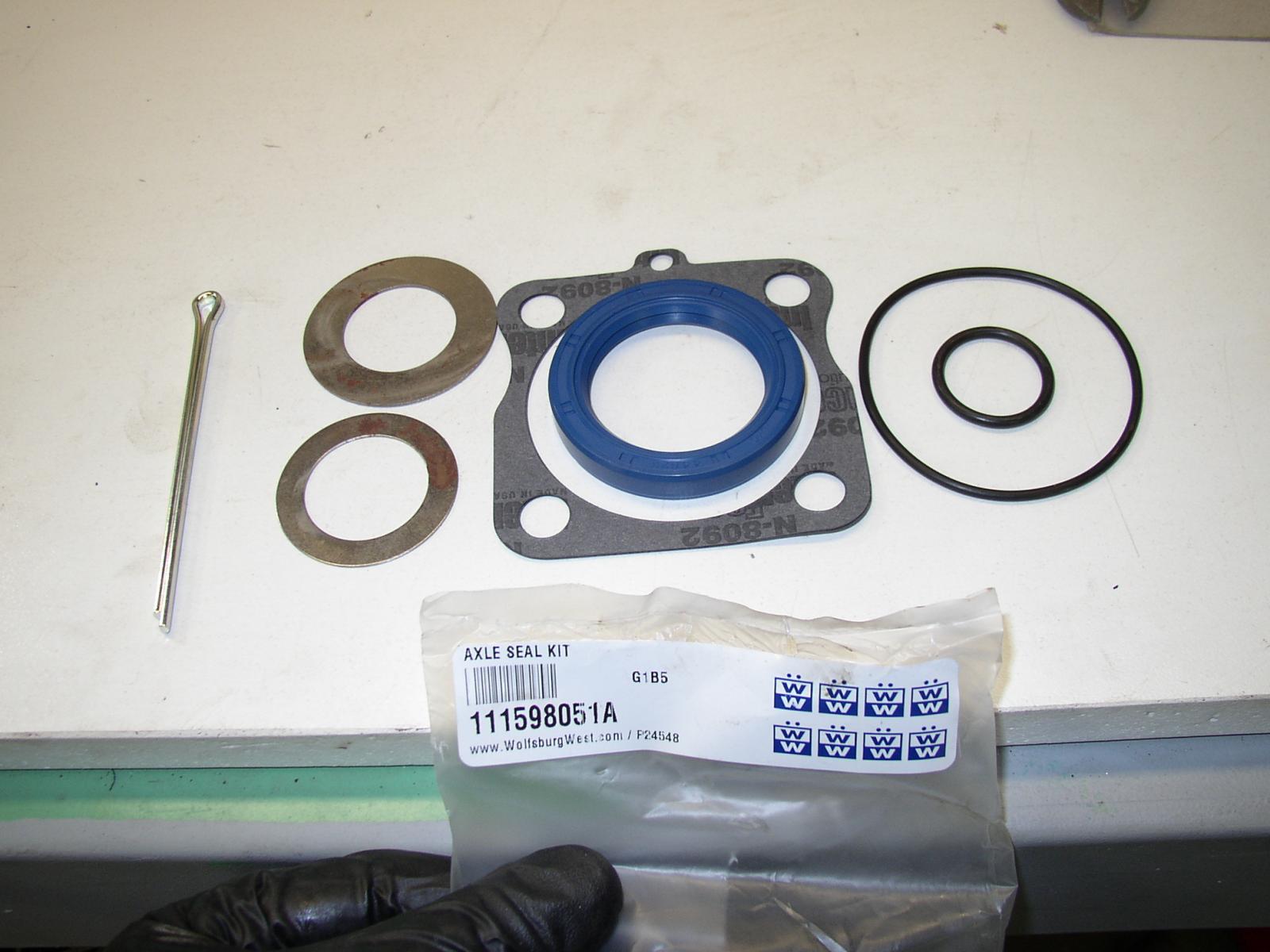

I used WW seal kits but most of it I don't use, only the seal, small o-ring, and cotter pin. The rest of the stuff is for Type 1s.

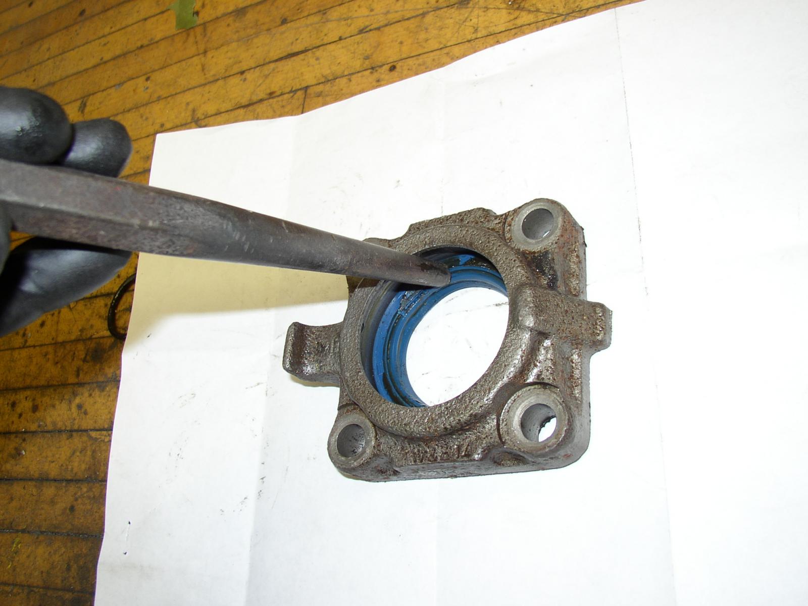

Drive the old seal out using a punch.
Clean the housing thoroughly, I bead blast and then brake clean and air. It's sitting next to the old seal.
I put a thin coat of Toyota FIPG on the inner surface where the seal seats, this is a high quality RTV. You may want to use your preferred brand. Being that this is a rubber coated seal this might be overkill, if it's a metal ringed seal this is important.
Set the seal in place, "lip to the lube". That means don't put the bastard in backwards.
Either push it in with a vise, which is what I did, or
Knock it in with a hammer. Either way, use an appropriate driver. Yes, you can sometimes cheat and use a big socket if you have one, but a seal driver kit is cheap and everyone should have one. HF sells them.
Push it in until it seats on the bottom. There's a channel for leakage to run out if it seeps, note the hole is clean.
