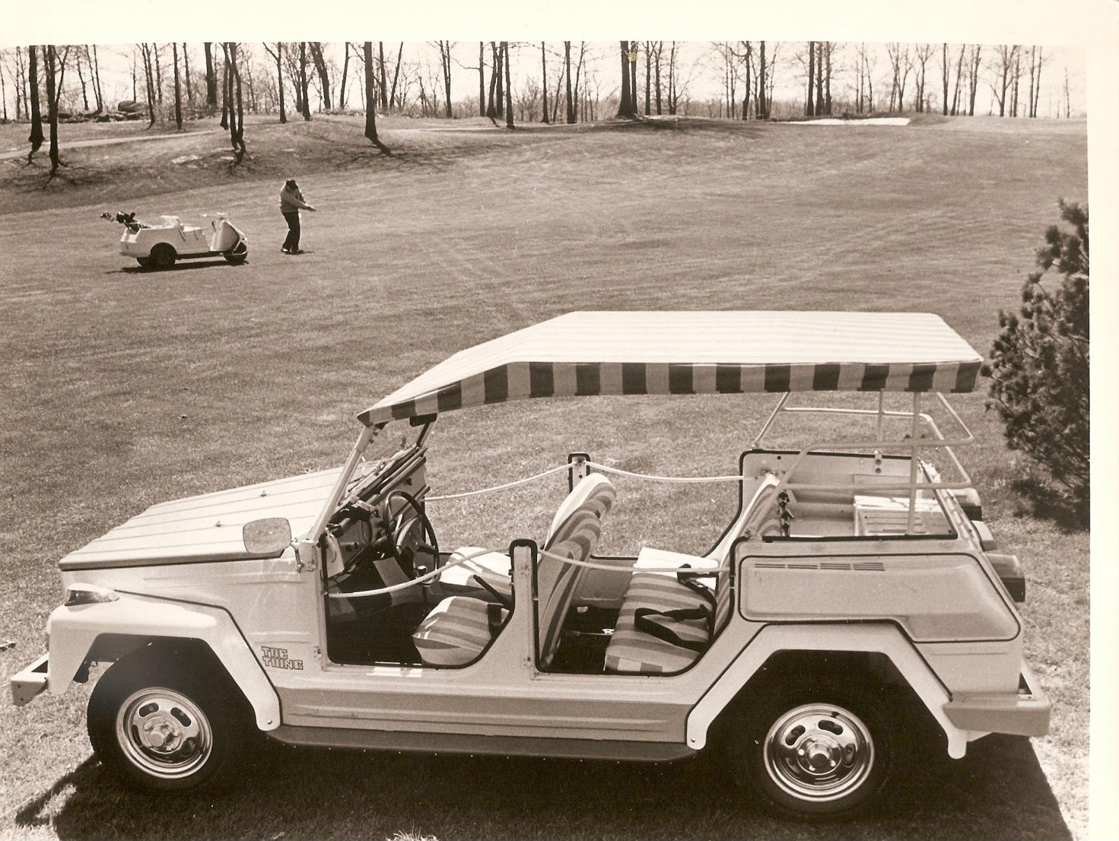

PostPosted: Thu Feb 19, 2015 9:37 pm    Post subject: Reply with quote
Here is a little more info on the Acapulco and a old picture
