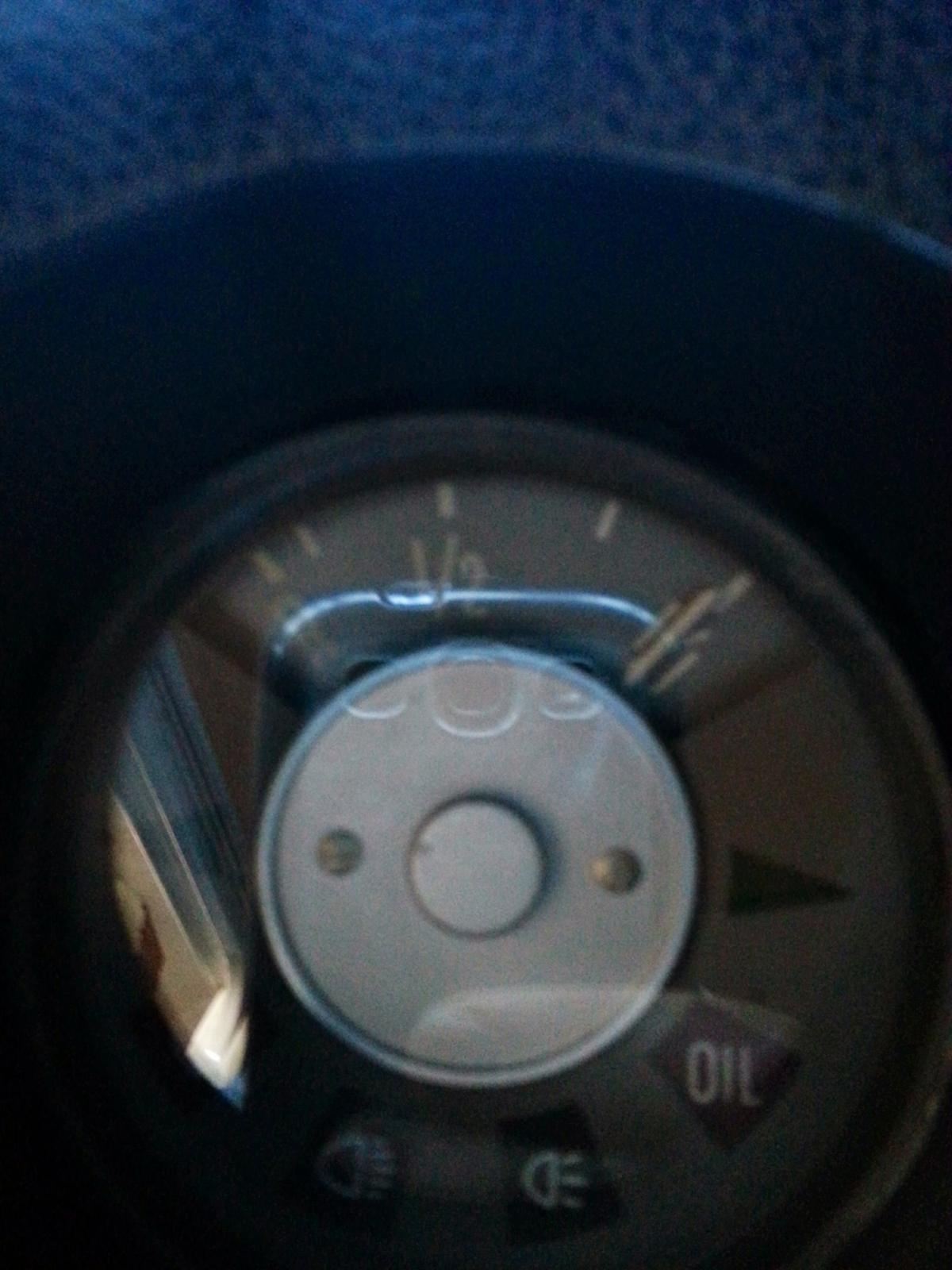

Both wires are intact and I see nothing obviously wrong with it. Does anyone see anything obvious that might suggest why it quit working?
Looks like I'm going to be buying a new sender. Now, the question is should I cut an access hole before reinstalling the tank...again.

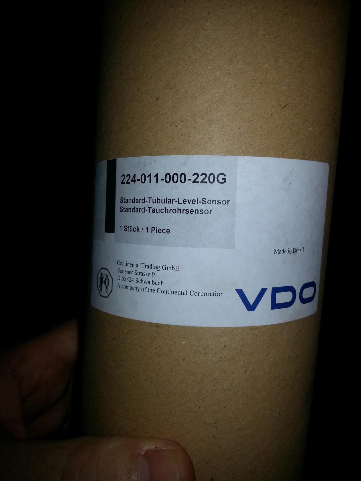

I got my order in from Bus Depot. I ordered it ground and they do take 2-3 days to ship when you order ground..
I got the new fuel sender. It is VDO brand made in Brazil. Bus Depot's site is a bit miss-leading as it says clearly on it VDO (Germany). I think we all know VDO is a German company but I think they should change it to VDO (made in Brazil).
It came nicely packaged in a solid tube.
Here's the top of it.
I hooked it up to my multimeter. It went from 5 ohms with the float at the bottom to 80 ohms with the float at the top. I was a bit worried that my gauge on the dash was off a considerable amount based on how the last gauge worked before it crapped out.
I hooked the plug to the out on the sender, then grounded it. It went just slightly to the left of empty with the float at the bottom of the sender.
I then rotated it so the float would move to the top of the sender or "full". It quickly climbed to just left of full. I can live with that!
Now, I need to reinstall it in the tank and put the tank back in the bus. I plan on putting a few gallons in the tank to check it again before reinstalling the tank back panel and engine. I hope this sender doesn't have a cheap float in it that sinks after a while.

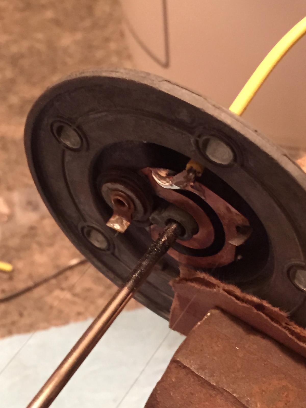

I have a non working gas gauge in my 1970 bus that I picked up this summer. I have been going through the bus this winter and next on the list was to clean the fuel tank and trouble shoot my gas gauge. Actually, next on the list was to reinstall my engine tins, but I realized that the thermostat and its linkage to the flaps was removed. I ordered those parts and while waiting for those to arrive.....it is on to the fuel tank. When I first pulled the tank I could see that the ground on top of the sender flange was pretty corroded.
I cleaned everything up and could not get the sender to bench test by grounding on the flange, but it would function if I grounded directly to the copper circular piece. I took Busdaddy's advice of drilling through the top and soldering to the copper piece.
It is nervous work handling this thing.....I think those resistance wires will break if you look at them wrong.
The float and ohm readings travel nice and smoothly all the way through.
The wire insulation is pretty snug through the drill hole, I still need to get a little JB Weld or something on it.
