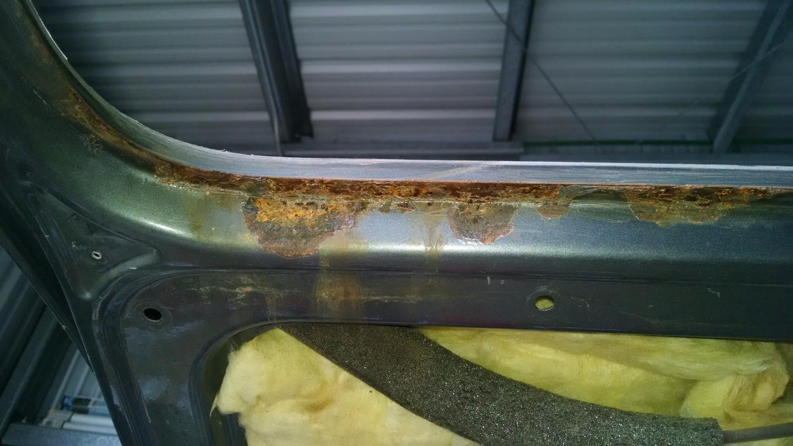

Our van’s body was in good shape by most standards. We were lucky enough to be the third owner of the van that had been in the PNW for most of its life. Basically no winter salt. When we first bought the van seven years ago, the nose was heavily pitted from road rocks. I had the nose and two other panels painted.

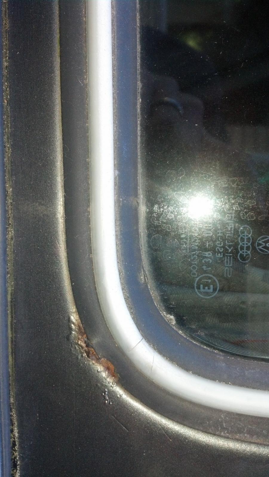

After seven years, I found some new rust in a few spots near and under a couple window seals and the rear and front windows had small leaks. The leaks were not properly stopped with silicone near the seal. We had also acquired a couple of new rock chips in the nose, a scrape in the slider and the front window was due for replacement. In short, the seals were at the end of usefulness and I knew rust was slowly working.
I thought by being a bit proactive, I could minimize the actual amount of rust needing remediation. With a target budget and expectations in mind I took the van to about three shops. Definitely learned a bit about each approach and cost. However in each discussion, the van still had the windows in and the extent of rust was really unknown. So I did the logical thing – I stripped the van of everything I could so I could see what I was dealing with and then have some specifics to discuss with a painter. This made the decision process easier and allowed me to come to terms with a painter pretty easily and hit my target budget of $2,500.

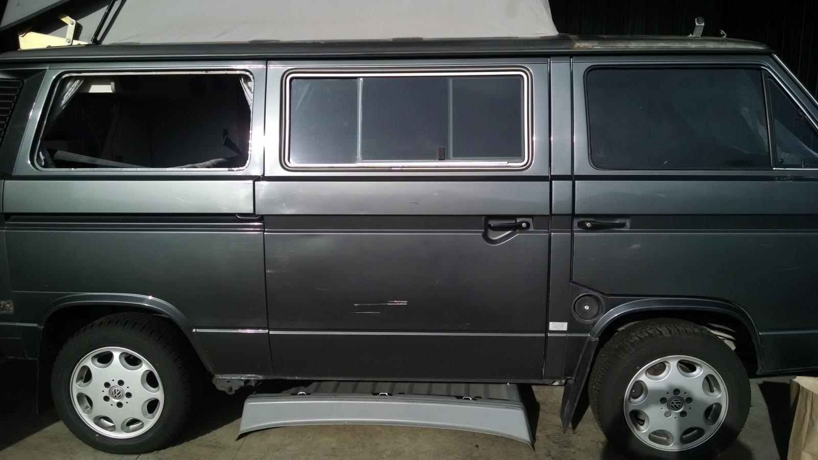

General Shape of Van:

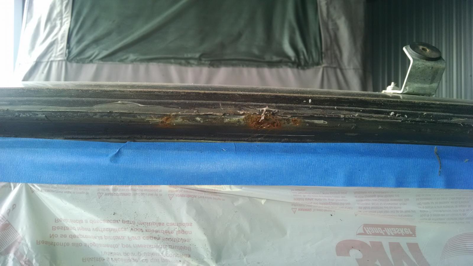

Window seals – rear side windows.

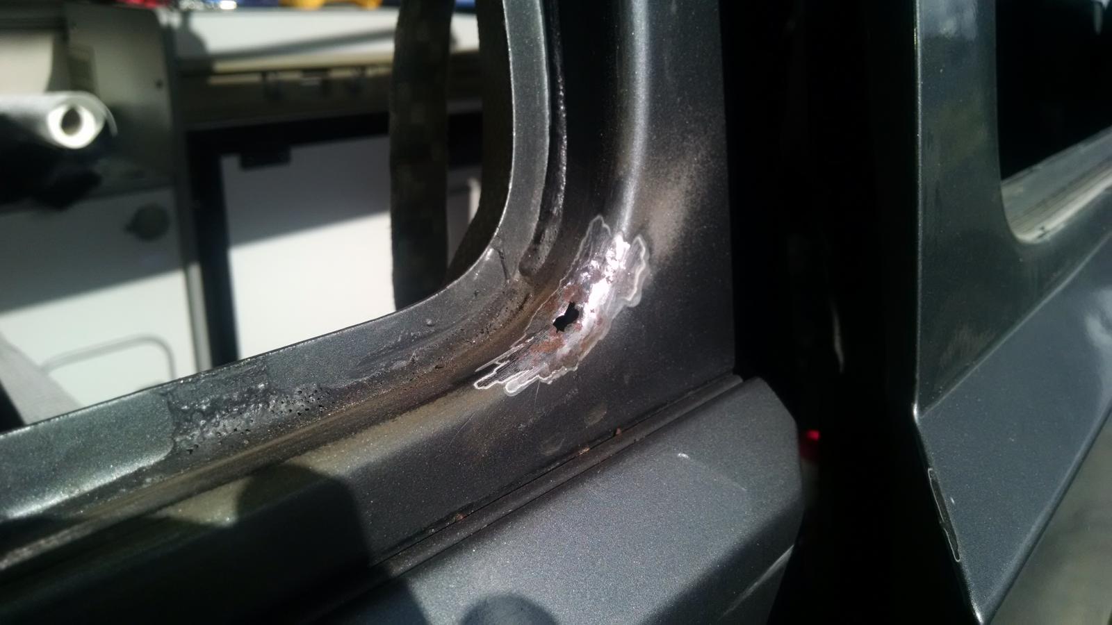

A quick grinder revealed
Above front window: I considered myself very lucky to not find any rust in the bottom of the front window, a couple of small holes under this rust.

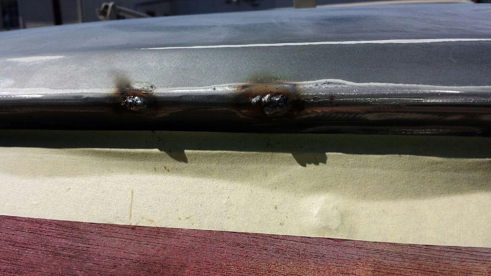

A little welding
& grinding
Rear window: This was really the worst spot for the project.
Slider door: Rolling Eyes

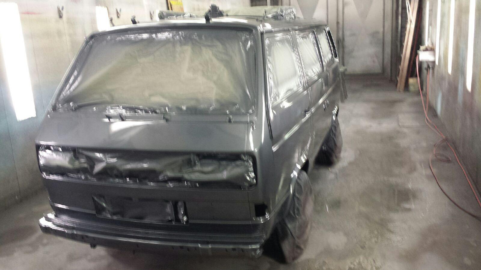

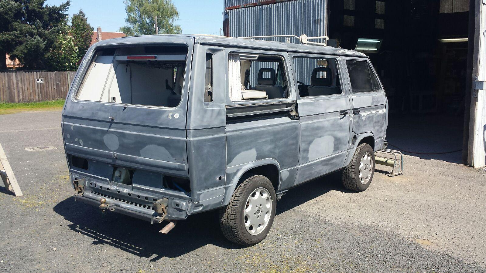

In progress:
Results so far.
Finished Walk around:
