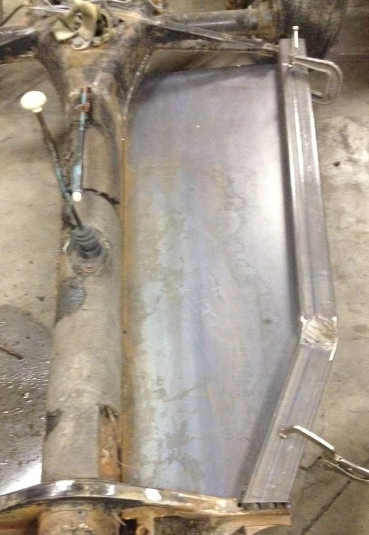

PostPosted: Mon Apr 20, 2015 9:43 pm    Post subject: Reply with quote
so i got one side floor pan cut out and just sitting in place. other side tomorrow night i hope

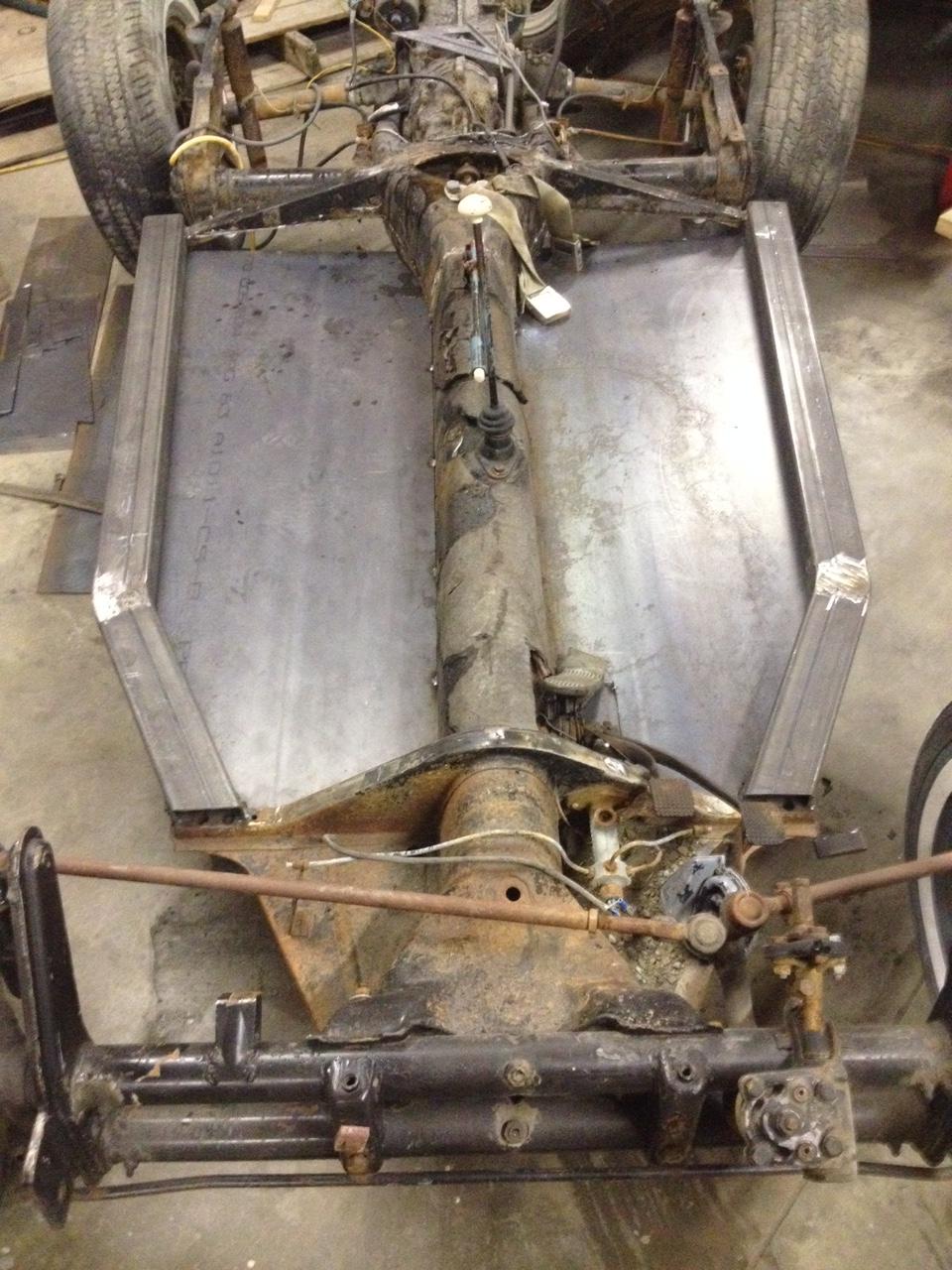

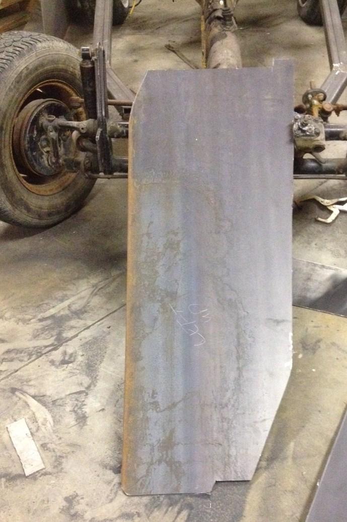

PostPosted: Tue Apr 21, 2015 9:44 pm    Post subject: Reply with quote
got the right side floor cut and also go both of the tacked into place so i can move onto other things. and alos got my pedals figured out too.just need to figure out where to put the pedal stop bolt hole

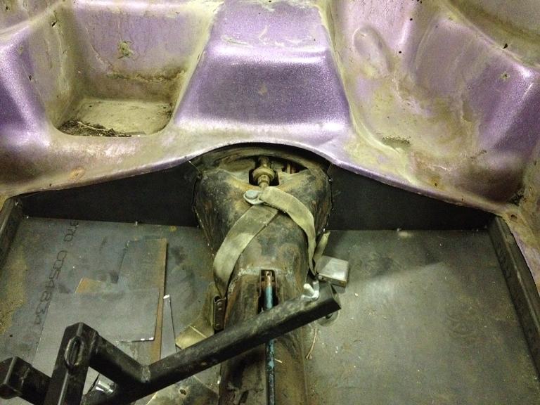

PostPosted: Tue Apr 28, 2015 9:28 pm    Post subject: Reply with quote
got the "hat" weld into place, just need to clean up the welds. thay look way worse then they are. next will be the rear portion then the mount for the steering column

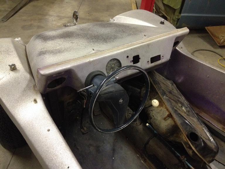

started to do the fab work for my gm/buick steering column
this is from the underside trying to get things into place
just got the column held in place with a strap need to make the uprights for it yet

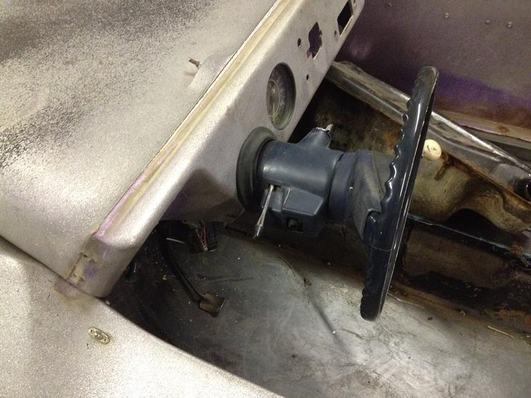

PostPosted: Thu May 07, 2015 9:41 pm    Post subject: Reply with quote
so i got the stand alone steering column mount all tacked up and in place tonight. at this rate i will be doing final welding for a week straight.

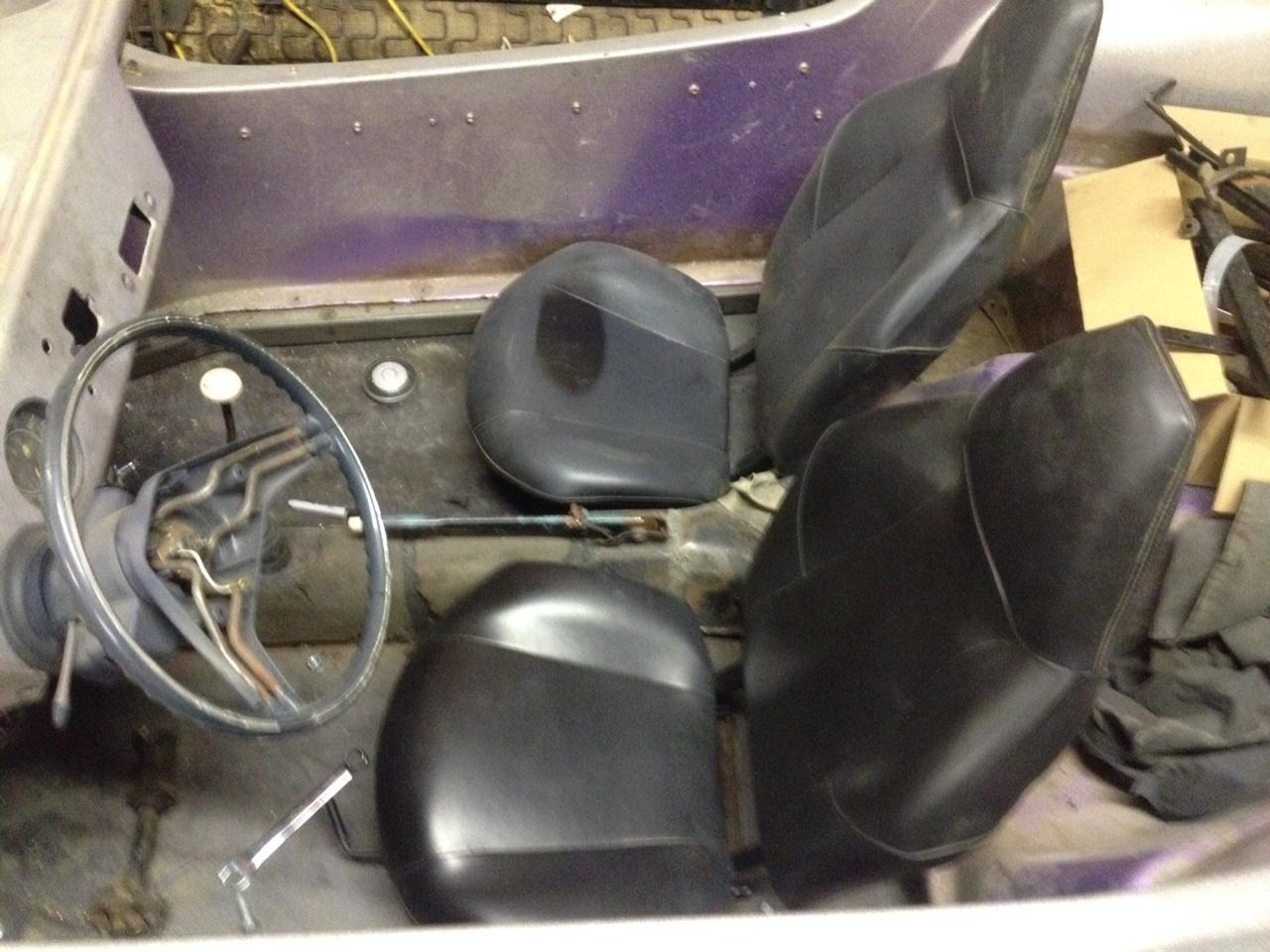

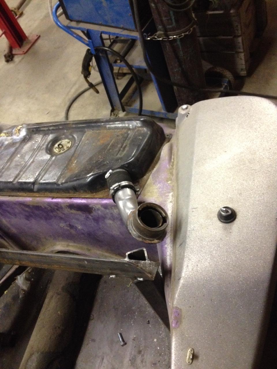

PostPosted: Sat Jan 23, 2016 9:26 pm    Post subject: Re: My project Doom Buggy Reply with quote
well almost a year later i am working on this again
got my gas tank modified for the buggy. going to us a remote fill
pictured here

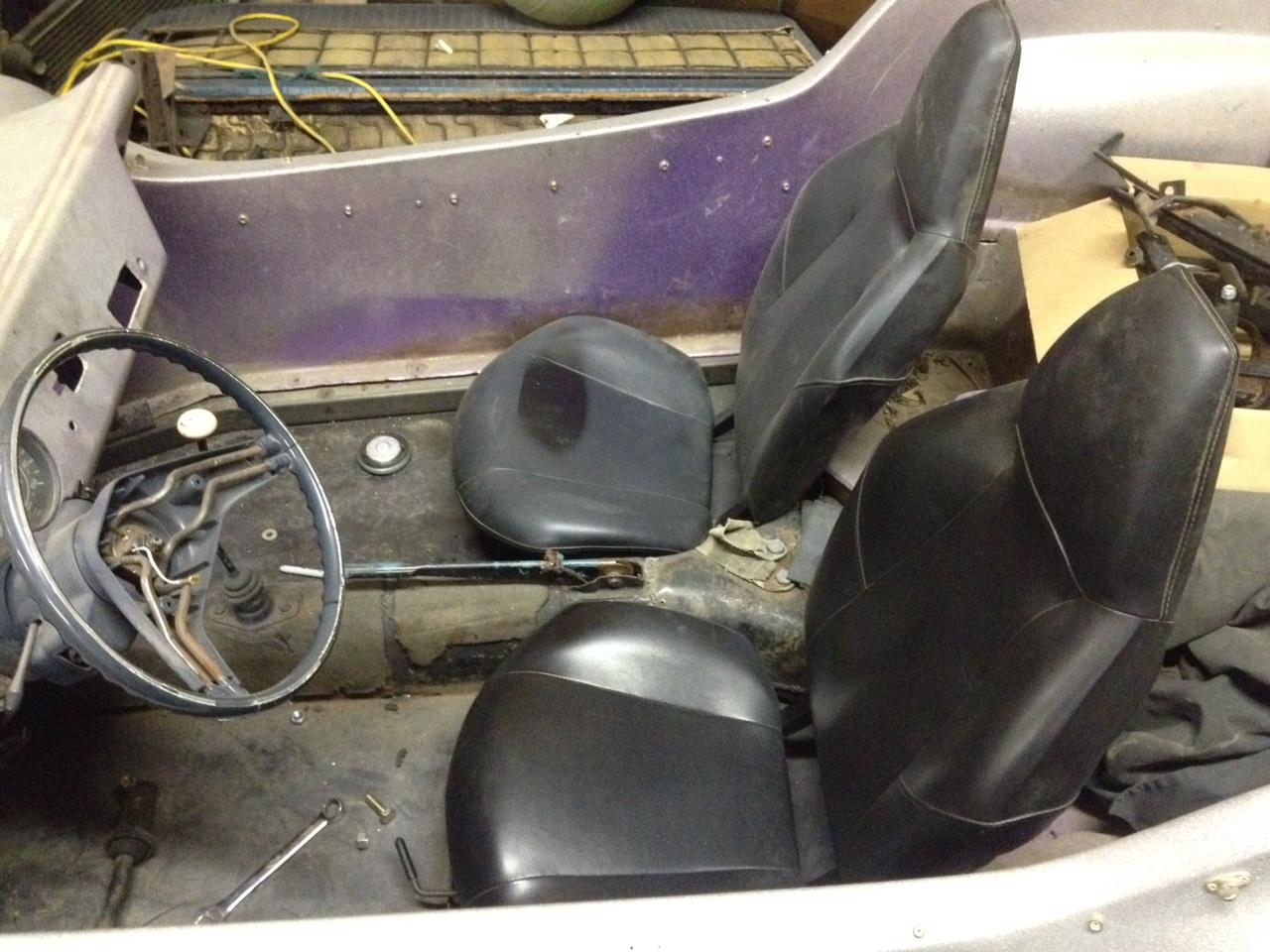

also got mt driver seat mounts figured out. i am using rzr seats with only adjust on the left from a mazada rx7
cdnltded

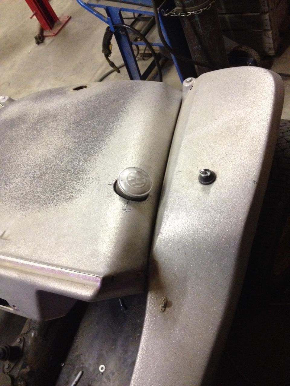

PostPosted: Fri Jan 29, 2016 8:34 pm    Post subject: Re: My project Doom Buggy Reply with quote
seat all the way back
seat all the way forward
gas filler hood off
and under the hood
i think i am going to still add a bracket to the steering column support

PostPosted: Thu Feb 04, 2016 10:24 pm    Post subject: Re: My project Doom Buggy Reply with quote
got my passenger seat mounted. but i think i put it too far forward

PostPosted: Sat Feb 13, 2016 2:54 pm    Post subject: Re: My project Doom Buggy Reply with quote
go the support for the filler neck welded in place as well as got the steering column support all welded to the final
