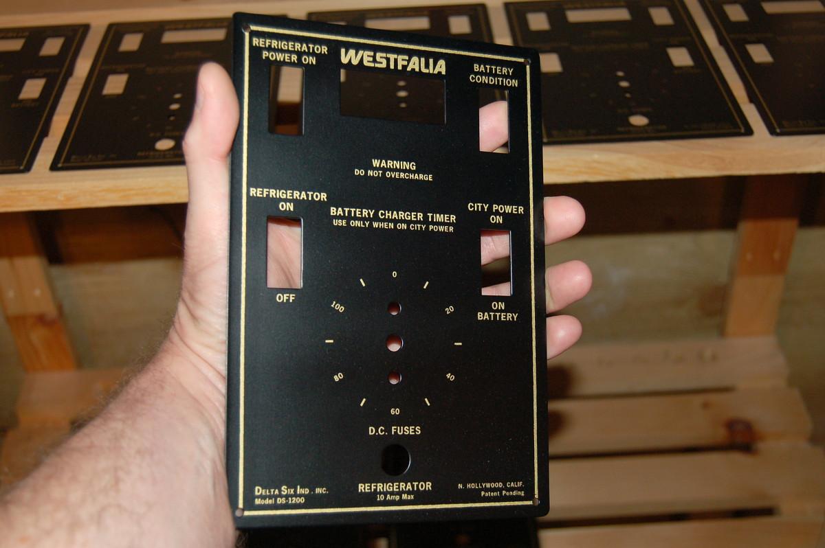

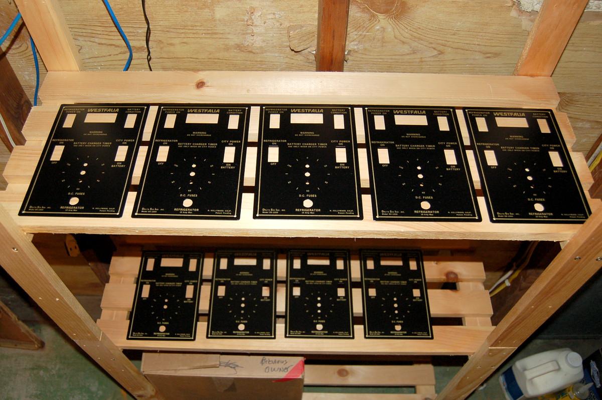

The panels are back from the silkscreener. Dancing
Don't believe me? Well, here ya go ...
See that "R" on the end of "BATTERY CHARGER TIMER"? Yep. Right where it belongs.
Now look at the wording "D.C. FUSES" just above the fuse holder hole. Uh, oh ... there's only one fuse! Shocked
Gotcha ... that's just how Delta Six made 'em originally! Razz

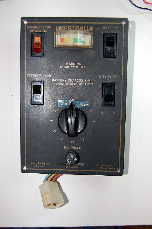

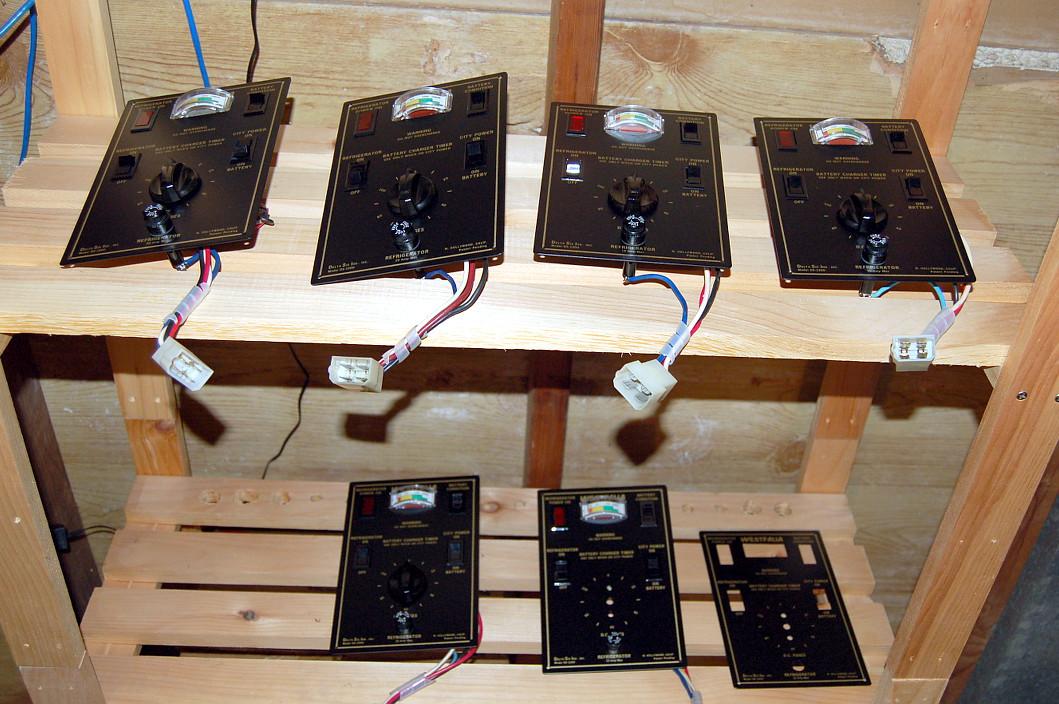

All of the current batch of control panels are finished, boxed up, and waiting to be shipped out. If yours is one of them, you should have received an email telling you this. Let me know if you didn't get this email ('cause it's time to pay).
It was a proud sight, all those "new" control panels sitting there (that bare one is mine. You know, cobbler's children and all that Laughing) ...
It was real hard to pick a "most improved" one. The one with the extra fuse holder and binding posts drilled into it was a likely winner, but I can't find my "before" photos of it.
So, I'll pick this one instead Shocked
They all look like this now. Arrow
That's going to be it for panel work for now. I've had to put a lot of stuff on hold getting these done, so it's time to catch up on a few other priorities. Besides, this isn't the "control panel thread", it's the one where I post things I do on our own bus! Anyways, a big Exclamation thanks Exclamation to all that let me rework their panels Very Happy

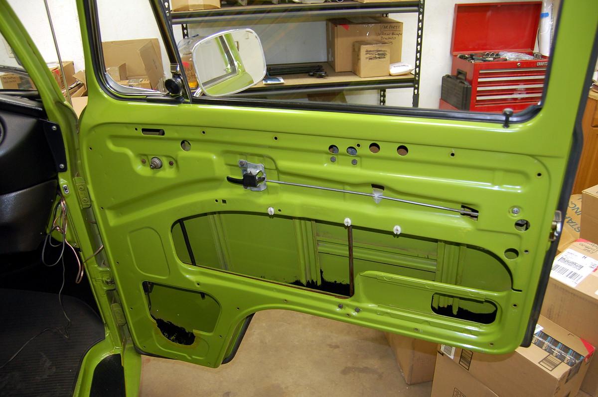

Front Door Overhaul: Completion!

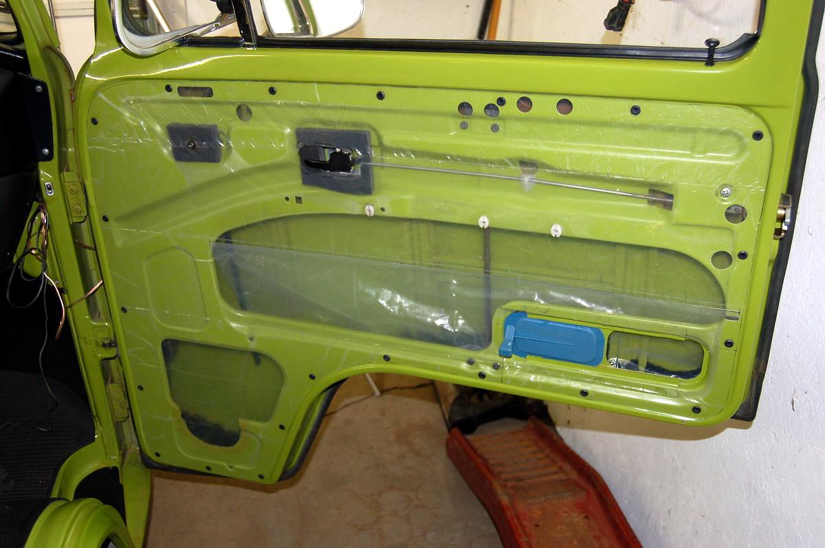

A long, long time ago I started working on the front door overhaul, got the left side all done and sealed up, the right side rebuilt but left off here:
Had to make a new water shield and foam pieces that go around the door handle and window crank shaft...
... and glue 'em all onto the door like so.

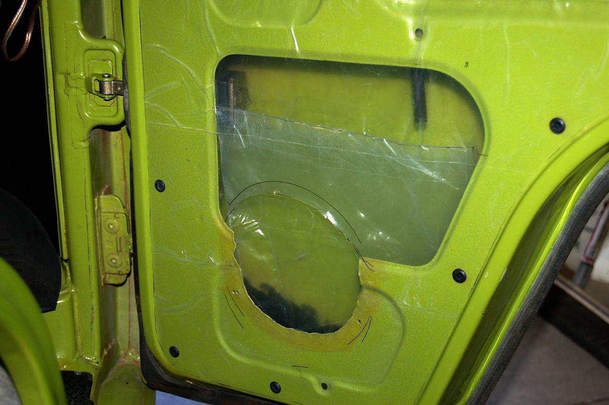

Oh yeah, we're putting speakers back in, so decided to add a flap of plastic to keep water running away from things back there.
Last step was to make a template to transfer speaker cutout and mounting hole features to the "new" door panels. (My wife is very good at this sort of thing!)

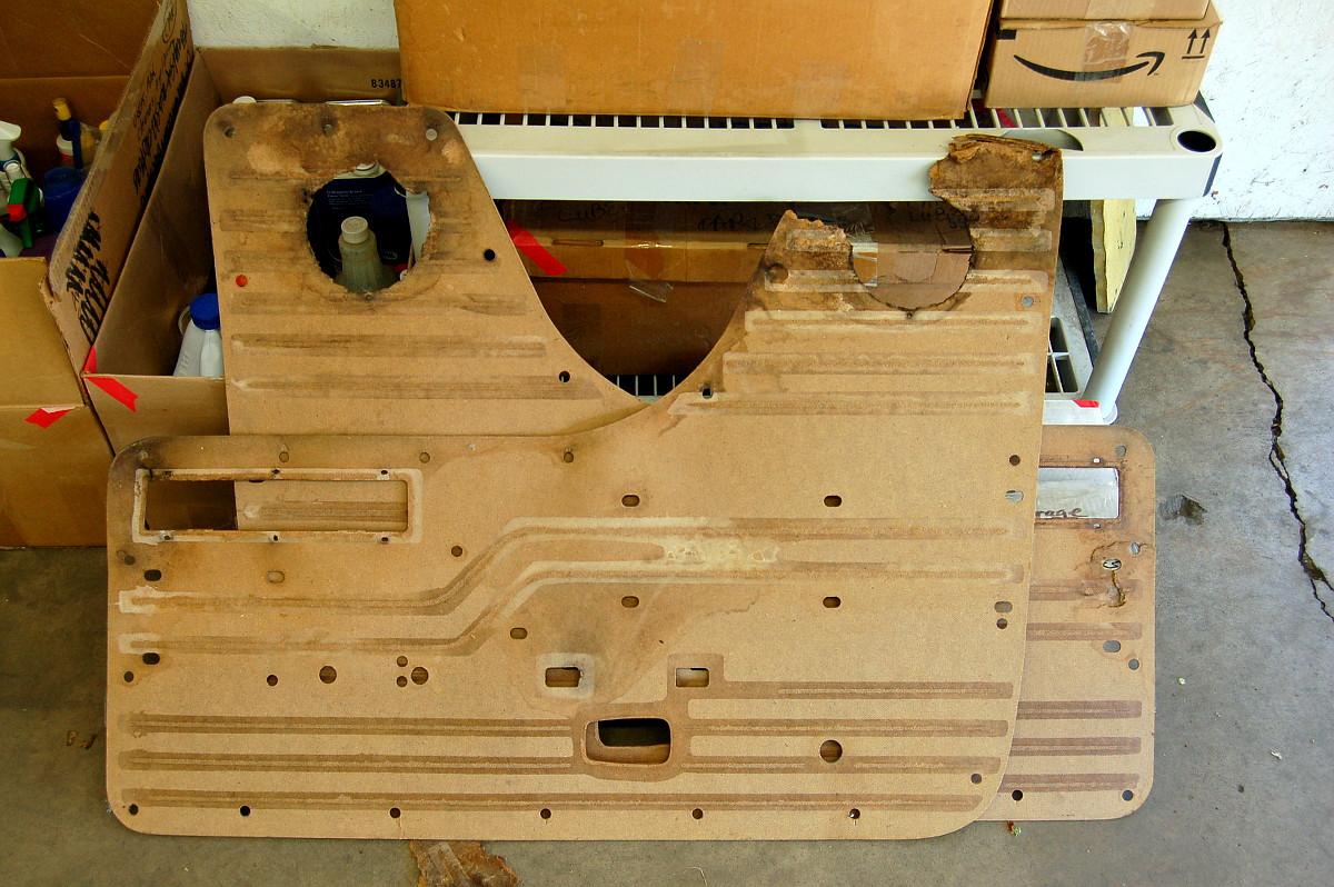

Background: It's a long and tiring story but when I started on this project there were no replacement panels. Then Bus Depot came through by importing panels that were the right color, but otherwise looked nothing like original late bay panels. At this point I committed to restoring my originals. By the time that Bus Depot came through with correct-appearing repros, this work was well underway and I decided to see it through. So here we go...
Original condition
When we first bought this contraption, the door panels looked better than some, but still pretty sad.
The left one wasn't awful, but had a gouge on the left end, wrinkles, loose vinyl, and some pretty good warping going on where the speaker had been installed. The speakers were high quality Polks, but the grilles were in a bag with other loose stuff, no longer able to stay in place as they were split in several places due to age.
The right side was plenty bad. Vinyl was curling off the top edge, and all around the perimeter was ripply and unglued. The Masonite at the bottom was disintegrating. Crying or Very sad
Here's a look at the original cards: Rolling Eyes
Made new cards
I tried buying repro door cards, but found the drill holes weren't even located right. So using my originals as templates, I cut my own cards out of Masonite. This was a buttload of work, but they were exactly right. Results on left.
But what I found out (the hard way) was that USA/English Masonite was just slightly thicker than the metric stuff used on the OG panels. The retaining clips couldn't even be forced into place. So I had to route out all 21 clip locations on each panel. Crying or Very sad But when I was done, those clips fit.

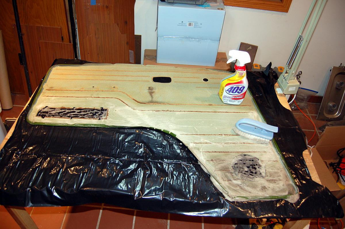

Reusing the OG vinyl
On to the vinyl. It was filthy from nearly 40 years of entropy. Nothing a good brush scrubbing with Formula 409 couldn't deal with!
In the end, the vinyl looked pretty re-useable.

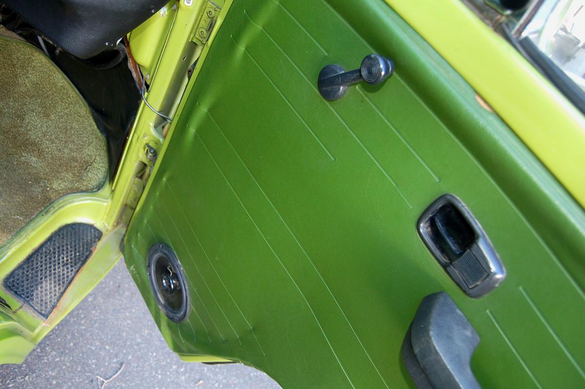

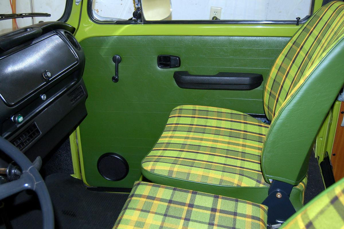

Installed!
So here you go. Left door. There's a couple small wrinkles in the upper corner, but they look much worse in the photo (darn flash) than in person. The armrest is the original one and showing its age, but I'll keep an eye out for a good repro or NOS replacement.
Inside view. Steering wheel still waiting for replacement (restorable one on shelf).
Right door. Not shabby, eh?
Inside view. That steering wheel though - ugh. Wink
A closeup of the aged speaker grille. These were both broken in multiple places with the speaker cloth loose and half-glued. Never know it to see it now!
Last words
I'm aware that these panels with the new foam inside have more of a puffy appearance than OG. It's not because the foam is too thick, and the OG panels used foam too, but the heat seams were originally pressed and stuck flat against the cards. This aspect couldn't be duplicated as there was no way to get an upholstery shop to both stretch the old vinyl back in place and glue down the seams. Believe me, I tried. The reflections from the camera flash makes them look puffier than they actually are, as the seams are still distinct. So you'll have to just trust me when I say in person it really does look good, and this is the OG vinyl! Very Happy
