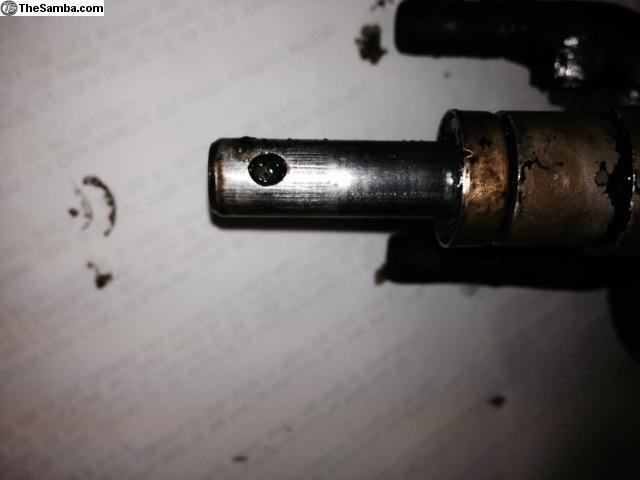

jsturtlebuggy wrote:
.. looks like they are the teeth off a brass syncro ring. ..
x2 Those are definitely tooth tips off a synchro ring. This is not common to see. Trans should be disassembled.
