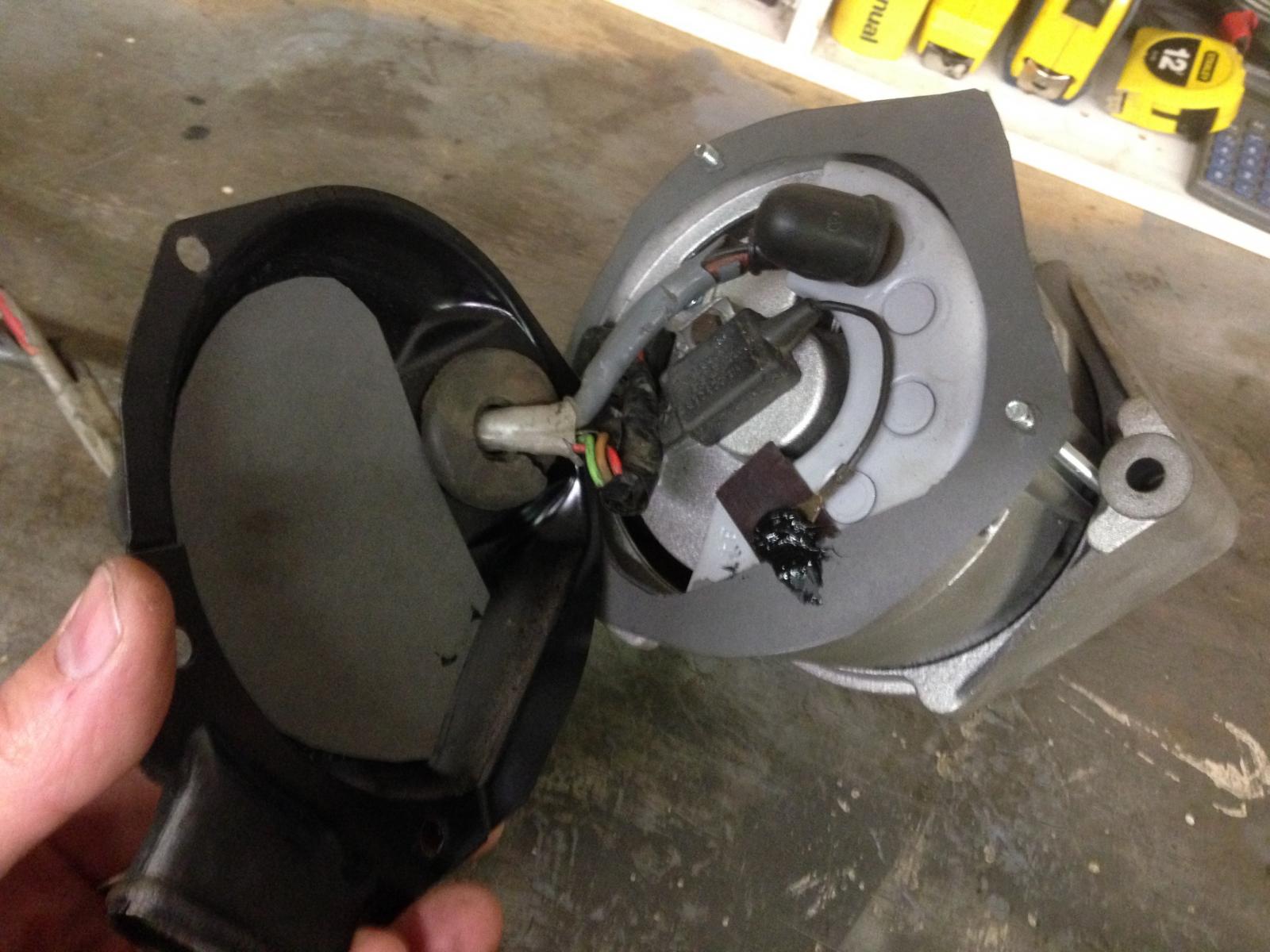

1967250s
Joined: May 02, 2007
Posts: 2137
1967250s is offline
PostPosted: Mon May 04, 2015 12:27 am    Post subject: Reply with quote
I' d try disconnecting the aux battery and see if you have same problem. Batteries could be issue, but many have lasted for years and started right up after sitting for long periods. More testing is required here.
PS, First!= did you check the inside of the alt back cover to make sure the long stud is not touching the cover, many threads on that problem.
Yeah, I cut off the long studs. I may have over done it a bit with the gaskets and such.

nerdhotrod
Joined: June 16, 2014
Posts: 49
Location: CT
nerdhotrod is offline
PostPosted: Mon May 04, 2015 9:25 am    Post subject: Reply with quote
Welp... I wish I would have seen this post before I replaced my alternator. I nearly burned my bus to the ground because of the stud contacting the backing plate.

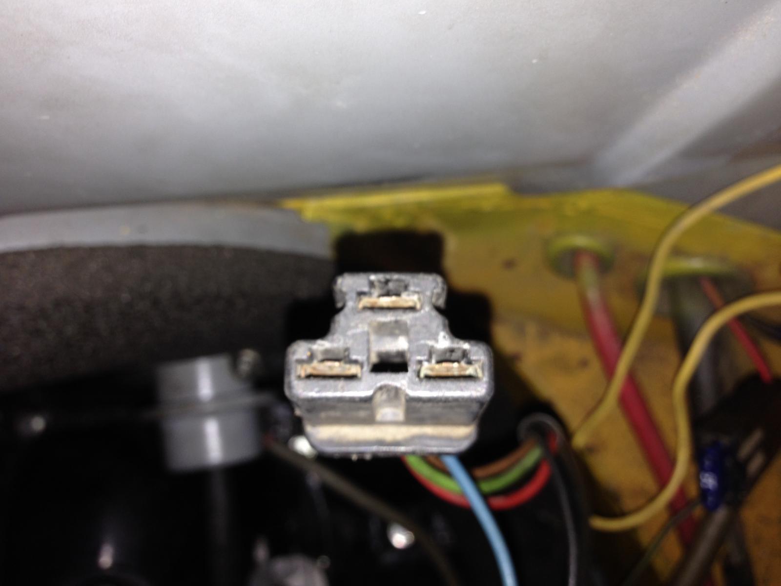

PostPosted: Mon May 11, 2015 11:10 am    Post subject: Reply with quote
UPDATE:
ok I went out there and tested the batteries again, and with the engine running the engine battery was not getting a charge either! (12.01)
So I sprayed the 3 prong connector that connects to the voltage regulator with electrical cleaner and then I started getting my batteries charged! So, I want to clean that connection really good.
How do i get the metal connectors out of the black plastic connector that plugs into the voltage regulator so that i can clean the connections?
It looks like there should be a tab somewhere to release the metal connectors and pull them out.
edit: I can post pics later if need be.

BusBerd
Joined: November 19, 2005
Posts: 842
Location: Minneapolis, MN
BusBerd is offline
PostPosted: Mon May 11, 2015 11:40 am    Post subject: Reply with quote
this is the black plastic thing I am trying to get the connectors out of so I can clean them:

BusBerd
Posts: 842
BusBerd is offline
PostPosted: Mon May 11, 2015 12:35 pm    Post subject: Reply with quote
UPDATE:
figured out how to pull the connectors out with this pic.
cleaned them. started the bus up. alt light was still on. revved the engine once and the light went out and batteries started charging. I don't know what to make of that.
