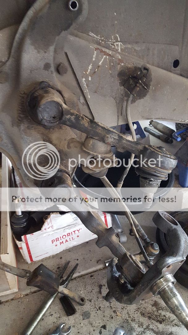

So instead of posting a new thread I figured I would post in here for ideas. So I got it mostly apart, however I cannot get the lower arm out of the knuckle. Ive tried a 2 jaw puller pickle fork and BFG. Lots of penetrating oil.. So now what could I try? I busted my knuckle pretty good. ALSO I have new arms and do not have a bently. Do I need to mark the old ones before I pull them? How do I install the new ones properly? THANKS!

PostPosted: Sun Jun 28, 2015 8:29 pm    Post subject: ball joint stuck Reply with quote
Before you get hurt anymore Razz Pull the speedo cable out and then pull
the trailing arm out of the beam and you will have better luck getting that ball joint out .
No Bentley? do you have a vice mounted on a table? that will help too since
that ball joint is looking pretty damaged.
You also need a long pipe to lift the Upper arm off the rubber stop so it can be removed AFTER you remove the clip.
Leave the grub screws IN UNTIL THE RUBBER STOPS ARE OUT
as for the eccentrics they also will need to pressed off and NOT damaged so you can put them on the exchange arms. NO bOOK Scares me. how about You Shocked

PostPosted: Mon Jun 29, 2015 8:35 am    Post subject: Re: ball joint stuck Reply with quote
Wait what are the grub screws?
What are the eccentrics? The new arms I got i believed to be complete.
I was too cheap to buy the bently and hoped I could find all my answers on the interwebs. This bus is expensive lol

If you're too cheap to buy Bentley, you may be too cheap to buy this:
But you can rent one. I use a ball joint puller, but since your boots are shot you could easily use this kind of puller to get that lower ball joint out and also your eccentrics stuck to your top ball joint.

PostPosted: Mon Jun 29, 2015 6:36 pm    Post subject: Re: Front torsion arm bushings Reply with quote

Bookmarked thanks, is the eccentric ring pressed on or removable with wrench? I have access to a press and tools from orileys. Im gonna take the knuckle off with the arm still in it so I can get a better angle on it.

PostPosted: Mon Jun 29, 2015 7:25 pm    Post subject: Reply with quote
They are just pressed on. My torsion arms came with new eccentrics. Mine came off pretty easy with the pitman arm puller I posted earlier.

PostPosted: Mon Jun 29, 2015 7:32 pm    Post subject: Re: Front torsion arm bushings Reply with quote
Does not thread on but is Usually rusted on and requires a puller or press to remove.

PostPosted: Tue Jun 30, 2015 9:27 am    Post subject: Reply with quote
We did this two? maybe three weeks ago...Pretty much, before we did anything...we just sprayed kroil in each of the knuckles where the ball joint went in, then tapped the bottom of the ball boint with a hammer, for two or three days. when we started dissasembly, the top ones came out pretty easy, the bottoms I had to whack with the pickle fork a few times... do you have the right sized fork?
I find kroil works where other penetrating oils wont.

PostPosted: Tue Jun 30, 2015 11:38 am    Post subject: Reply with quote
i am using Kroil, I have a small pickle fork and may need a bigger one.
Thanks for all the help and tips I am gong to work on it some more today. Im gonna check my new arms to see if the ring came on those.

PostPosted: Tue Jun 30, 2015 12:58 pm    Post subject: Reply with quote
Yep, if your pickle fork isnt tall enough in profile, it wont provide the leverage to pop the joint off. I think i ended up using both of the ones i had.
