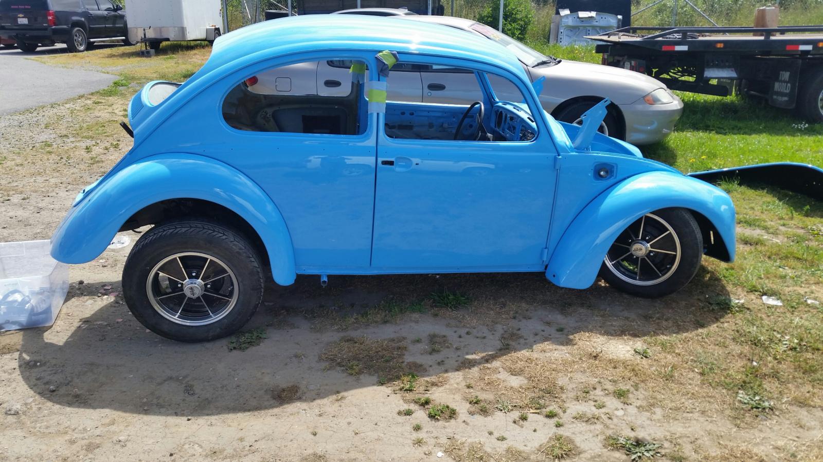

All black interior with scat procar low back seats. I've got an original empi gtv steering wheel.
and here's the wheels. Motor isn't in yet and I've got dropped spindles and a beam. Was messing around and dropped the beam almost all the way down to see how low it would go. Too low like that, just wanted to see.
Motor is 2276 with Steve Long XR310 cam. Waiting on tin to get done powder coating. Breather tower has since been sent out to get tapped for AN fittings. One breather to fuel pump block off and one line to the passenger side valve cover. Original german cylinder tins...aftermarket doghouse shroud that has been internally modified and had a venture ring added.

Yeah, I'm keeping a nose down rake stance....just not quite this low. I kept all the body trim and I've got German running boards with the chrome strip on them. Other than that, no chrome. All business. The engine tin is getting powdercoated a black hammer finish right now. Breather tower is getting drilled and tapped for AN 8 fittings. It will have a line going to a stainless off road breather element that will be mounted high and to the right on the firewall. away from the shroud.
Thanks for the compliment....I'm going for a plain, clean look. Classic.

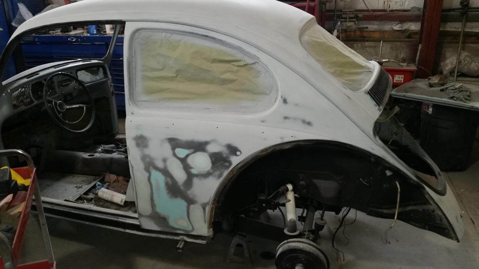

yeah, man. I didn't mean it like that. Just messin. Anyway....found some problems with the body and paint work. Body shop is owning up to it and its going back to them for some fixes. Man, this thing is taking forever to complete.
