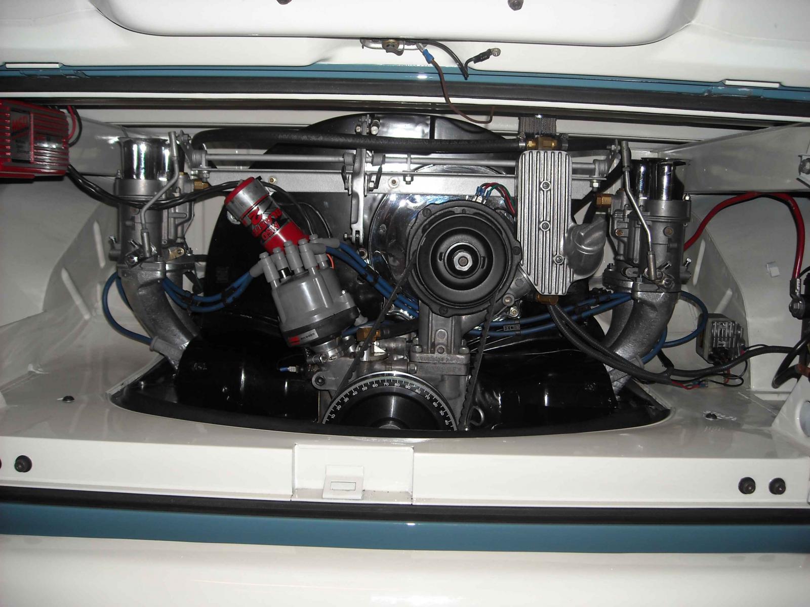

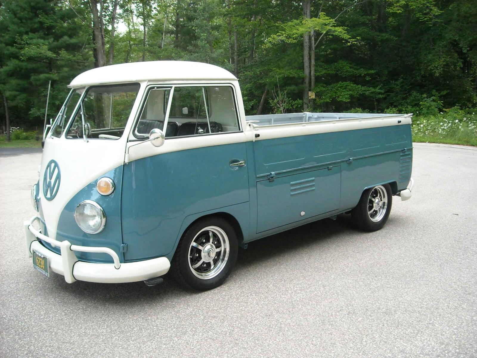

Here's a couple of pics of my 63 Single Cab. I did all the work except the body/paint work. Suspension changes include Wide 5 spindles, Wolfgang IRS kit, "built" gearbox that started as a '72 IRS beetle gearbox but now has a Weedle super-diff, 4.125 R&P, 3.78/2.06/1.32/.93 gearing and HD covers, Type 2 CV's and Wolfgang axles. Rolls on after-market Sprints.
Power comes from a 2332cc combo that includes 4340 crank, H-beam 5.500" rods, CB Performance Super Pro CNC 44x37 heads, IDA's, FK10 cam, 10.3 to 1 compression, and a one-off Al's Headers side exit 1 5/8" merged exhaust and stainless chamber-style muffler.

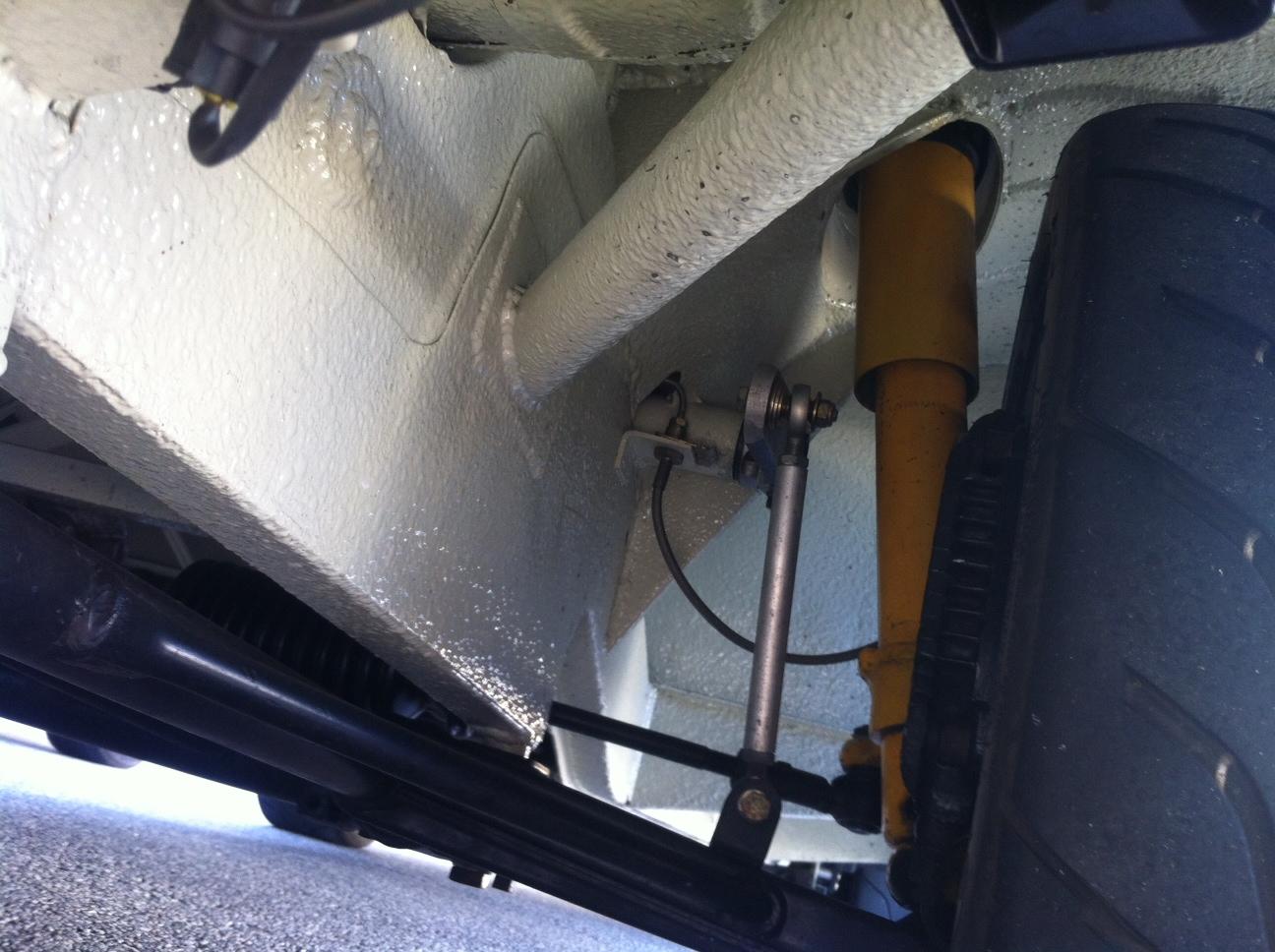

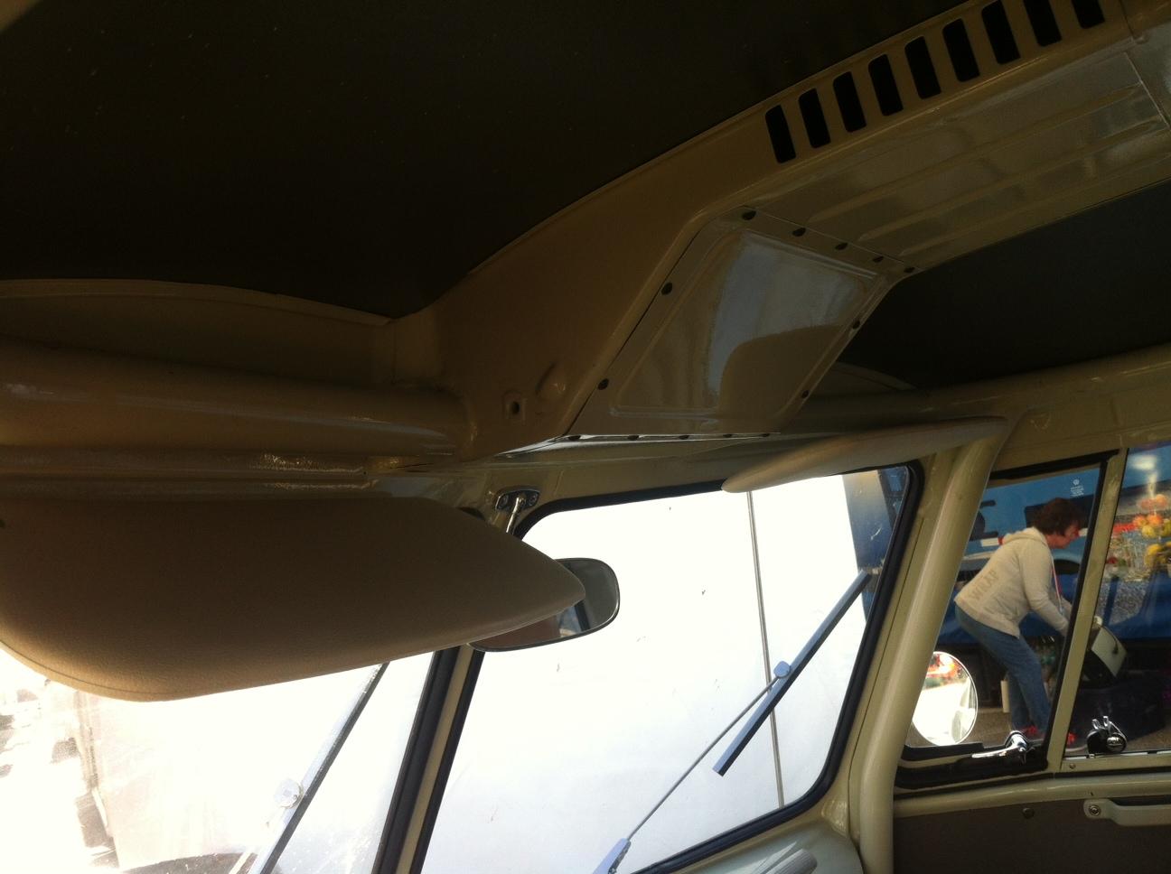

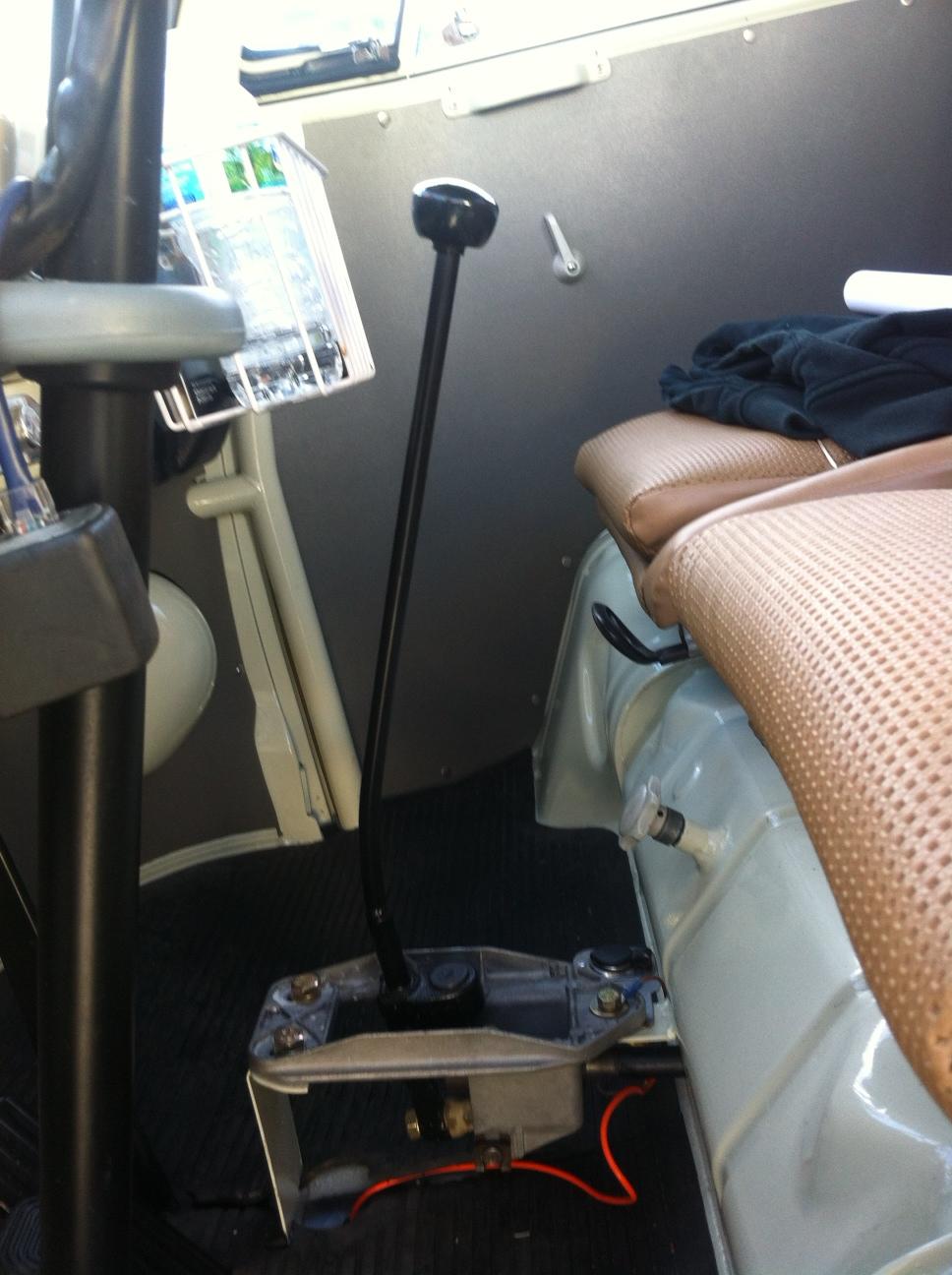

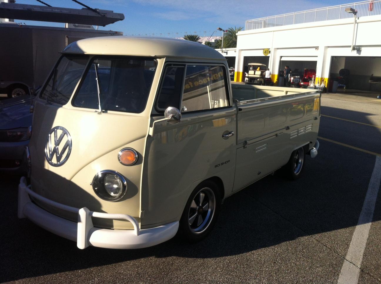

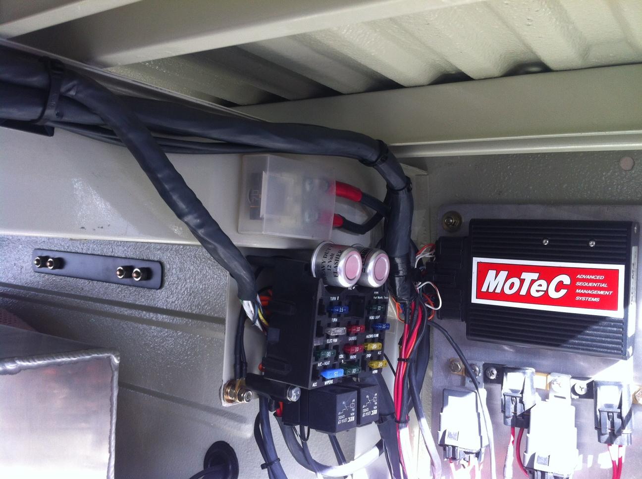

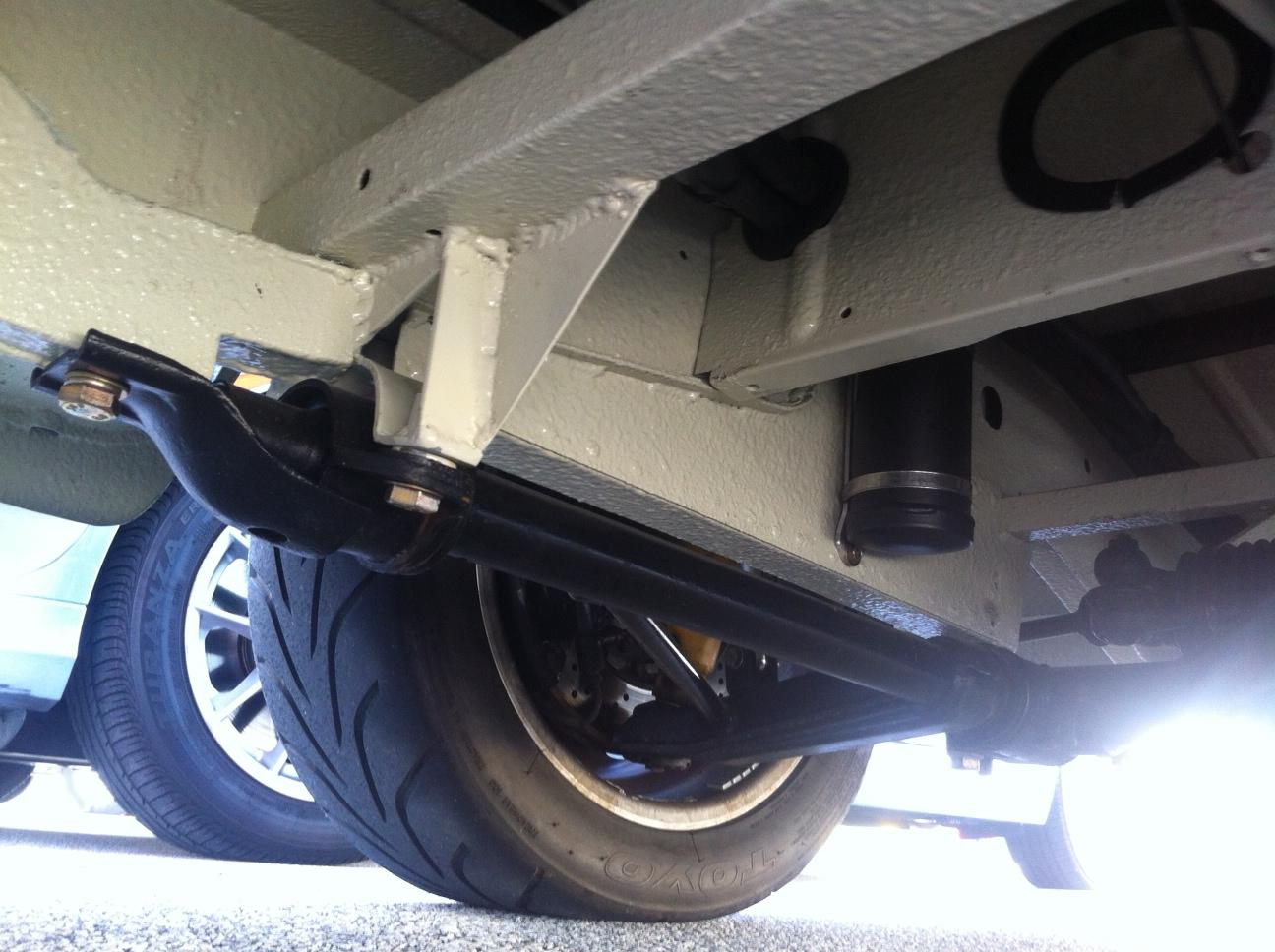

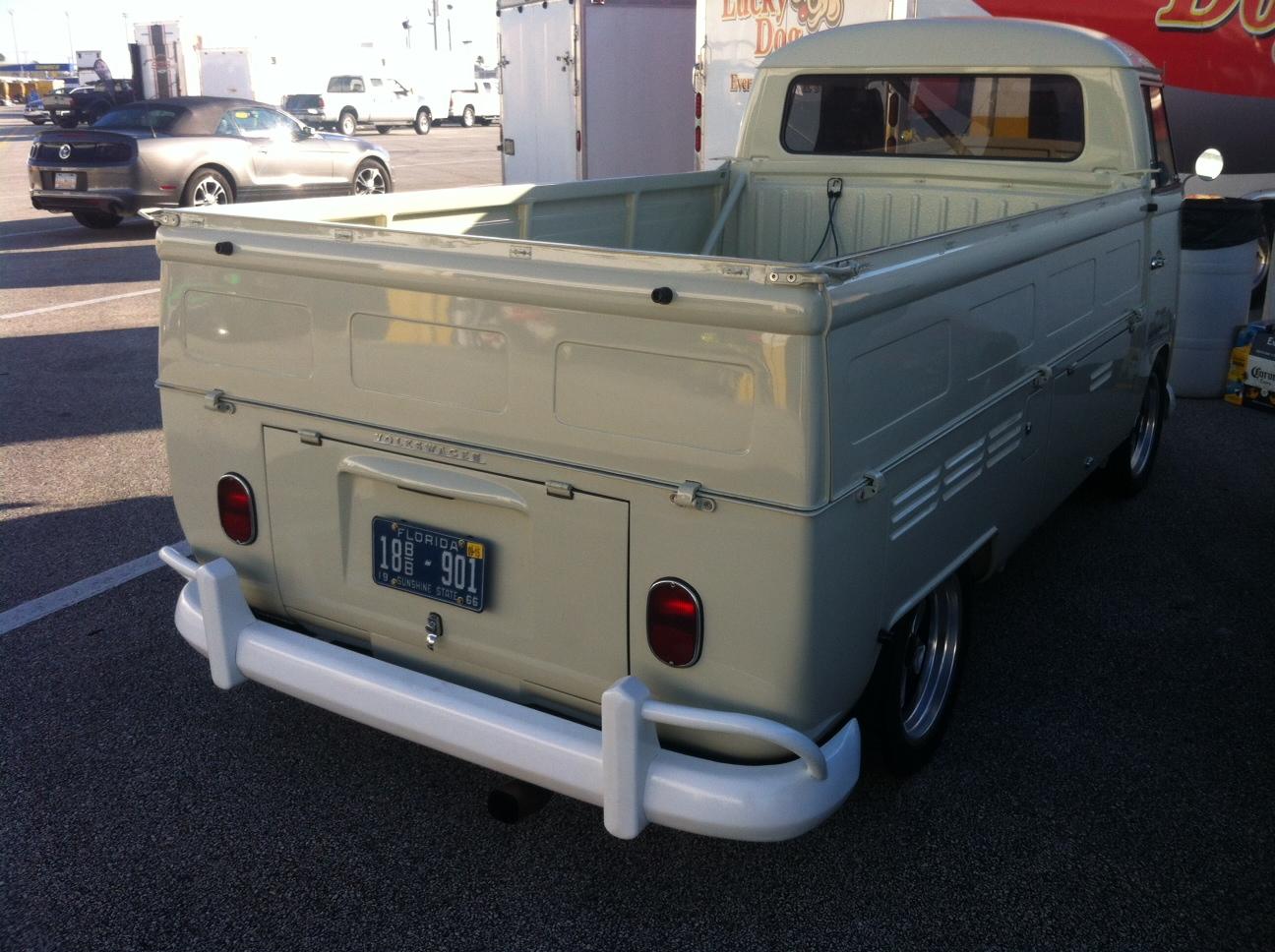

Here are some photos of the L87 pearl white 1966 Porsche 3.6 powered single cab above. Like Greg mentioned it was on page 3 or 4 earlier on in this thread. The truck was built and put on the road for a short time then pulled completely apart and restored. It's powered by a 3.6 twin plugged 964 engine with a short nosed G50 5 speed and turbo brakes. It weighs in around 2600lbs. As you might imagine, its FAST!

67dubcab wrote:
That s.c 3.6 is looking good....
I noticed the front strut under the seat, would be great to see the suspension set-up, or a link to a build thread if there is one. Very Happy
Also nice to see some details of the roll cage, I like the bar going through the vent, pondering that option myself, as running the bar below cuts off some of the front vis, though I am not sure I want to lose the vent function.

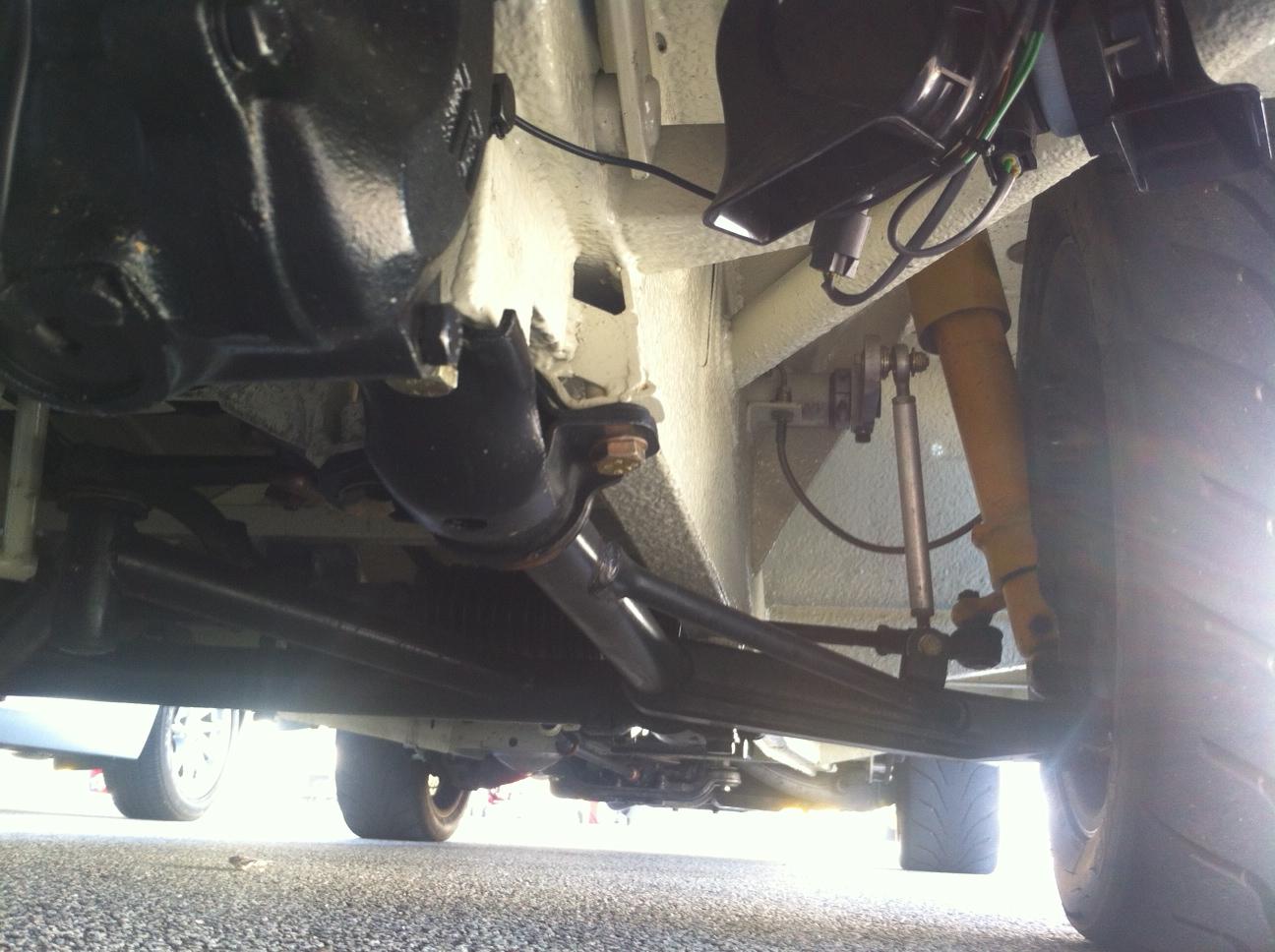

Yes, it has struts up front. I forgot to mention but the front end uses 911 control arms, struts, etc. and the rear has a torsion tube from an 87-88 Carrera with 911 control arms, sway bars, etc. It's basically all Porsche parts underneath. The upper vent has been deleted as it now has fully functional a/c so it's not really needed. I used to have photos from early on in the build but I lost them when my old macbook's hard drive took a dump. As far as I know there was no build thread, it took about 6 years for this thing to get finished. I'll see if I can get some better photos to post from the owner. It belongs to a friend who I used to work for full time before I opened my own shop. I'm just posting photos b/c I know you guys will appreciate them.

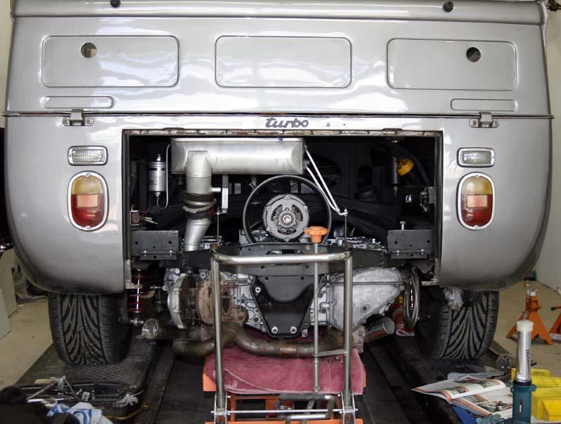

930 3.3 turbo test fit.

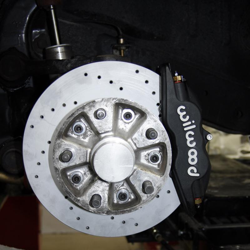

Front brake up grade. 911 vented & slotted rotors and a larger Wilwood calipers.

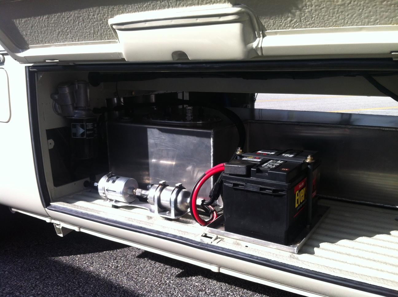

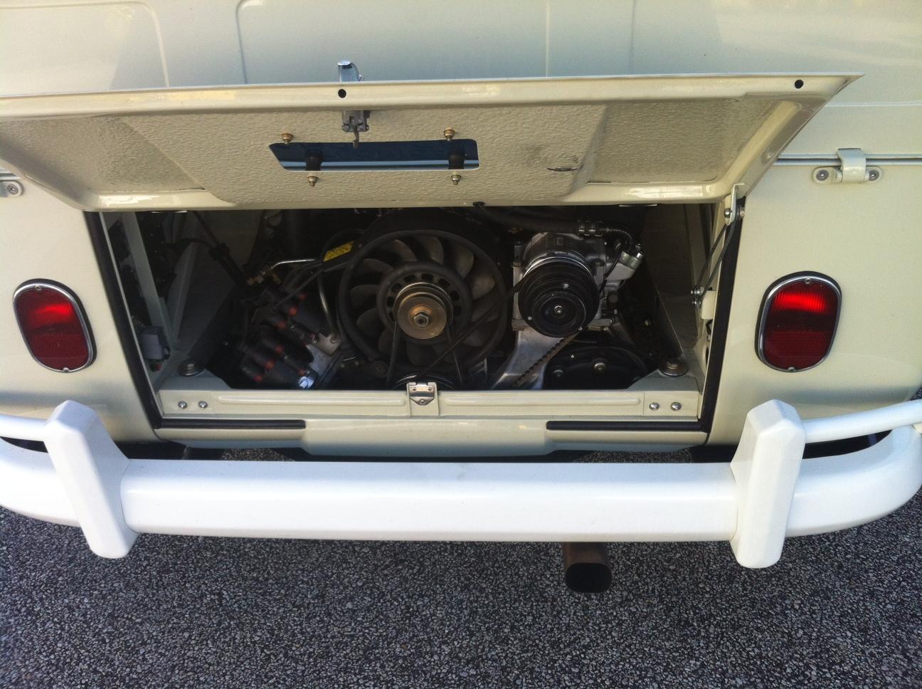

The bus should be up and running in early July. Working on the engine bay. Had a custom intercooler made that will fit into the divider wall at the front of the motor for better airflow.

Our '75 Carrera race car originally came with S4 front calipers & Turbo 2 rear calipers (they are slightly bigger than the 930 rear calipers). I found it to be pretty unbalanced, too much front bias. I got rid of the set up and went back to 930 calipers. To get the balance right in the dc you should consider a dual master set up with front/rear adjuster, just my .02.
