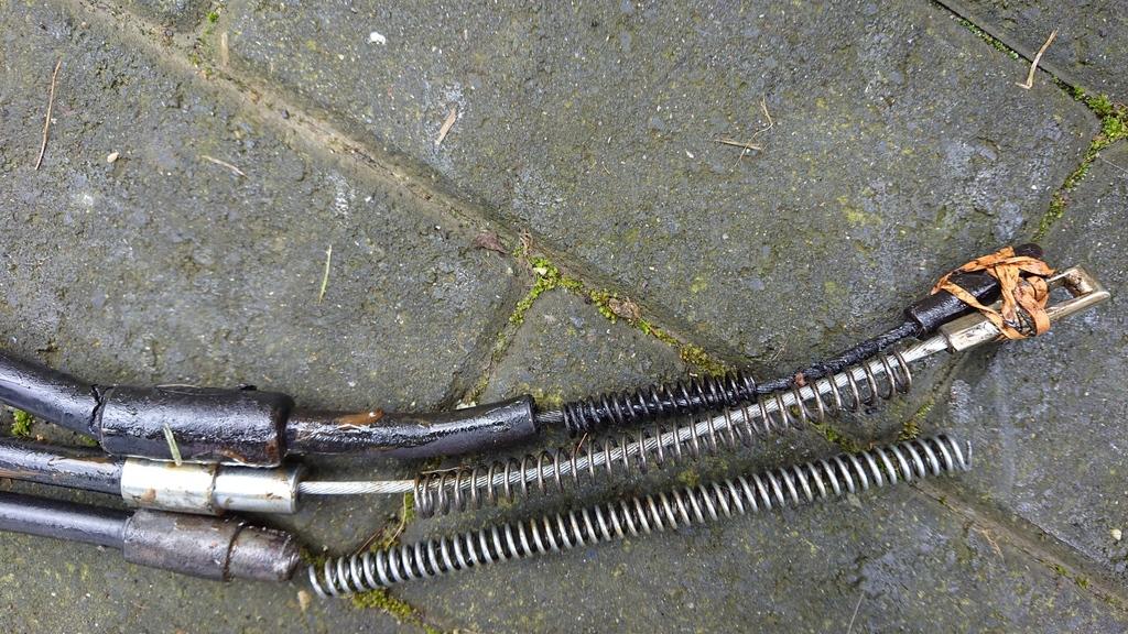

I have a different twist to this problem. I'm in the process of replacing cut-down late-style cables that I fitted to my '56 single cab which has a big nut transmission. I did that 'fix' a few years ago to get the truck on the road, but I had to cut the cable ends in situ and ended up with unequal length cables and uneven handbrake pressure. I'm re-doing a leaking bearing seal, so I've decided to fit new early cables and use Camerod's idea to extend them at the cab end with connecting nuts and all-thread.
The strange issue I have is the bowden tubes and springs on the 'early style' cables that I sourced are different to the one original which I never threw away, and different to the late-style that I've just removed.
Top is the original early-style. Middle is the new 'early style'. Bottom is the bowden tube and spring from the late style...
The cables in the original and new early-style are the same but the bowden tube ends and springs are different. The 'snout' is missing from the bowden tube on the new one and it has a longer spring to make up the difference. This means that it fits well in the big-nut backing plate, but the spring is too short (compare it to the late style spring in the above).
My intended solution is to get another short spring to make up the length difference and extend the new 'early style' spring to the same length as the later style spring, which fits my big nut backing plates.
Does that seem sensible or am I setting myself up to fail? Is there another solution? I've already tried winding the late-style spring on to the new early-style cable in place of the supplied spring, but the late-style spring's coil is too tight

That's pretty much what I've just taken out. I couldn't find any guidance on how long the cables should be for early handbrake with late transmission though, so had to I cut them insitu. I fitted 'swageless compression wire rope stud thread terminals', but ended up with unequal lengths so the balance bar was cocked and I only had full hand brake on one wheel.
I figure that extending the now-too-short early cables is easier and more accurate.
You would cut the later cables so as to come out to the same length as the early cables.
Wouldn't they then be too short? That's the problem with the early cables.
They should not come out too short. Rear axle is same distance back and the parking brake lever inside the drums is not farther back. Are the boden tube sections same length from front to the place they seat against the backing plate?
The later cables are longer to reach the later style handbrake adjuster which is up inside the cab on the handbrake handle.
Exactly, so if shortened to same as the early cables they should work fine. As long as the early and late brake cable boden tubes are the same length.

Eric&Barb wrote:
I think you're wrong here. I'm in the middle of one of these right now with 6 Volt.
The early cables do not fit the big nut backing plates correctly and do not have the proper length return springs inside the drum. The location/arrangement of the park lever on the rear shoe and backing plate is different changing the location of everything in the drum. This causes the cable casing (you're calling this the Bowden tube?) to be too long and looping too high above the spring plate. The early cables have a long protrusion on the cable casing (see above pics) where it goes through the backing plate, and the BN cables don't have this. This protrusion is also the wrong diameter (too small) to fit properly in the big nut backing plate. We ended up cutting/shortening the cable casing to make it look right and putting a longer return spring on the cable inside the drum and it still didn't turn out right. My gut instinct is to start with big nut cables (that fit the drum/shoe/backing plate/rear of bus) and modify the front (cut to length). We did this originally and all would have been perfect except the job shop who installed the swaged ends didn't do a good job and it blew the ends off the first time we applied the parking brake.
I should have taken pictures that day to show all of the various issues but we were hurried.
In short, if you put early cables on a big nut trans, the whole drum area doesn't fit right:
-The early "Bowden tubes" are longer, causing them to loop upward funny above the spring plate from too much slack.
-The distance between the Bowden Tube and the end of the cable is different, which means a shorter return spring.
-The end of the Bowden Tube where it enters the backing plate is not only smaller but shaped differently. It kind of wobbles around in a BN backing plate.
If you look closely at WhoMe's pictures you can see most of this.

Yes, referring to the tube with the steel wound inside it like a clutch boden tube as a kind of boden tube. Because it does much the same as a clutch boden tube being it is designed to not collapse lengthwise, but instead of clutch it is for the parking brake cable.
Yes, understand the early cables do not fit in the 1964-67 brake system, but that is why we are suggesting not using the early cables. Instead suggesting to just shorten the 1964-67 cables to early cable lengths.
The only question to double check to make sure, is the early and late parking brake boden tubes the same length from body to mounting point in the brake drum? Not asking about how far inside the early parking brake tube sticks into the drum area. The body to brake backing plate is the only dimension that could be a change that would make the over all length length of the later cables to fit incorrectly to the front parking brake lever once installed.
The effective length of early vs. late cable is not/cannot be the same because when we installed the early brake cable on his BN axle the Bowden Tube arched up very high above the spring plate compared to what's normal for a '67 cable on a big nut trans. I measured this and I think it was about 2" or so longer on the early tube IIRC.
Exactly, that was the question concerning the bowden tube length.
Then that "about 2 inch" (about 50mm) would need to be minused off the correct early cable length. Then the 1964-67 cable would need to be cut that much shorter than the stock early cable.

PostPosted: Sat Mar 09, 2019 4:02 pm    Post subject: Re: Which handbrake cable... 66 rear end on a 60 Reply with quote
More than that, the real issue is where the adjusters are. Late busses are above the floor, early busses are below the floor. That alone accounts for several inches.
