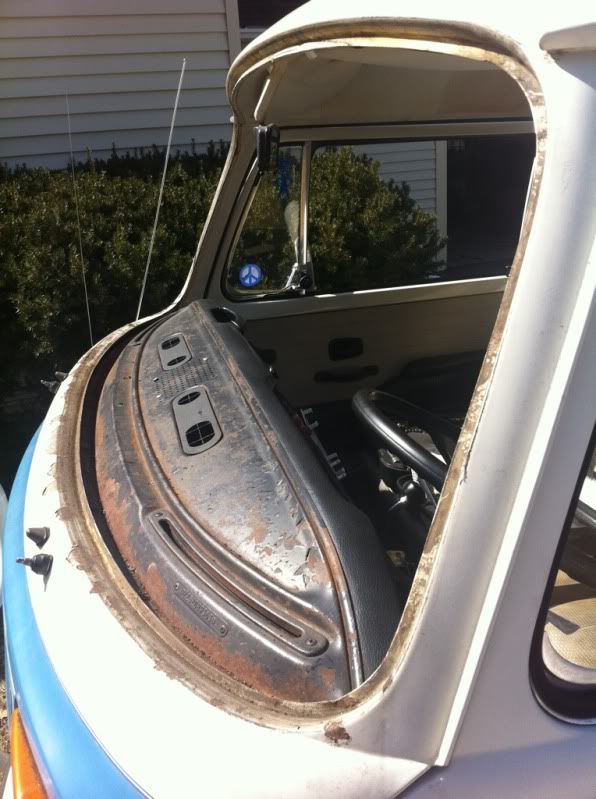

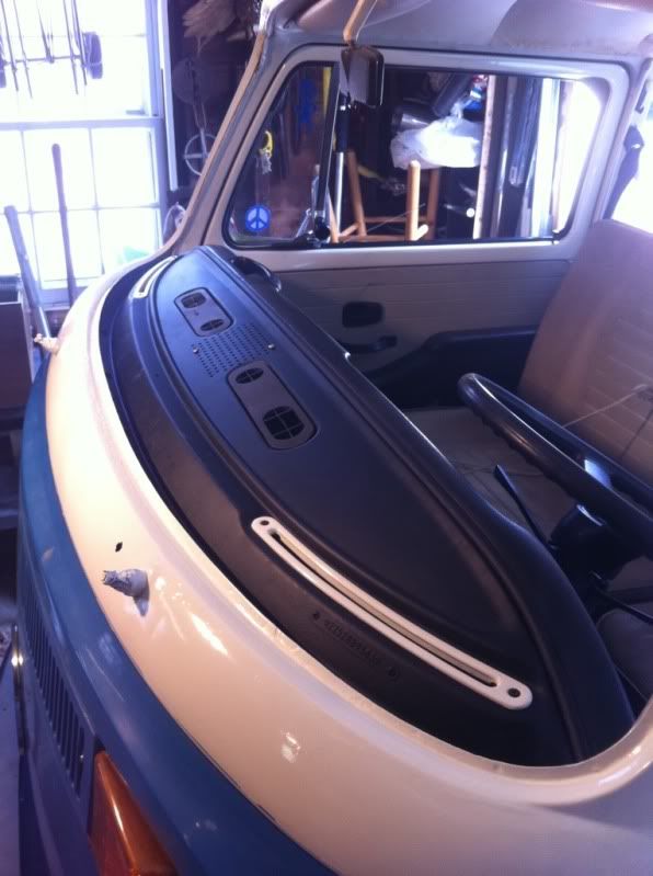

I recently painted the windshield lip with Rustoleum "Canvas White" and it was almost a perfect match to the original VW "Pastel White". The metal part of the dash I sprayed with the standard Flat Black and that actually was a perfect match
Before:
After: (In the sun you can't tell the difference)
