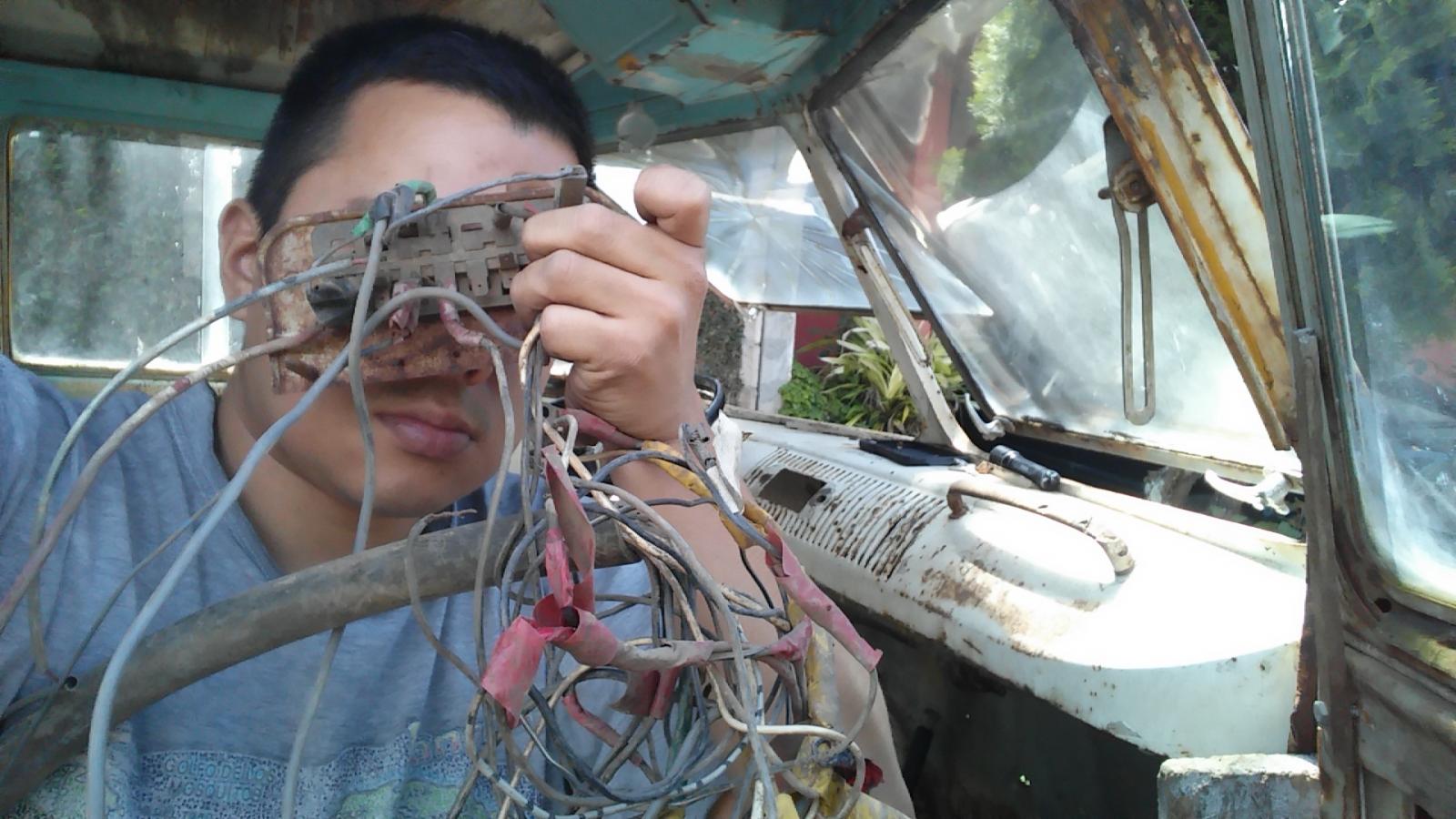

After a couple of years rebuilding mechanical stuff, is moment of the electrical system rebuild.
Since every wire in the DC was hacked or destroyed, I decided to rebuild everything from zero.
First, I removed the remaining switches, odometer and the wiring harness, cleaned everything and bought missing parts ( tail light bases, turn signal bases, wiper switch, ignition switch, etc.)

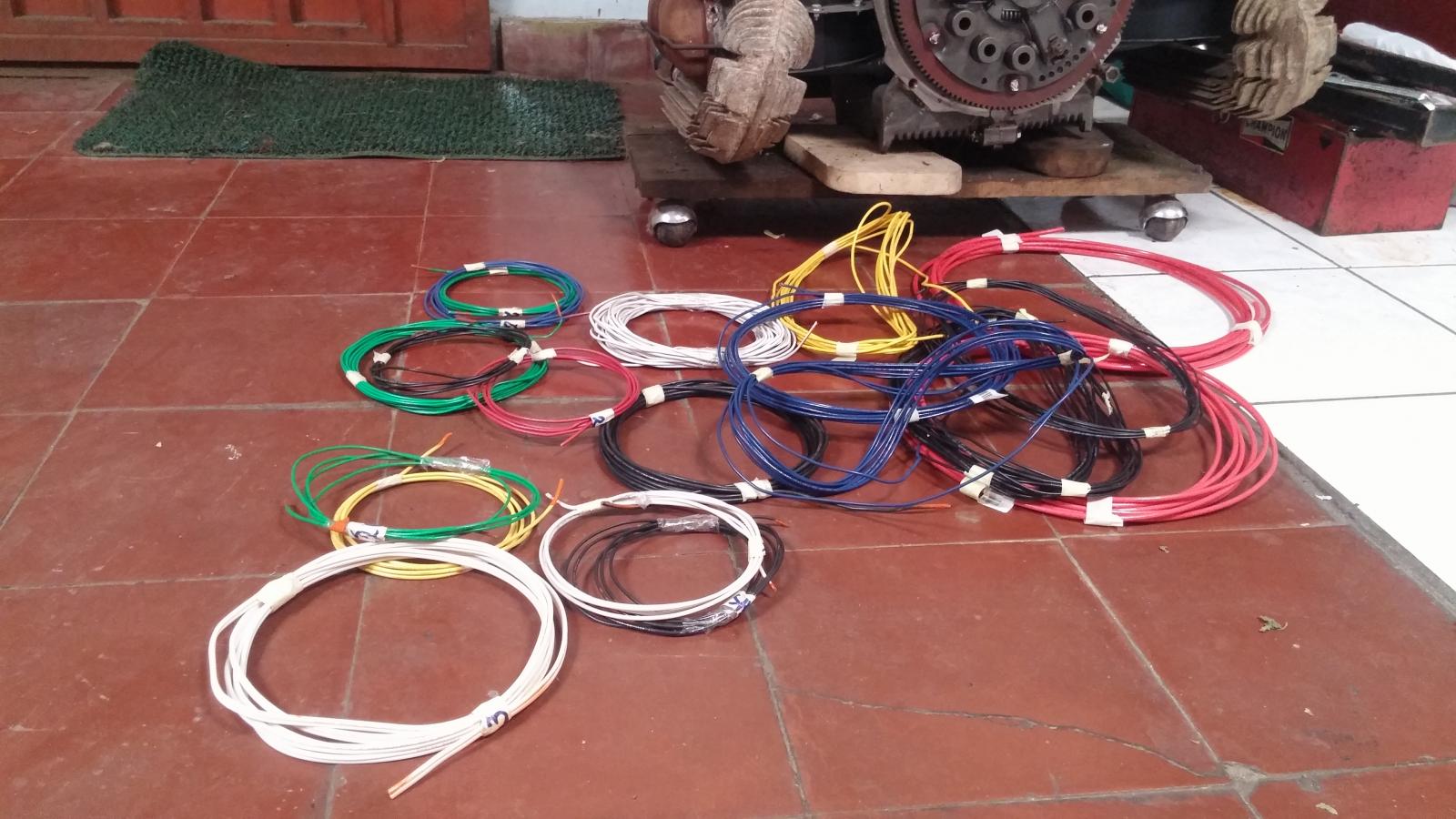

After a long research, and due to the impossibility to get a new harness with the correct wiring colours, I decided to use and combine all the colours and wire sizes availables. Also decided to make 2 wiring clusters of 7 meters each one.
In cluster 1 are the following wires: the B+ from battery, thachometer signal, Ignition signal, starter signal, oil and charge signals.
In cluster 2 are the following wires: brake signal from MC, right tail light, left tail light, right turn signal, left turn signal, back up lights
Making the wiring clusters:

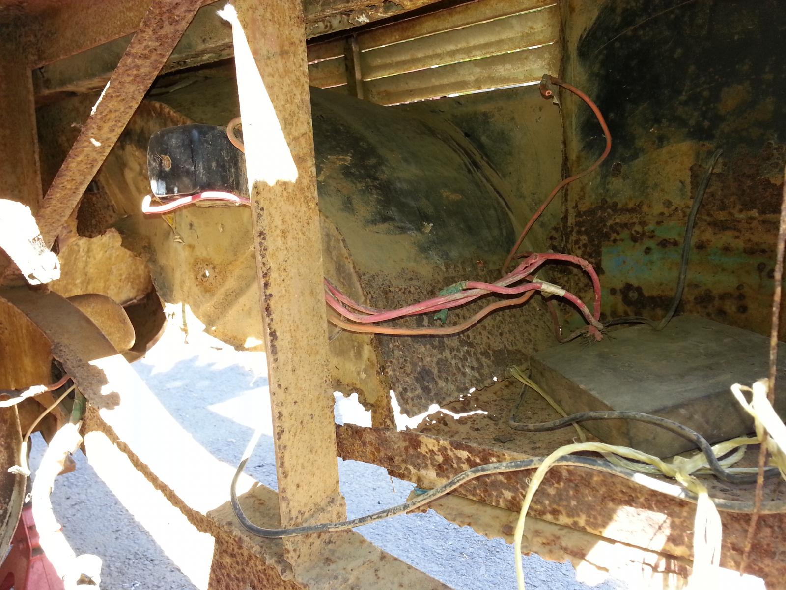

Instalation of the the wiring harness:
First wired the ignition switch, B+ to light switch and idiot lights in odometer.
Today, I made the turn signal system using a 3 position lever and a 2 prong flasher. At first, there was not any light blinking because I mistakenly ran B+ from switch to the light in the odometer and then to the flasher. The right thing was: B+ to the bulb core (there is a connector above in the odometer frame) and the contact at the center of the bulb goes to the flasher.
The DC has the front turn signals working =D
