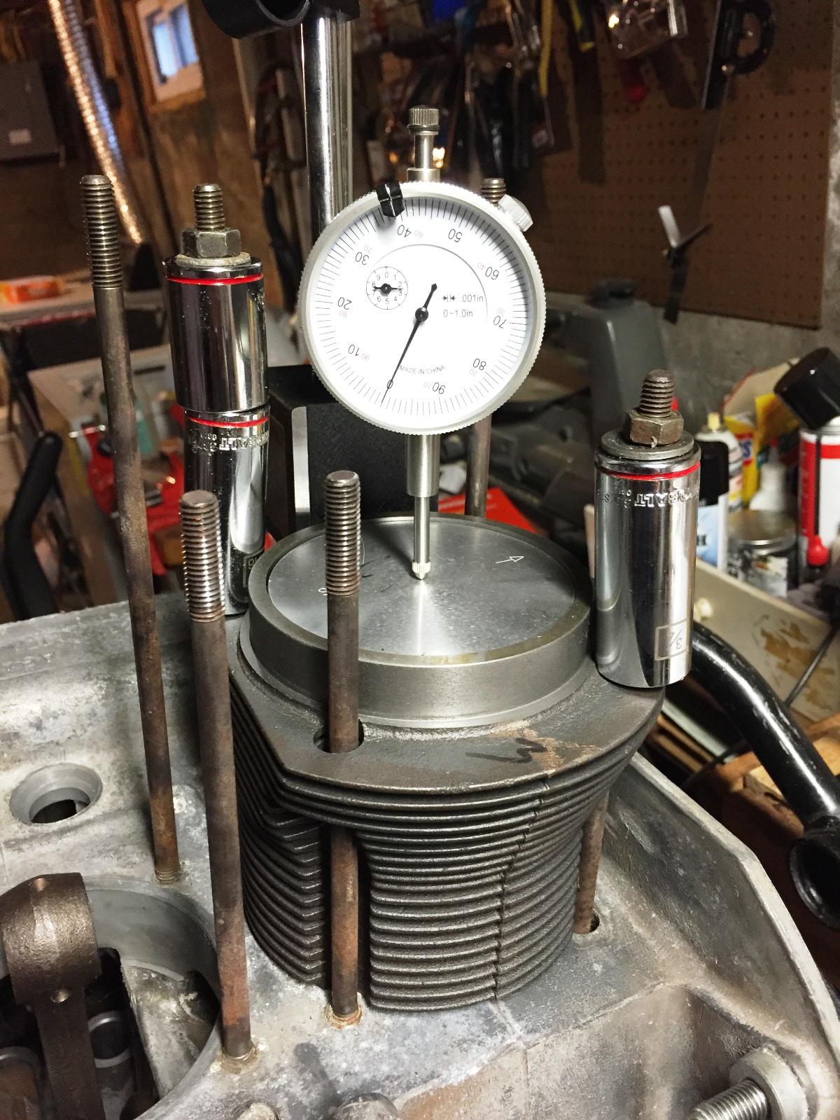

OK, So I checked my deck height last night using some sockets to hold down the cylinders.
New Deck Height Numbers:
#1: .059"
#2: .055"
#3: .059"
#4: .056"
So while there was a difference, it was more on the order of 1-2 thou than something super substantial. But I'm glad I checked. Now I've used CB's engine calculator to get that my heads should be taken from ~59cc as advertised on ACN to 51cc for my 8:1 compression. I'll be bringing the heads by a machinist today to see if they'd be interested in the work.

No, you shouldn't need to do anything, but on higher lift cams, flycutting the heads significant amounts requires careful checking of valve to piston clearance.
The other option is putting in a stroker crank! Then you don't need to flycut the heads. A quick calculation shows that a 78mm crank would put you at exactly 8:1 on the lowest cylinder.
As I was calculating the deck height and compression on my engine and how much I needed to reduce the compression chambers, I realized that I was dealing with all the headache of building a stroker engine without getting any of the benefit of added displacement.
Depending on the machine shop and how well equipped they are to do the job, you may wind up paying them close what it cost for a new crank.
Something to consider.

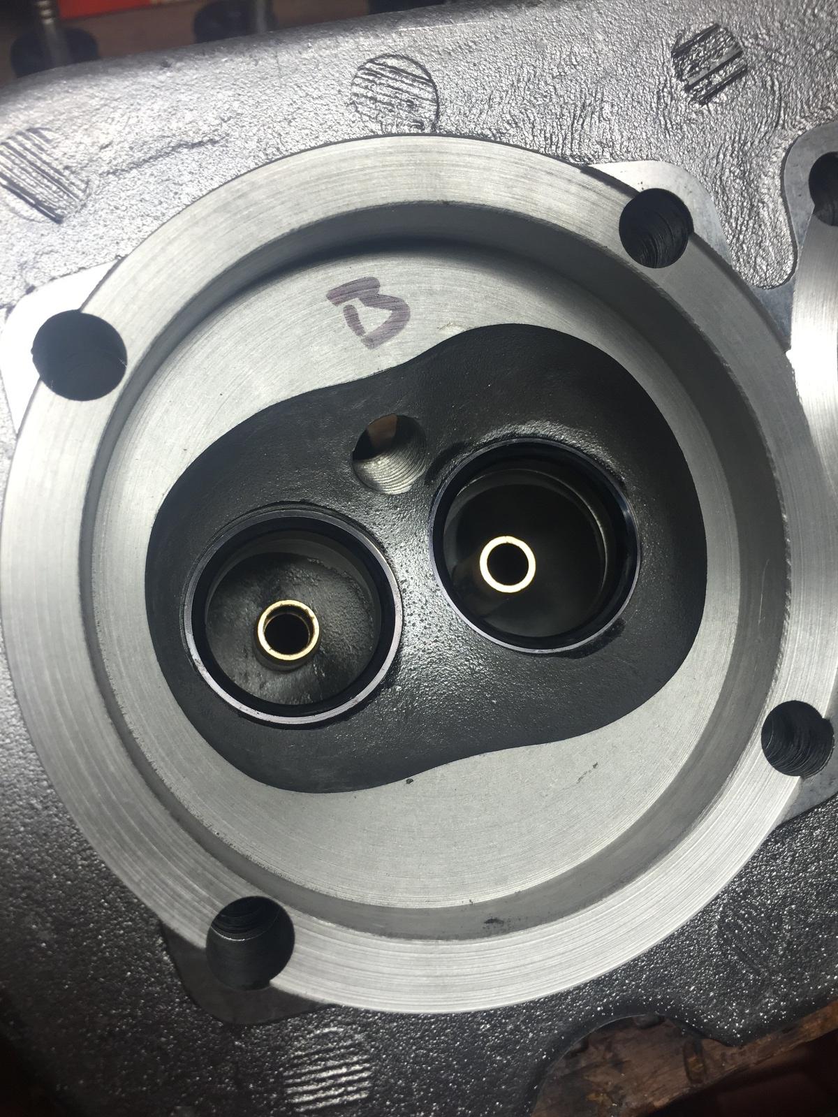

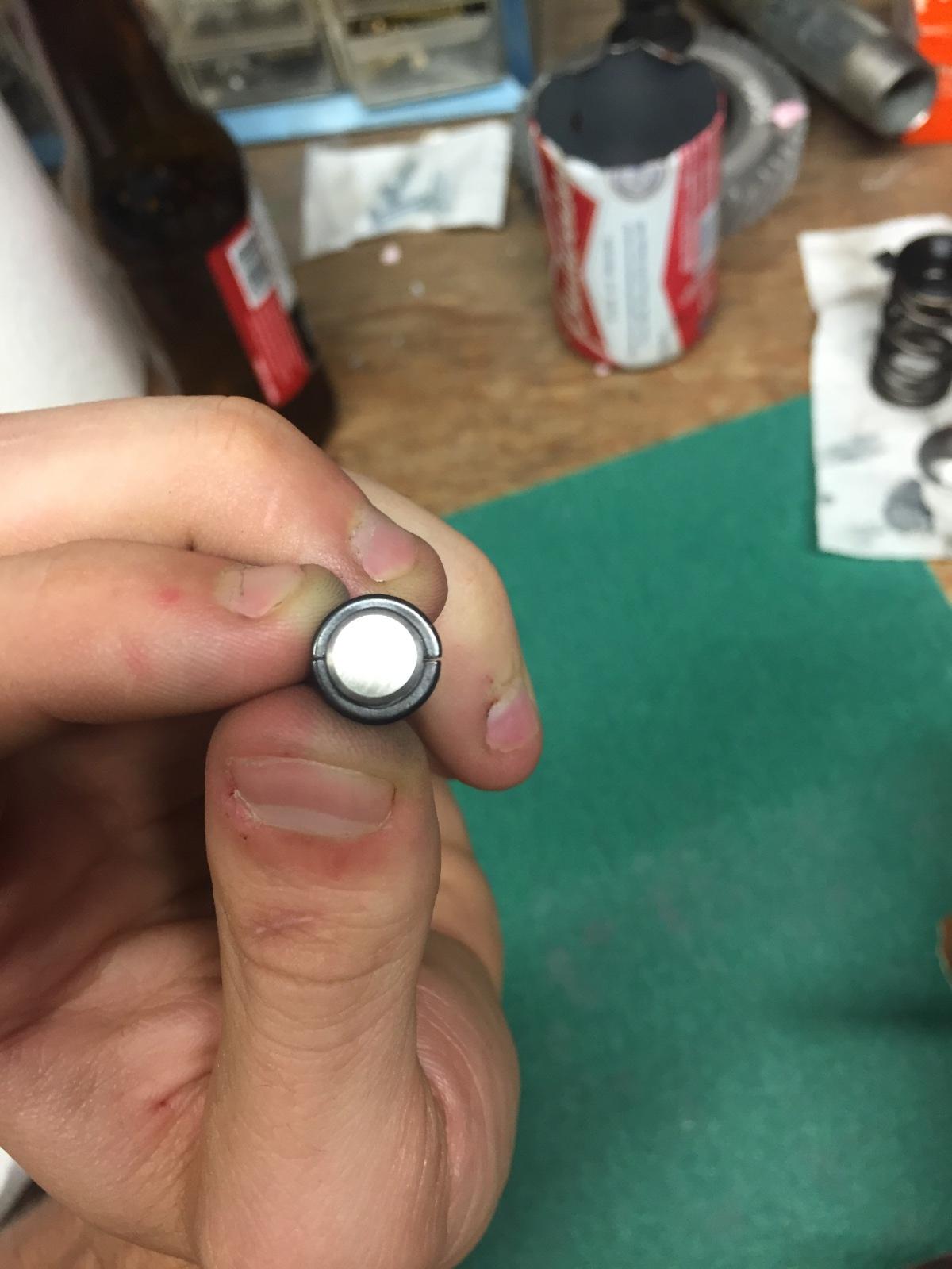

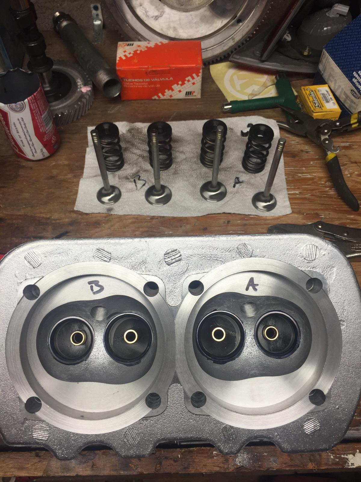

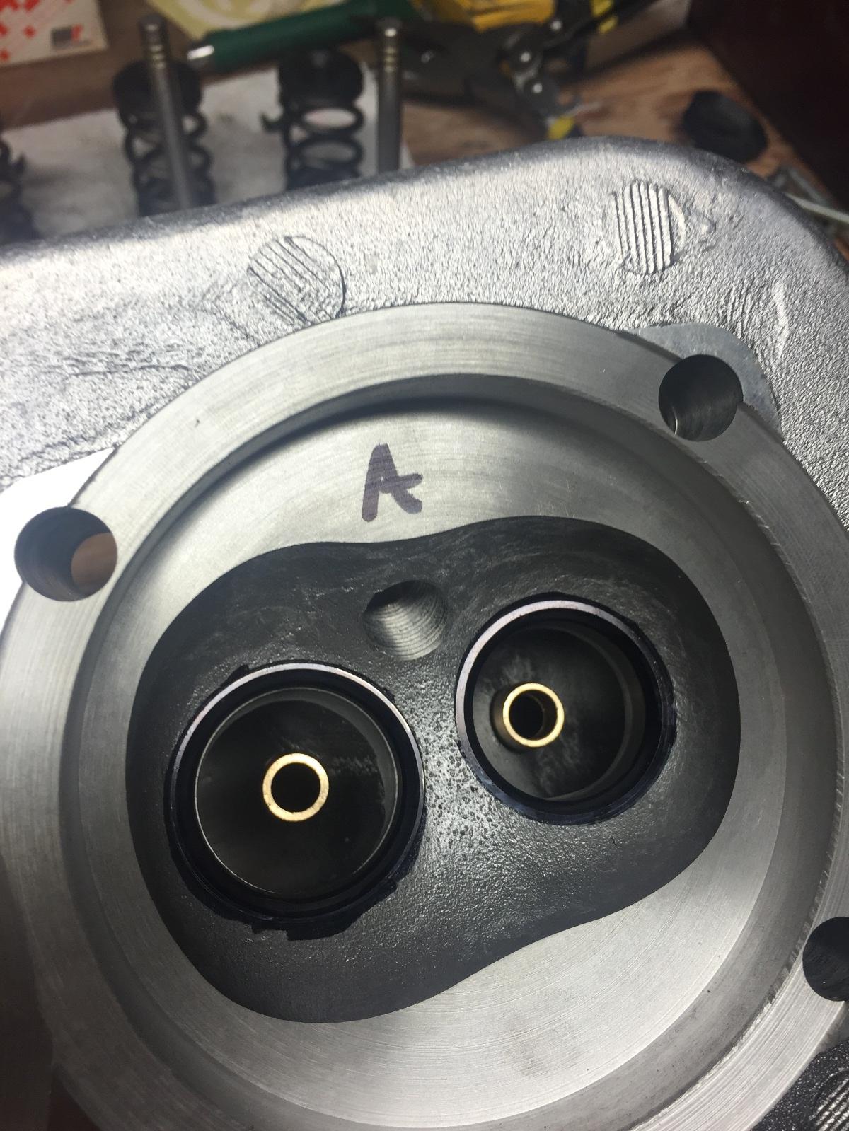

OK, got my heads back from ACN, and the machine work looks good! Spent some time last week working on them.
Took out the valves:
Tried using permanent marker for a Dykem substitute, didn't work:
Lapped the valves in:
Sanded down my valve retainers to hold the stem tightly:
Sanded til I could see daylight between the retainers:
I don't really have the tools to fluff and buff the heads or check the displacement but the machine work looks consistent and the prep on the valves while I was taking the heads apart looked thorough.
Any further suggestions on a newbie checking out his heads before I clean and grease everything back up and get ready to assemble the long block?

PostPosted: Mon Jun 15, 2015 1:48 pm    Post subject: Reply with quote
You dont need dykem for checking valve seating - what you are really looking for is the matte gray where the valve and seat have been lapped together, a solid ring of gray on each part....

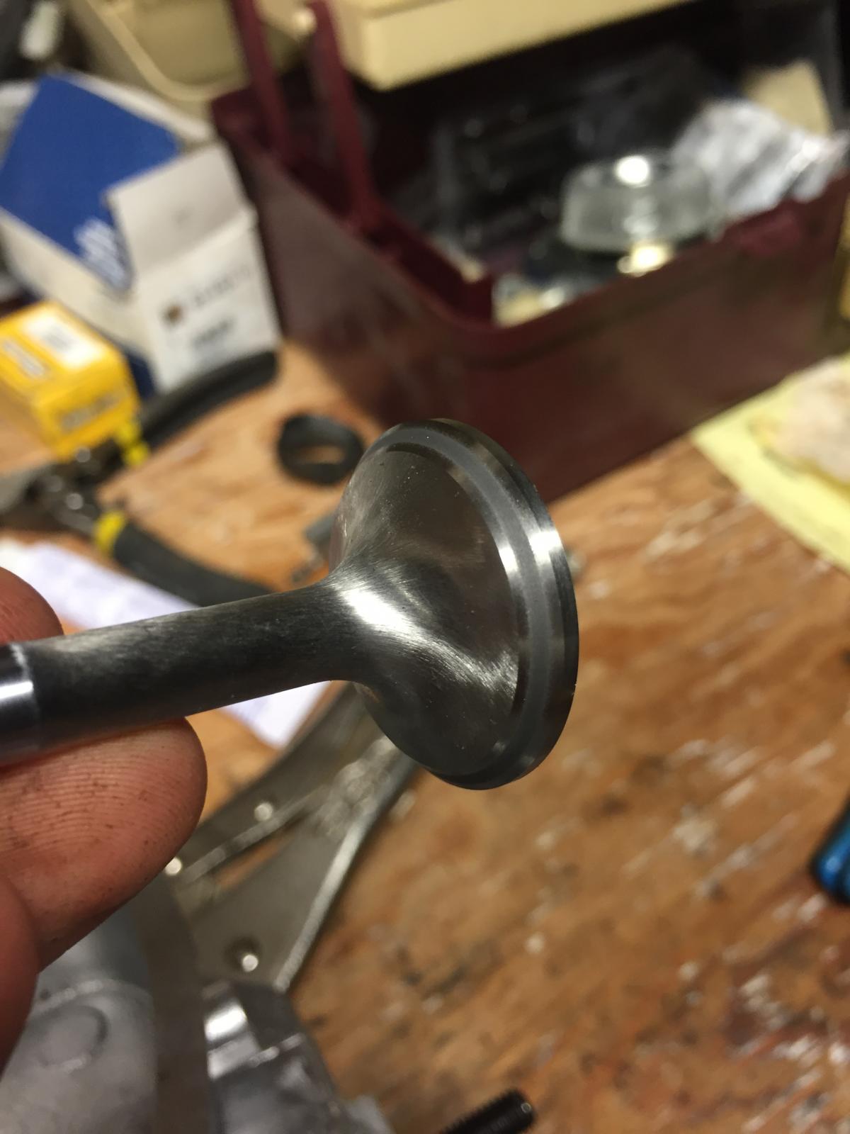

PostPosted: Thu Jun 18, 2015 7:11 am    Post subject: Reply with quote
Ok Great. So the valves already came with that dull ring on them but I guess they've just been double-lapped.
See what you think:
So like I said, the work on the heads looks good, I'll not be doing any fluff-and-buff work and I don't think I'll be doing much with match-porting the heads to the intakes. Maybe when I go for my next engine Wink

PostPosted: Thu Jun 18, 2015 11:09 am    Post subject: Reply with quote
^^^ that's exactly what you want to see (seats too)
