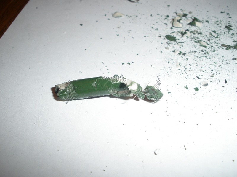

Couldn't source one locally at a yard, so I'm rebuilding mine. Since it's a bimetallic element, which just needs heat to operate the valve, and it can accept 12v, I figure I can rebuild it with some resistance wire.
OK, so I crushed my existing one and found that's how it was built. Resistance wire wrapped around a porcelain insulator.

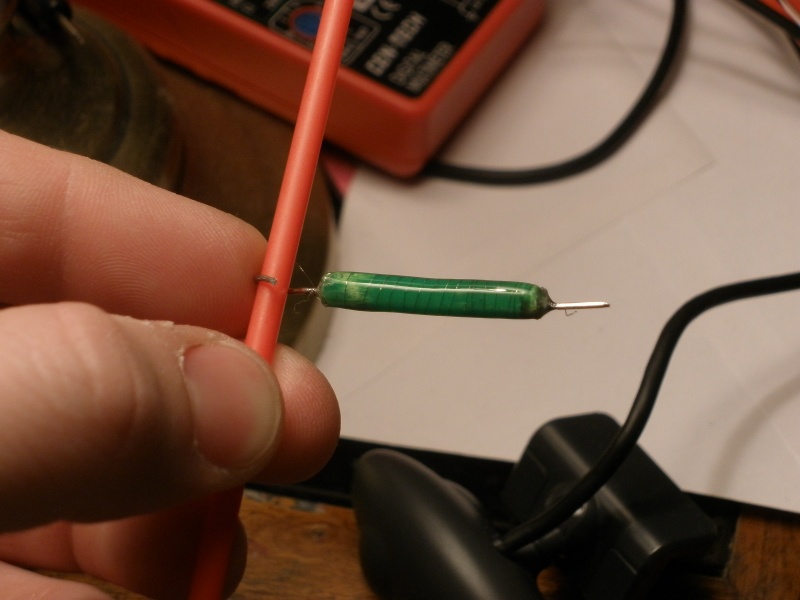

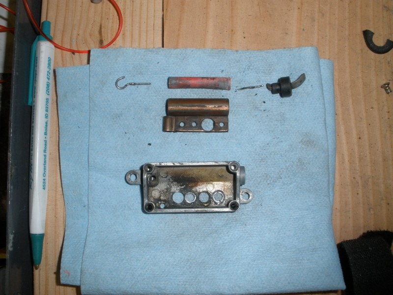

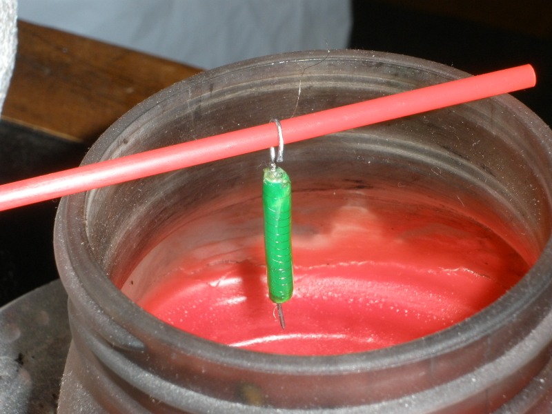

PostPosted: Sun Feb 28, 2010 8:19 pm    Post subject: Idling Enrichment Valve 021 129 052 A Rebuild Reply with quote
My rebuild idea worked! Follow along:
Crush the original insulator to see how it was built:
Layout the parts to illustrate the rebuild - the red insulator was my first attempt at building an insulator from heat shrink tubing and JB weld. It worked, but was very difficult to do.
These are the items I used to make the second insulator. Yep, those are lollipop sticks Razz
The lollipop stick proved to be too slick to effectively wrap the wire, so I coated the stick with the latex mold builder. This lets the wire "bite" into something and not slip around.
After I had wrapped enough resistance wire (I decided to use the 40 AWG) to get close to 65 ohms, I coated it in the epoxy. I mixed it and brushed it on with a small model paint brush. Then let it hang.
Here, you can see the wire wrapped around the insulator, under the epoxy.
After putting the enrichment valve back together, I test it by hooking it up to a 12v power supply for < 5 minutes. It opened the little valve, and after a few minutes of being disconnected, the valve shut again.
I'd call it a success.

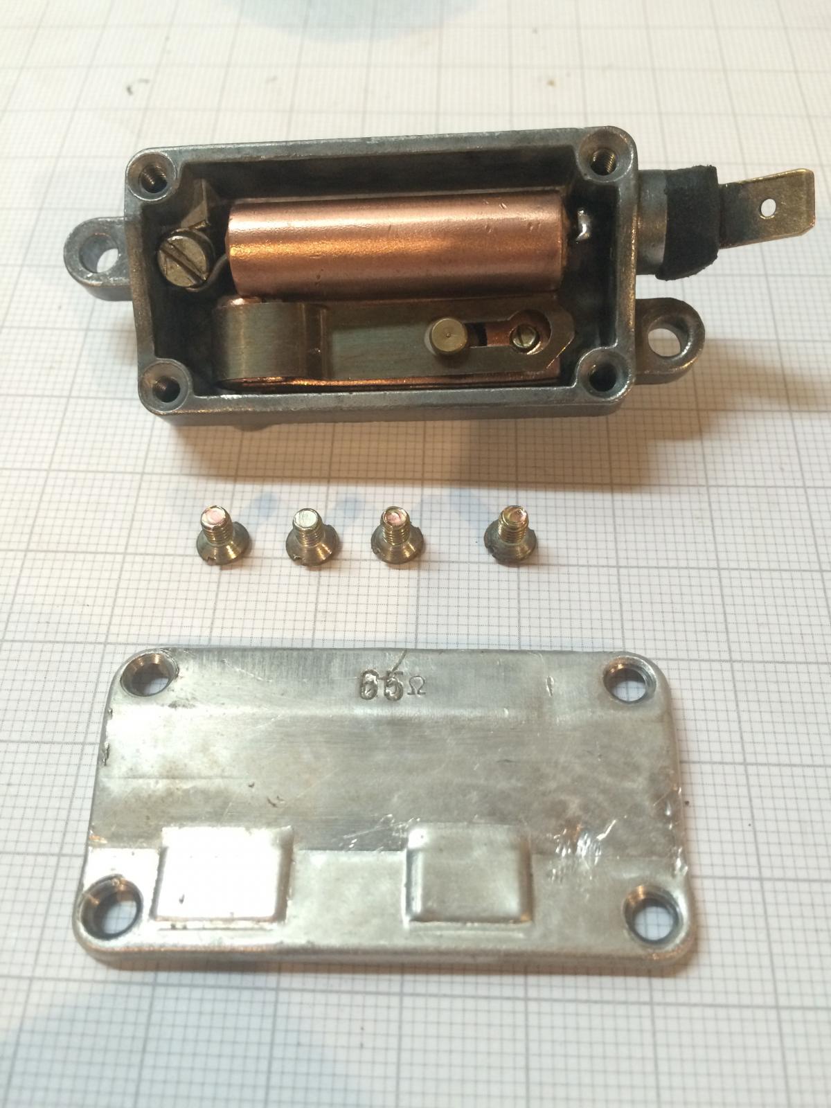

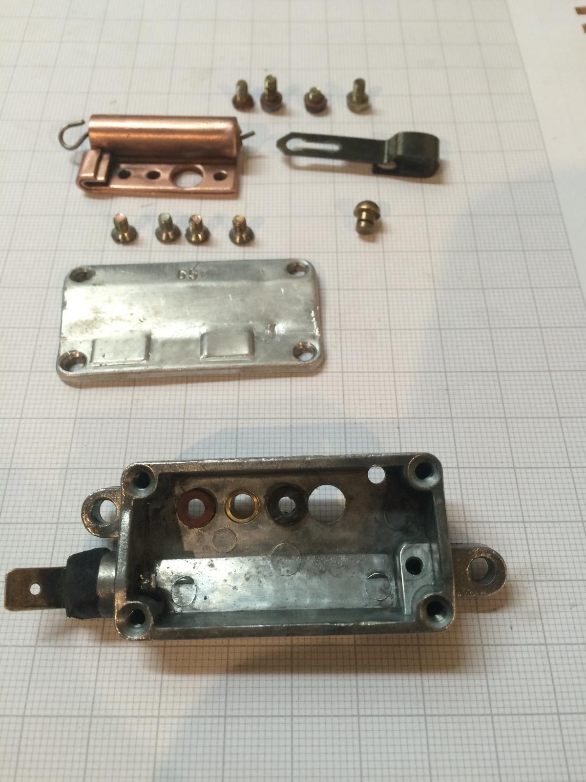

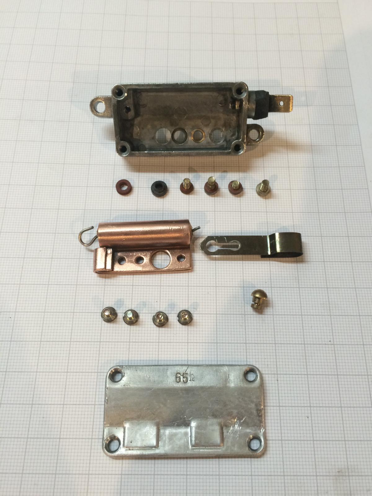

PostPosted: Wed Sep 09, 2015 4:05 pm    Post subject: Idling Enrichment Valve 021 129 052 A Sealing Reply with quote
One thing I have found is that the cover doesn't seal well on its own, and needs a little silicone sealer to prevent vacuum leaks. The bimetallic valve controls the air bleed for the central idle system. This air enters the enclosure through a small drilling that connects to a clean air supply via the float bowl. Another source of vacuum leaks is the opening for the screw that attaches the bimetallic strip to the copper radiator enclosing the resistor. If it isn't sealed, put a smear of silicone over it. There are small passages in the central idle circuit easily plugged by dirt that makes its way in from the outside of improperly sealed enclosures.
1800 Type 4 Berrien 295
Tcash
Joined: July 20, 2011
Posts: 12846
Tcash is offline
PostPosted: Wed Sep 09, 2015 8:26 pm    Post subject: Idling Enrichment Valve 021 129 052 A Reply with quote
Vanapplebomb any changes needed?
Thank You
Tcash
Vanapplebomb
Joined: November 03, 2010
Posts: 5572
Location: Holland, MI
Vanapplebomb is offline
PostPosted: Thu Sep 10, 2015 12:00 am    Post subject: Reply with quote
That is correct. Sorry I didn't bother to lay out the order of the screws. Excellent job with the diagram by the way.
Number 1, 2, and 3 have small insulators benieth the heads. Number 1 is conical, 2 is long, and 3 is short.

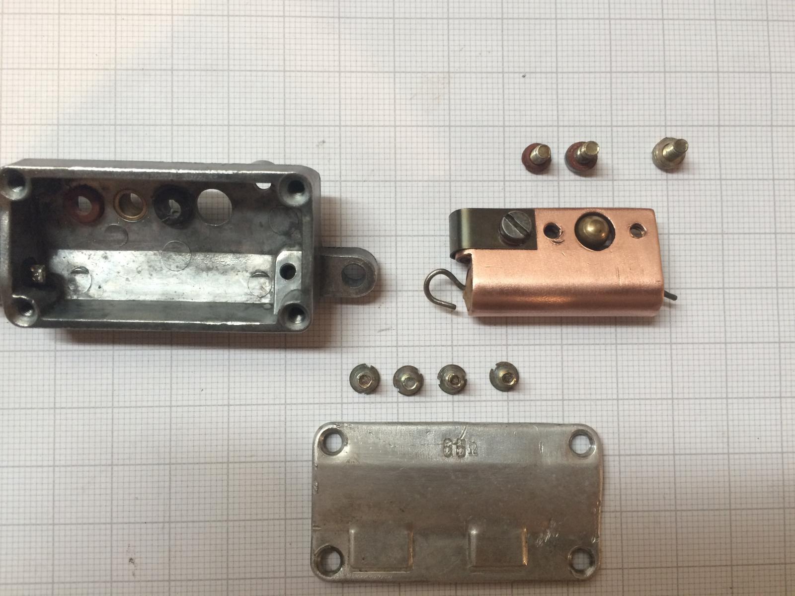

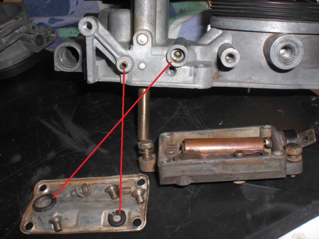

PostPosted: Tue Sep 15, 2015 4:36 pm    Post subject: Re: Idling Enrichment Valve 021 129 052 A Reply with quote
Tcash wrote:
Thank You
Tcash
This is one I bet a lot of people miss. Reason is that most diagrams that come with the rebuild kits only show the larger o-ring, so the small one on the inlet gets overlooked.
Now, most carburetor rebuild kits I have seen (exception being '70s Robert Bosch kits) have two small o-rings. The PDSIT 3 needs only one of them for the mixture adjustment screw. The PDSIT 2 needs three, so rob the extra one from the kit used on the PDSIT 3. Now you have two for the mixture adjustments and one for the enrichment valve air intake from the float bowl.

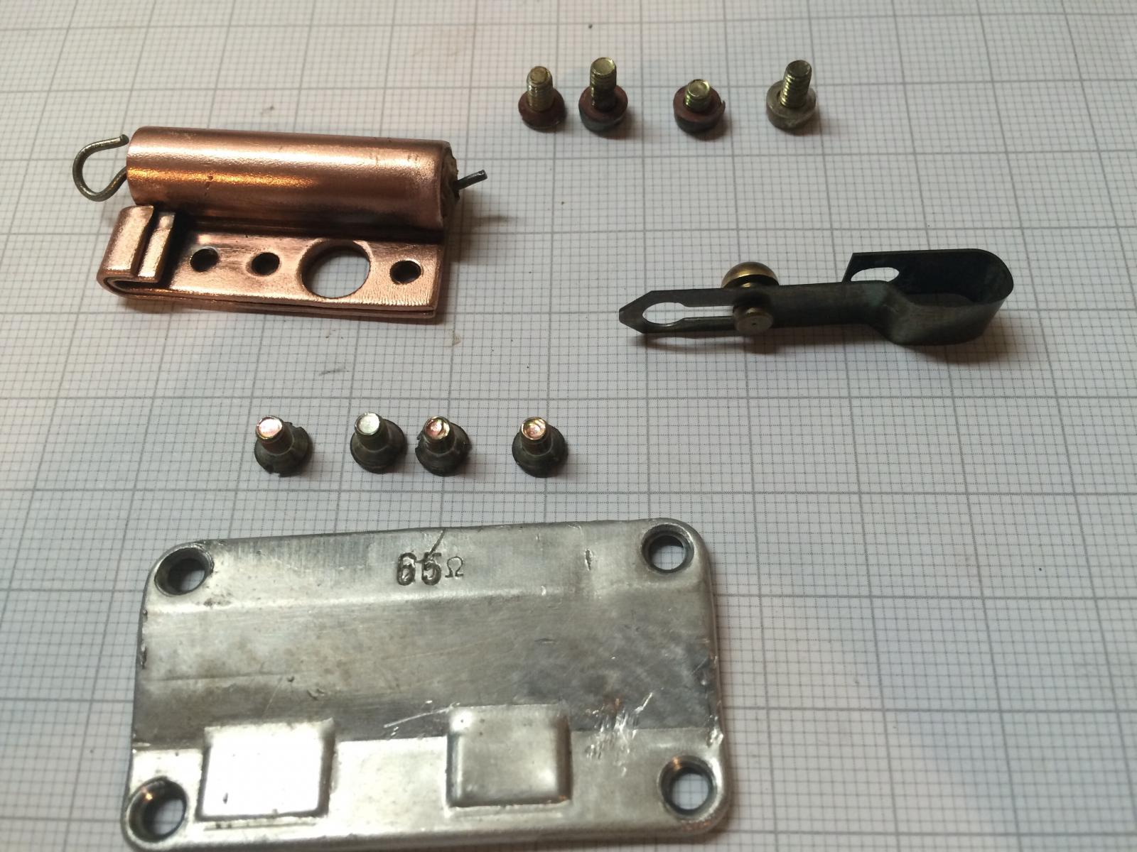

PostPosted: Thu Sep 17, 2015 7:00 pm    Post subject: Reply with quote
They are adjustable via the threaded brass valve seat. The back side is slotted for use with a large flat head screw driver. Some get pretty stuck with age.

PostPosted: Thu Sep 17, 2015 10:20 pm    Post subject: Reply with quote
Is this the adjustment?
Thank you
Tcash
Vanapplebomb
Posts: 5572
PostPosted: Fri Sep 18, 2015 3:22 pm    Post subject: Reply with quote
Yes, that is correct.
Turn it in (CW) and it will open at a higher temperature. Backing it out (CCW) and it will open at a lower temperature.
