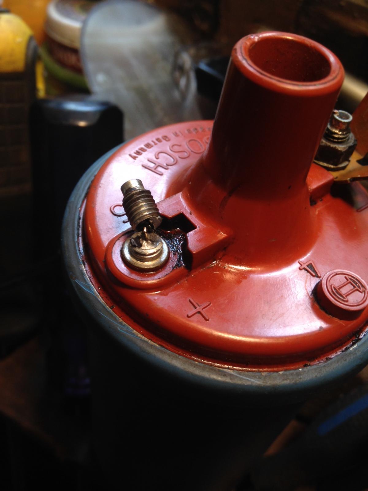

On to my question/problem, today I was cleaning some of the engine parts and took the terminals off the ignition coil to clean some of the oil and gunk off. When I went to fasten the nut on the + terminal however, the thread broke!!! Please see image below:
I am on a tight tight budget and as this build has already cost me a lot more than expected and will continue to do so, I would love to not have to buy a new coil! Especially as this is an original Made in Germany blue Bosch coil.
Is there anyway of repairing this terminal? Could I solder or even weld the 3 male terminal connector piece to the broken off bolt? Has anyone experienced this before?

Repairs would be suspect and that is a critical connection.
Used, working coil $20 shipped

I wonder how deep the broken post goes. maybe you could drill down into it a quarter/half inch, then use a self tapping bolt? just putting my macgruber out there. then when that dosent work, order the 20$ one

Thanks for the link, Tom. As I'll be ordering a few parts this week anyways I suppose I'll just throw in a $30 coil.
However I will also attempt to repair the broken bolt while I wait for parts. Even if it just becomes my backup coil.

The studs are cast into the cap when it's made, they are hollow and the wire from the windings goes into it and it's soldered, there's not a whole lot you could do to repair that reliably unless you soldered on a wire that led to a remotely mounted insulated junction block.

No. Don't waste your time. You're asking for intermittent ignition problems, overheating and burning up the coil, points, and/or condensor. I know it sucks to toss the coil, but seriously, don't waste your time.

Thanks for your help guys. Definitely getting another coil. I imagine I could just solder the wire from inside of the bolt directly to the little 3-terminal plate and somehow secure it all, but it seems like a waste of my time.

If you had a Hot Spot soldering machine available then you could probably solder it without doing much harm, but if you could afford such a machine you would likely not consider wasting your time trying to repair an old likely worn out coil.

The screw thread on the connection has snapped but the wire is soldered on still. If you are short of cash, wrap another piece of wire round the broken stud and solder it on, or lay one of the tags down on top of the coil and solder that to the stud - then you will have a spade connection.
Will not be the best fix, there will always be questions and worries, but if the bus runs then its cash available for fixing something else in the meantime.
That's exactly what I had planned. Don't know why it wouldn't work as long as engine vibration doesn't cause the spade connector to come loose from the coil...thanks for being supportive of my "ghetto" approach Smile
