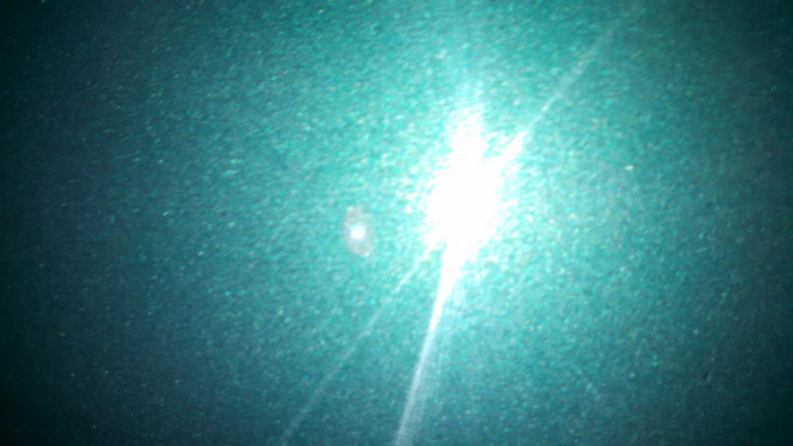

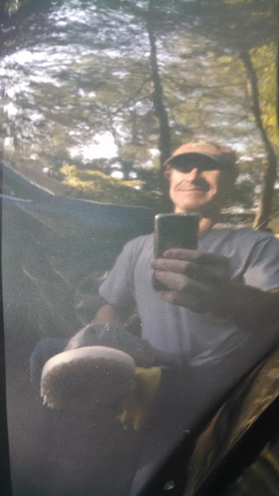

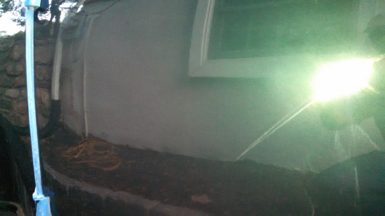

PostPosted: Thu Oct 08, 2015 5:03 pm    Post subject: Reply with quote
This one of the doors half compounded half not.
All the pics are compound only

PostPosted: Thu Oct 08, 2015 7:31 pm    Post subject: Reply with quote
Looks good!
