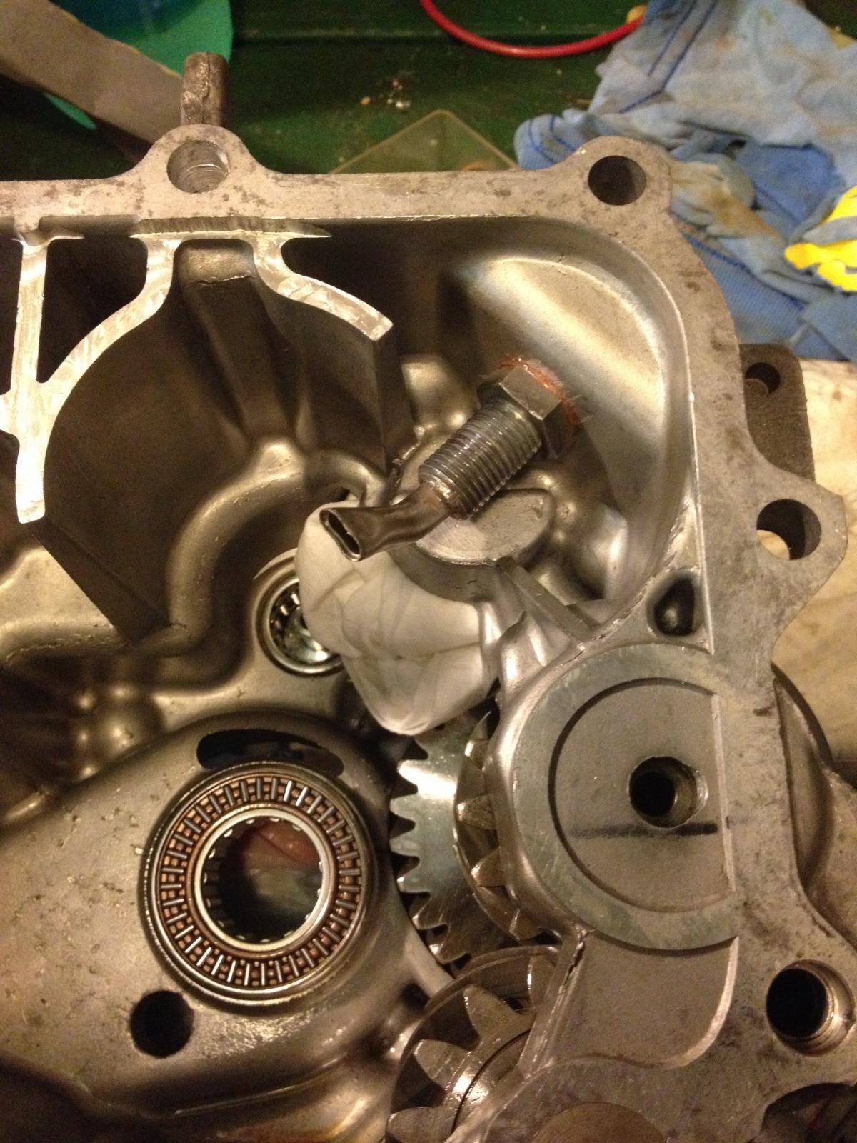

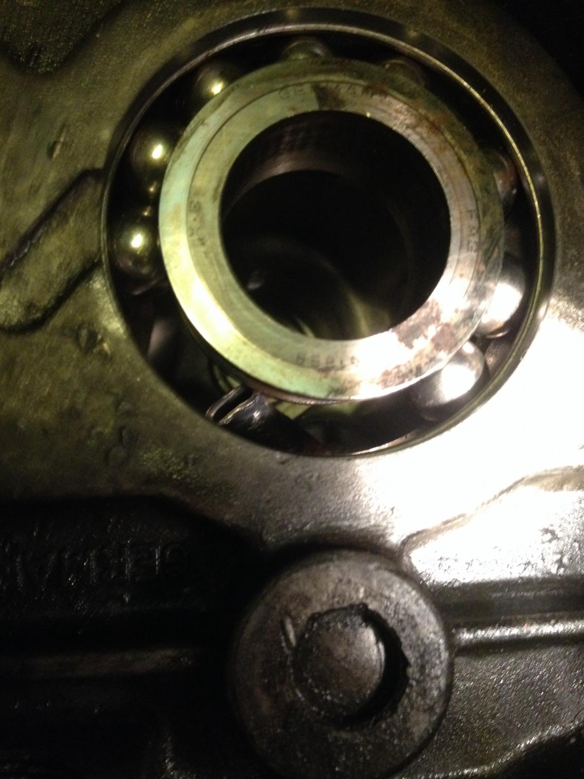

Today I worked on the mainshaft ball bearing oil squirter.
I received the WSV8L fitting I ordered from UK, same as this one here: http://www.kramp.com/shop-gb/en/411048/494720/260587/WSV8L+Bulkhead+elbow+8L
I saved an oil feed line for a 1.8 Turbo engine from an Audi A4 I found at the junkyard. All stainless steel, has 8mm hard tubing with nice bends,a banjo on one end, a flex line 8L on the other end. Lots of things to hack out of it Cool
Brazed in one end of the fitting. I had to modify the angle to slide the nut onto the threads and bend it back in when assembling on the low gear housing.
A little misalignement....
All good now, easy to check with an old bearing carrier and an old bearing in place Smile

I see problems pressing oil into the G-Gear case, and revoming it from main case.

I'm not a physicist, but I have some decent logic thinking.
If the supply and return have the same flow rates and the added oil circuit has been taken in account for extra amount of oil needed, I'm not "removing" oil from anywhere, but rather displacing it through a loop.
Second point is that it is not the only oil port for the return, I also have one for the pinion bearing and one for keeping a big steady flow for the main case itself which port is located roughly by 4th-3rd slider on the left side.
Another cooling circuit will be 4th gear>gundrilled mainshaft (for all the needle bearings) connected to the port that feeds the mainshaft ball bearing.
All return lines will be connected from a manifold fed by the pump.
And last, thankfully others have done it before me with great success.
Gute nacht.

Your logic thinking should tell you, that becasue of the syncro oil retaining in the bearing shield you will have always more oil in the g-housing, which means you have less in other places.
I am not sure if the oil will not block the vent while driving uphill.

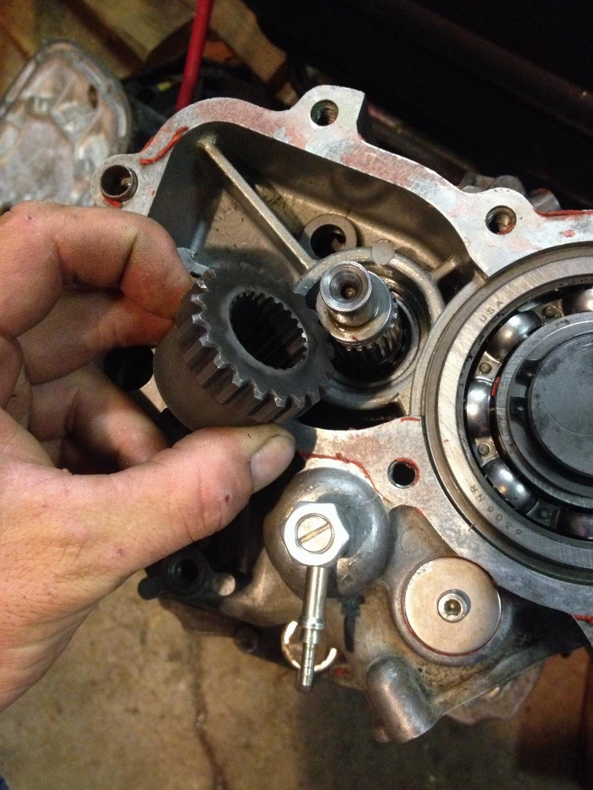

Alright, updates about the work done so far:
I've brazed the shifter plate rivet, although it looked healthy solid

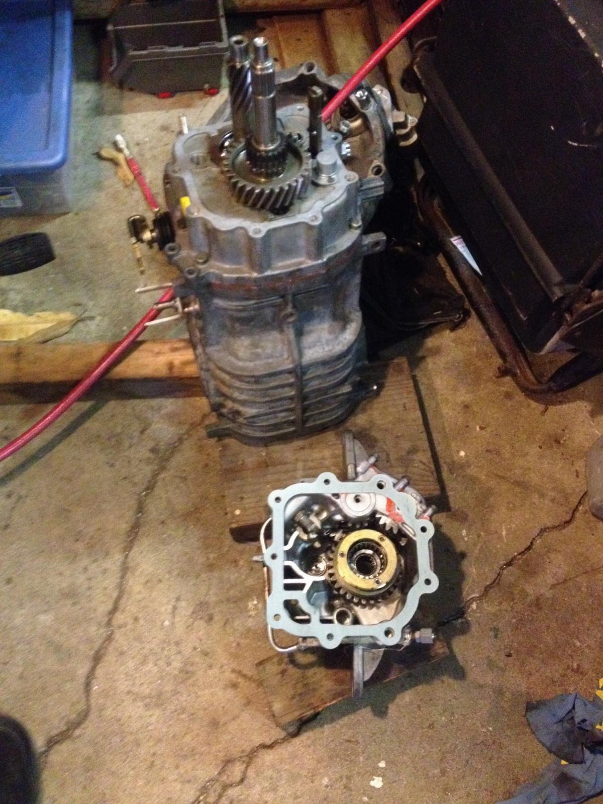

I've used an old low gear housing to sit the transmission in on blocks

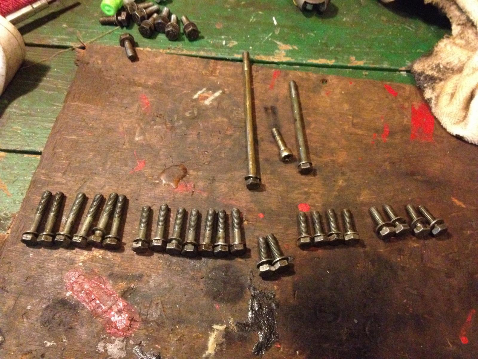

Puzzle time, missing a couple bolts after 4 years.... even with the best organisation, stuff disappear: unbelievable....
I heated up the main case with a mapp gas torch at the pinion bearing sleeve then dropped it in. To make sure the pinion bearing was perfectly aligned, I used an old bearing and put it in the case as a mock up and marked the case to line up with the 2 notches that are cut into the bearing to lock up the big nut.
Smooth as pie.Notice the fill plug has yellow gas teflon on the threads. That's to prevent the threads to seize in the case. Simple and effective.
Screw the outside bolt so it comes flush with the internal shifter plate, you don't want it to stick out and be in the way of sliding the shifter shaft in place.
Notice the spring clamp to help holding the fork shaft in place to clear the shifter shaft tabs. Everything needs to be perfectly aligned or it just won't go in.

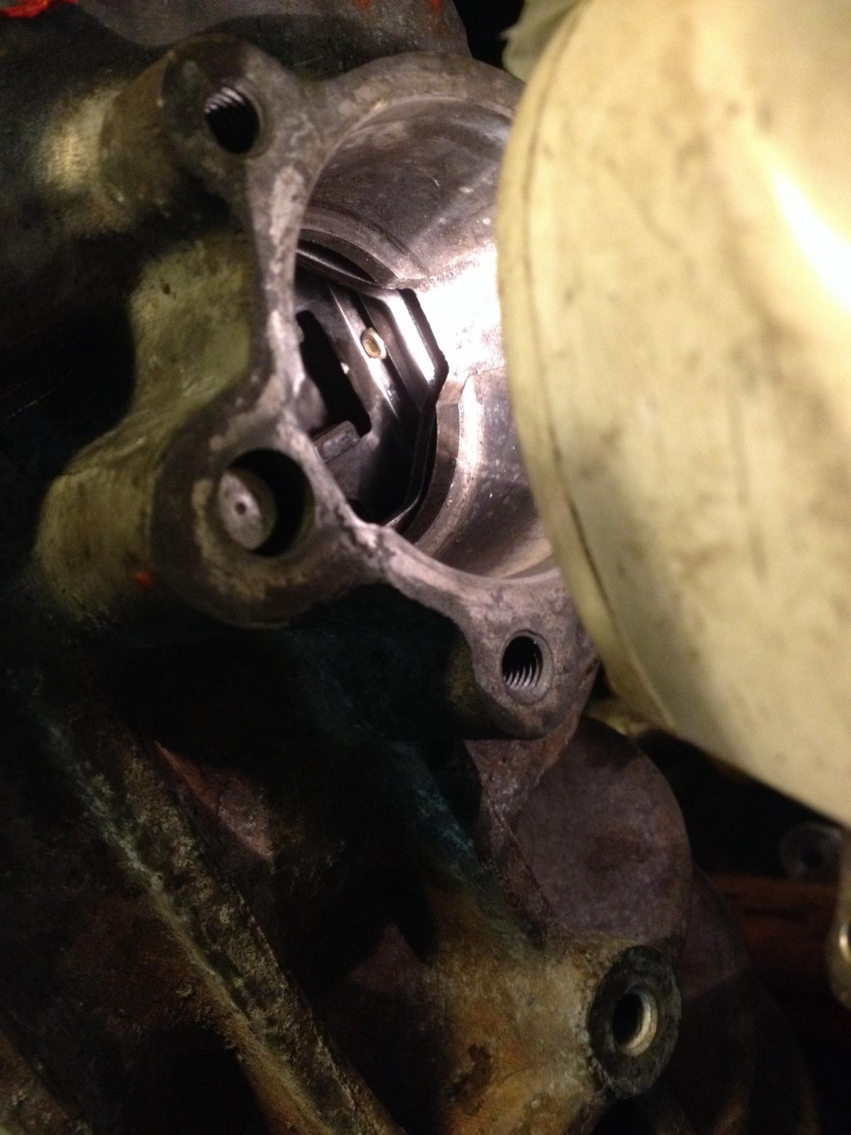

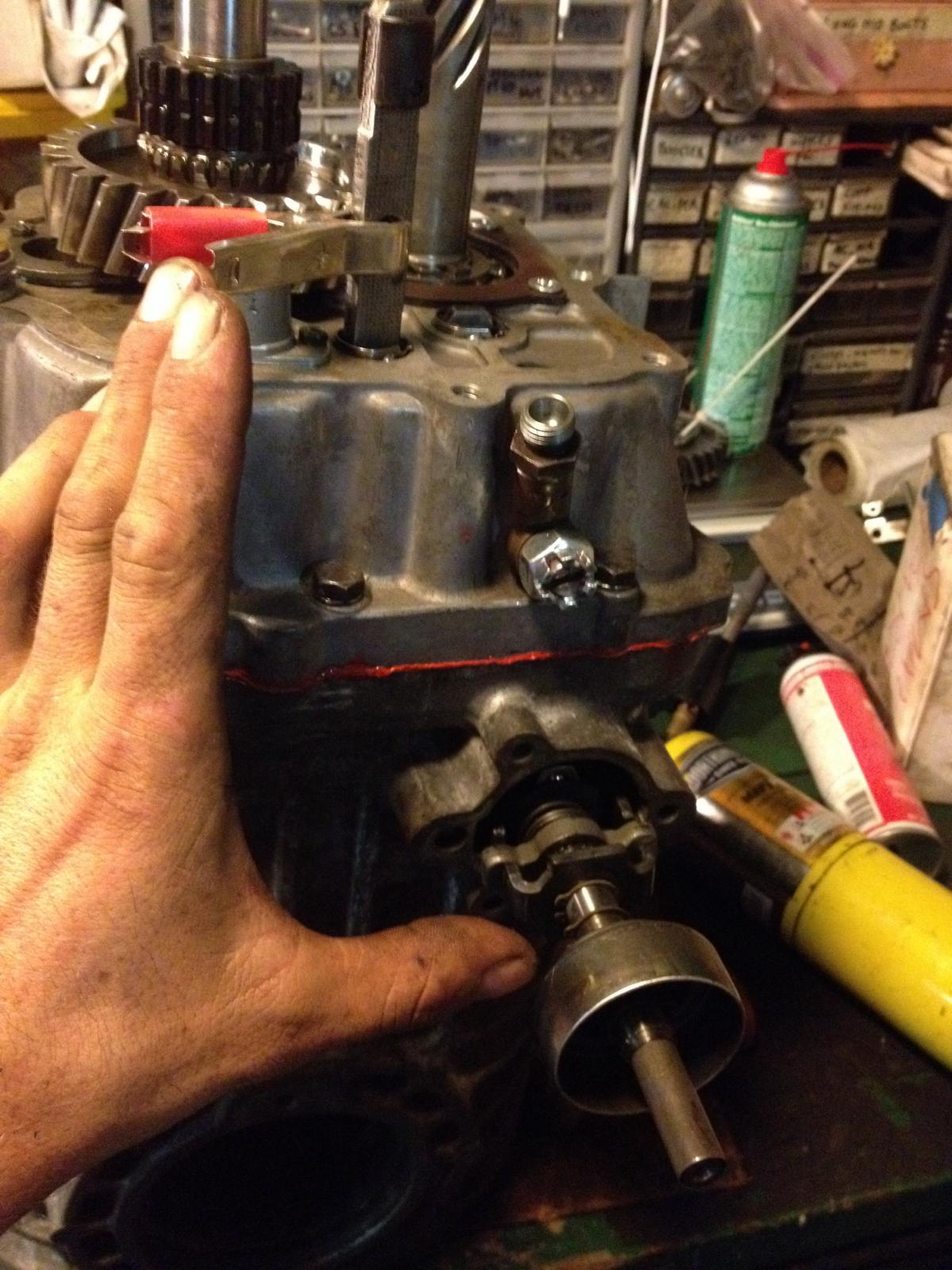

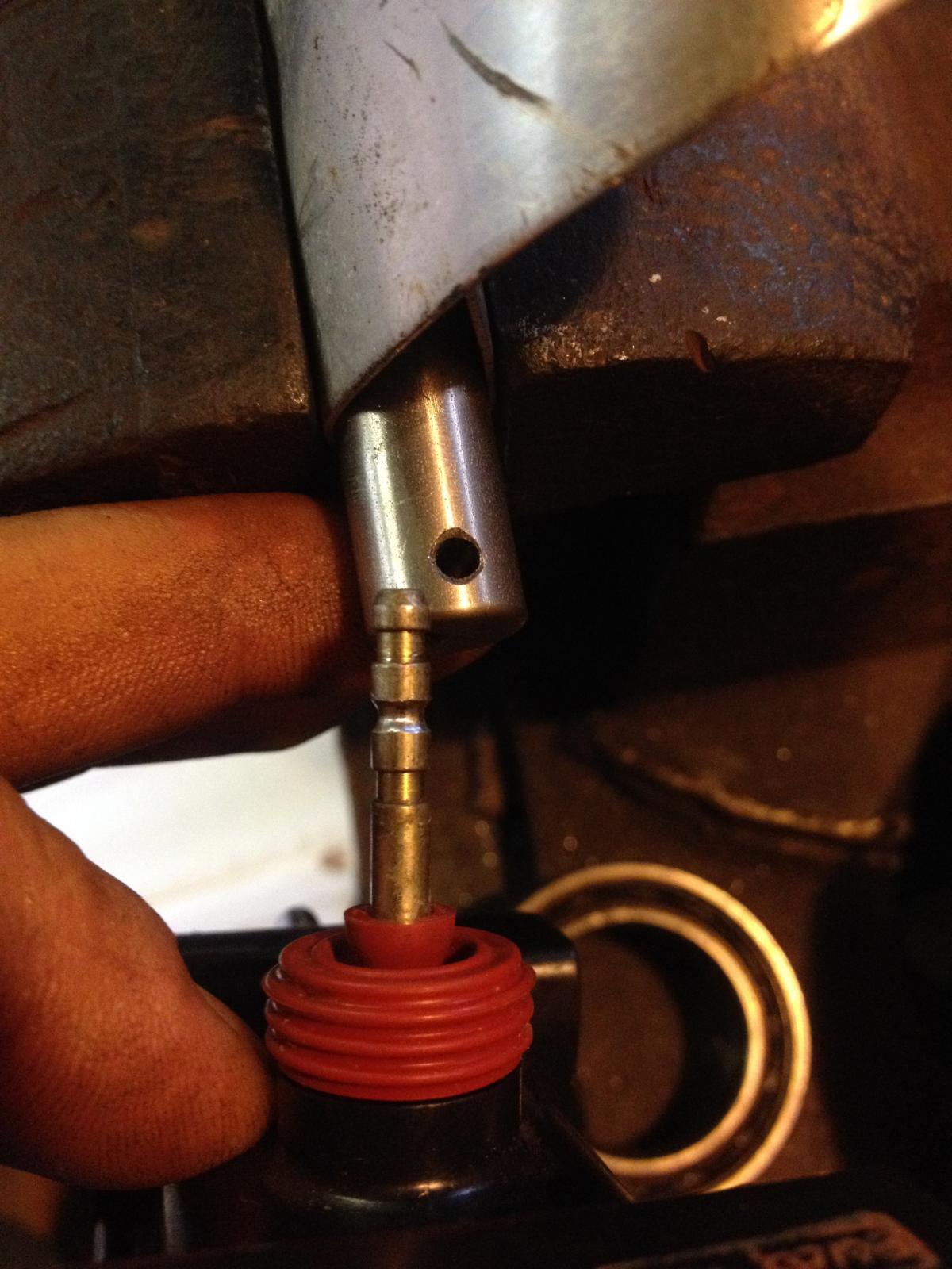

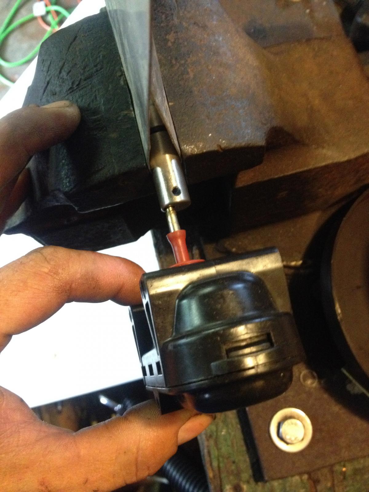

I installed the Mercedes vacuum actuator I had on hand. http://www.thesamba.com/vw/forum/viewtopic.php?t=454153
I had to re-drill the pin location on the little shaft: to do so, I inserted it in the fork actuator shaft and drilled through while rotating the vacuum shaft to get a 360° groove. Perfect guide Smile
I've installed back the old seal for the gear selector shaft. It helps keeping the rubber boot always expanded bc it slides back and forth on the shaft. Simple and clever Razz

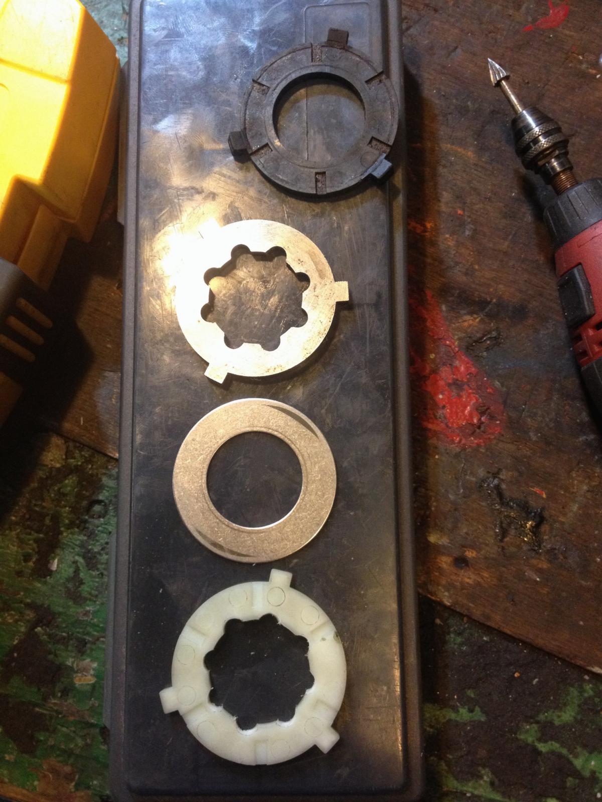

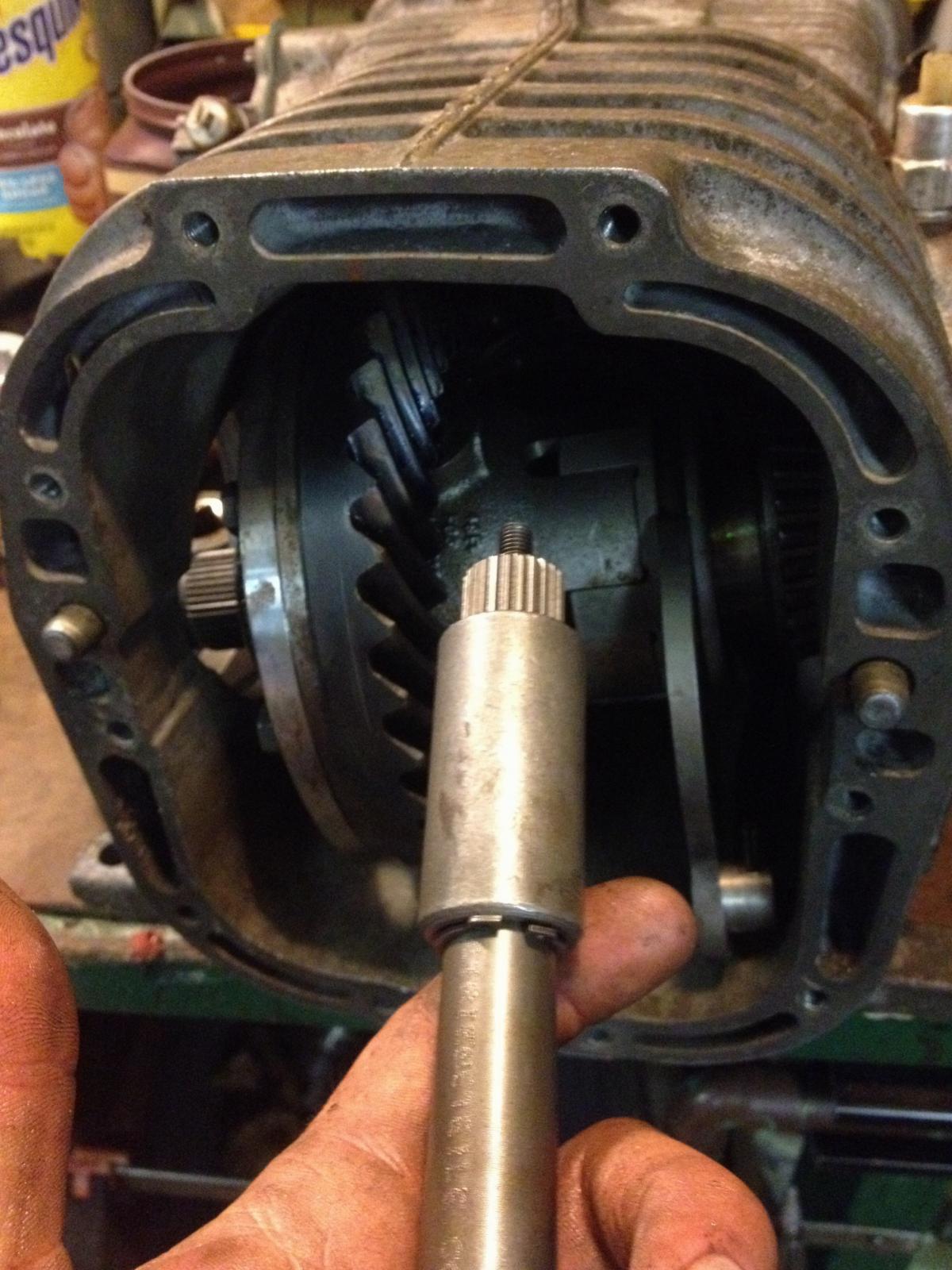

Collection of thrust washers for reverse gear. I had too much clearance to deal with and had Gears scratching his head while exchanging emails, until I realized I didn 't tightened the pinion bearing nut to torque first. What an idiot I am...

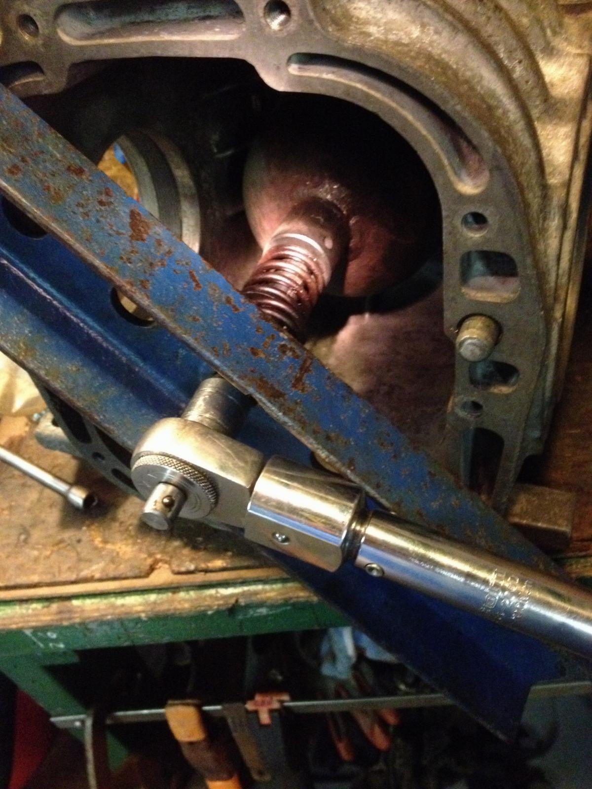

So off I go, with a pair of WBX valve springs to keep the nut tool tight while torquing.
Creatively bracing the transmission on the bench and the wrench tight.
Finished up with a piece of tube cut to length as a spacer to keep the tool super tight onto the pinion bearing nut. Took me a while but I got to the 225Nm torque, and then loosened it per factory specs, then went back to 225Nm and gave it a little more .

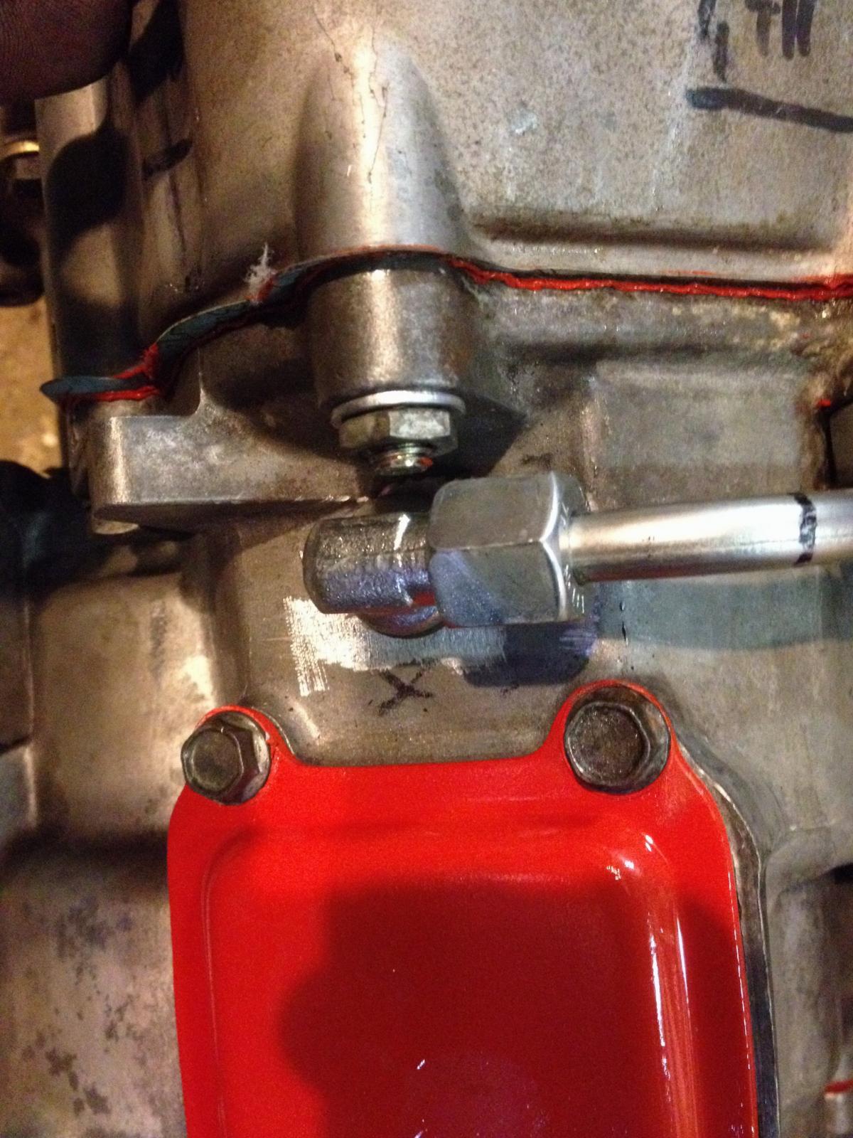

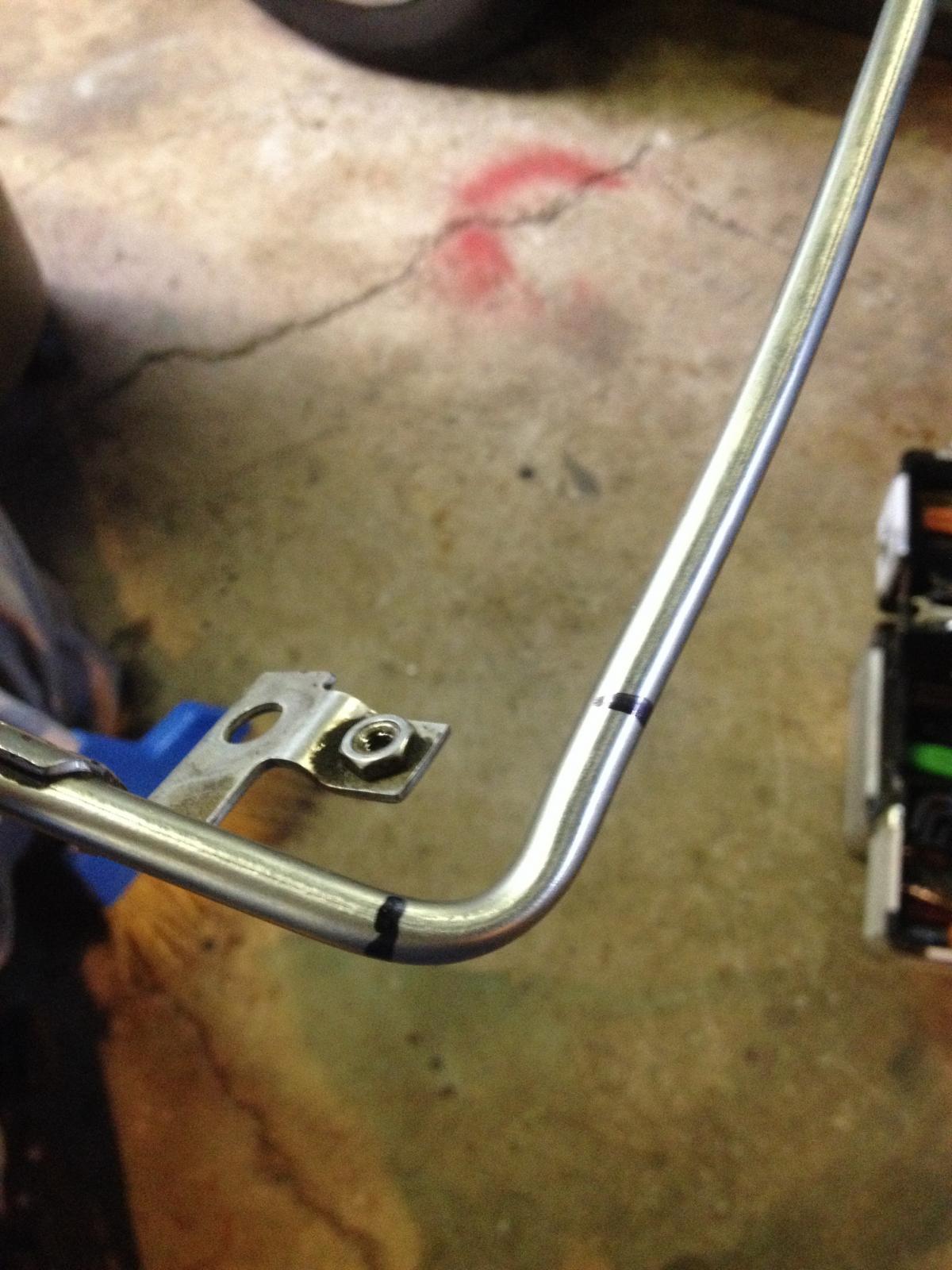

Worked and bent on the oil cooler line for 4th gear,mainshaft ball bearing and gundrilled mainshaft. That stainless steel Audi A4 1.8 Turbo oil line is the cream Idea
De-brazed the bracket off the line

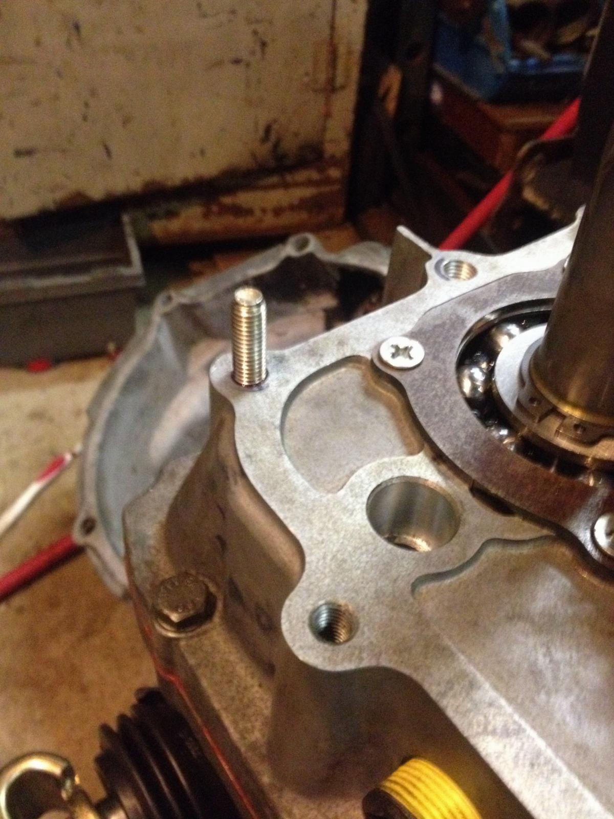

I added a stud to clear the hydraulic fitting elbow for the spray nozzle for mainshaft ball bearing.

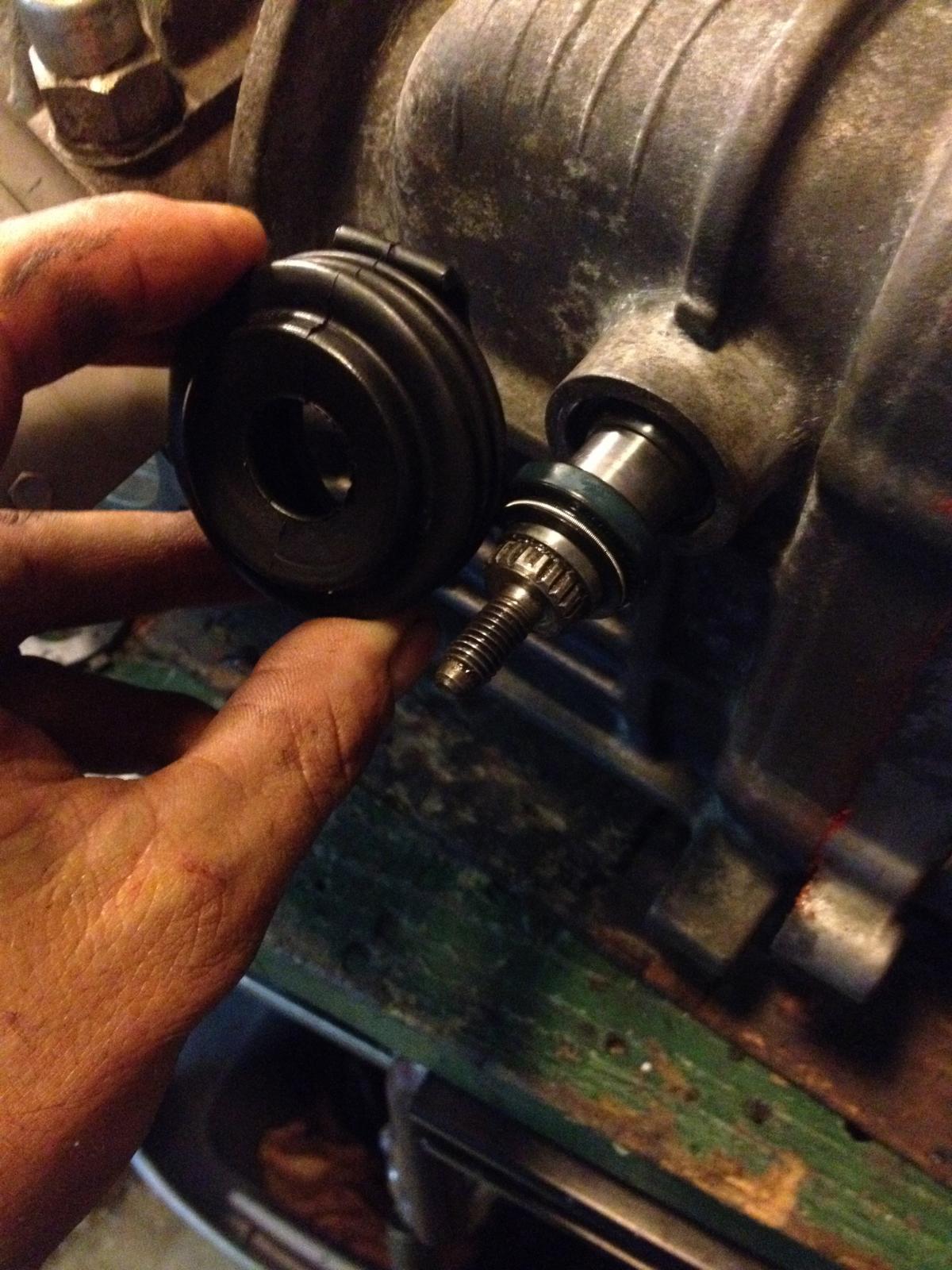

Mainshaft super hard to spin. What now again??

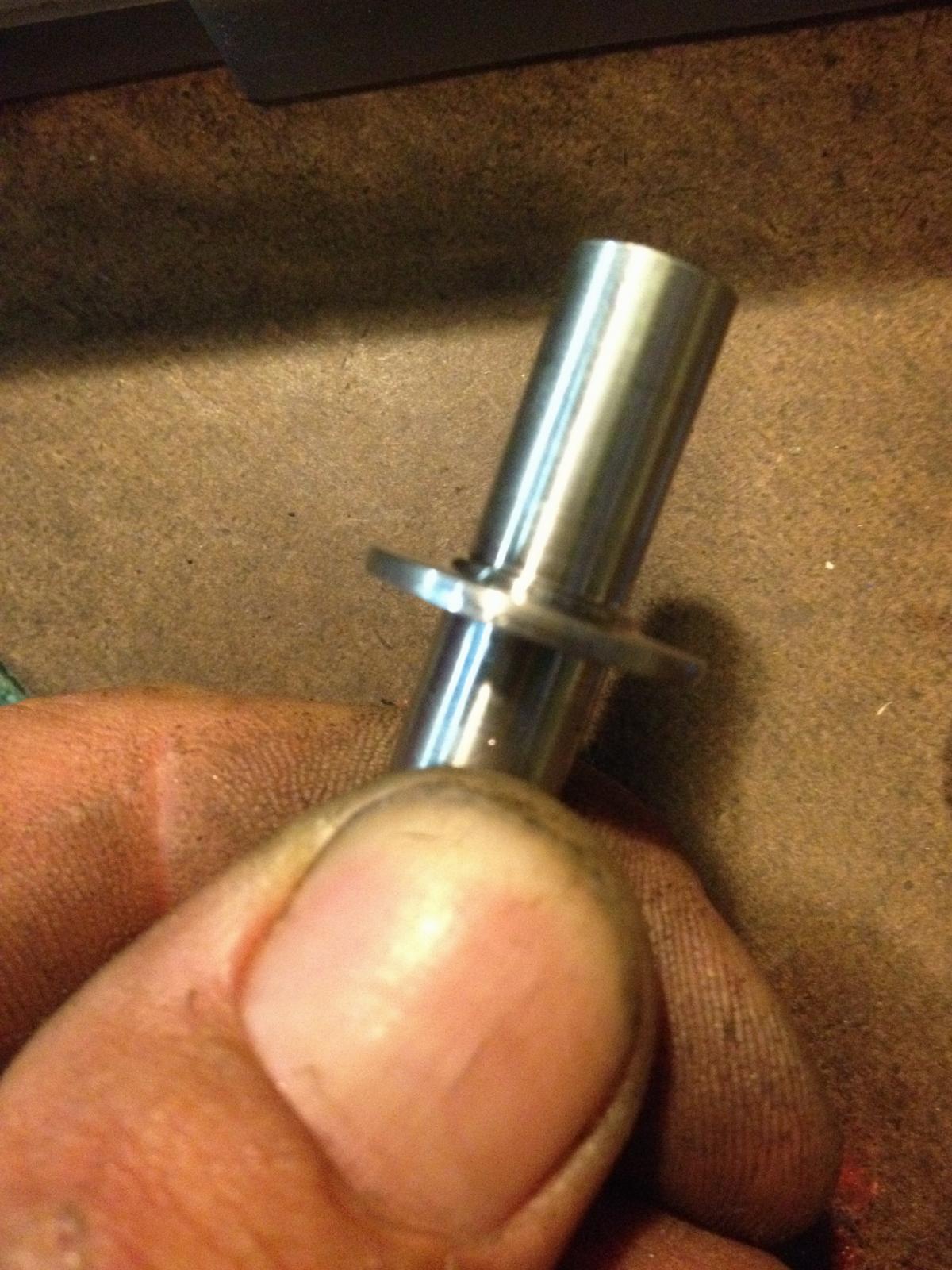

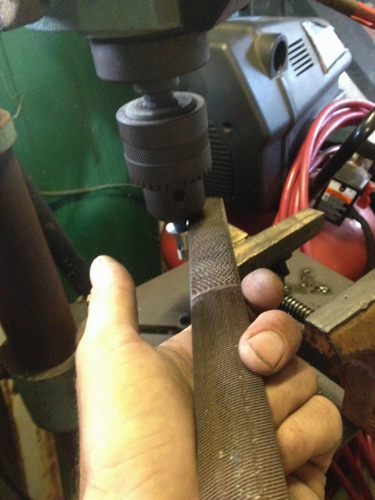

I took the nose cone apart for the 2nd time now. Turns out I didn't correctly design the oiling fitting for the gundrilled mainshaft. It was 2.55mm, and rubbing against the tip of the mainshaft Evil or Very Mad .
Time for some ghetto lathe action to thin it down a bit.File and drill press will do.
Success!! from 2.55mm to 1.75mm. Yesssss son!! Cool
Installing slightly less thick vitton seals for the output flanges.
I didn't want rubber but they seem to not exist in the original thickness.

I'm using the same method to hold my 091 to the bench while I tighten my pinion nut, although I didn't think to use valvesprings to ensure it stays seated! In the future, drill two sets of holes in either end of the c channel so you can have better leverage while loosening AND tightening it. If that wrench slips in the vice you will be hurting! (or the pinion teeth)

Icolquhoun,I'm not sure I understand your advice, I did drill the C-channel and bolted it to the main case. When I added the piece of pipe to keep the pinion nut tool all the way in, there was no way it was to ever slip out of there Wink
The C-channel stuck under the vise was to brace the transmission from spinning around Idea
