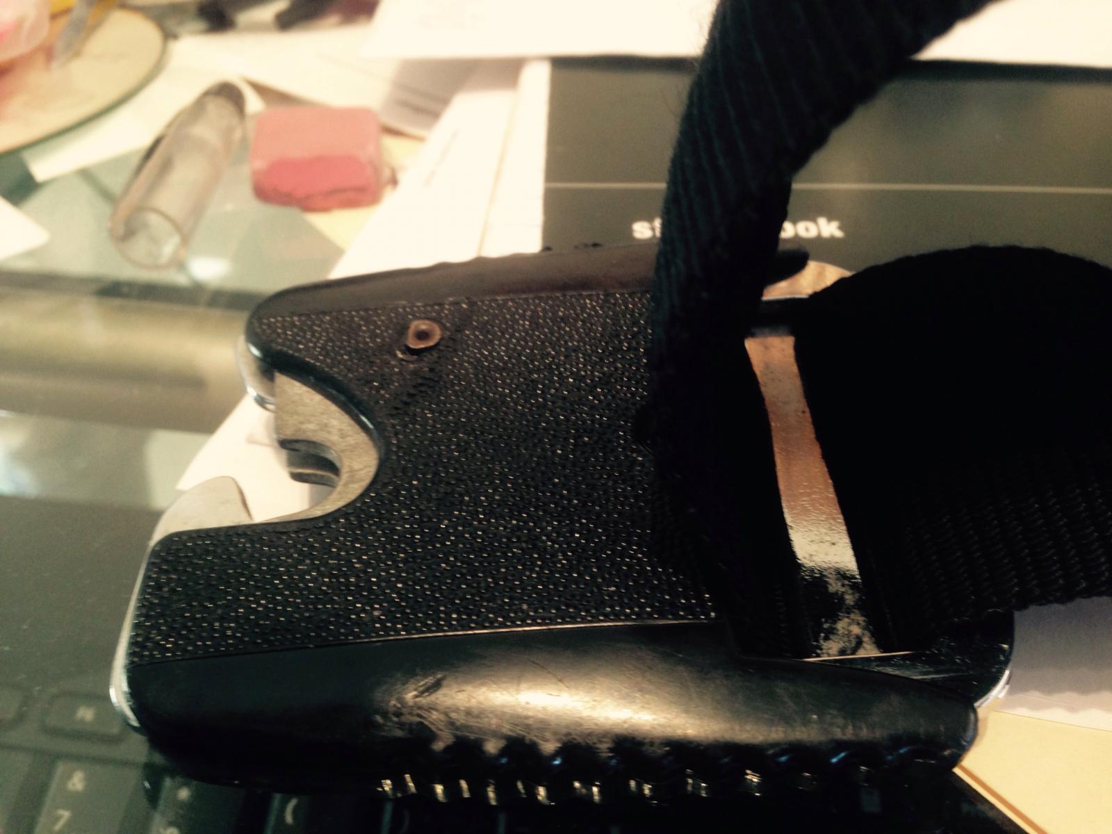

Here is photo of one of the seat belts. Looking to find out if covers from another set could be removed and placed on my belts before I invest in another set of belts

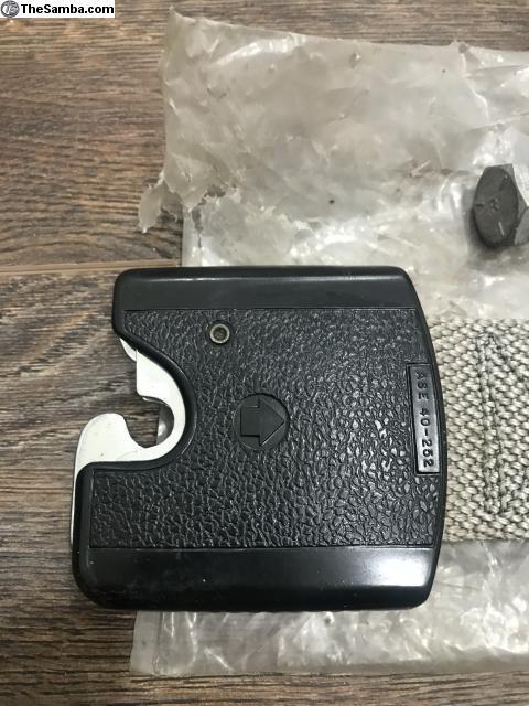

Don't think they are the same. Concept is similar, but mine are black and the covers don't seem removable.
They do seem to be original VW though. Part number is : KL-1-500/3.3/1968. I'm guessing they came off a 68 of some sort.
I have two of these. One, the belt portion is pretty much toast, the other is great. I have two much shorter lengths of belt that maybe were supposed to be used kids or something? Anybody wants them, LMK.

Those are the correct covers and look to be in good shape. It seems to me there has to be a way to disassemble but who knows. Do you have photos of complete belt. I might be interested in the lot just to explore the idea if the price is right. The others you have might be the rears. I need the center receiver loop as well as well as a ring that mounts behind the rear seat center.
That is a 67 convertible or Ghia "only" seat belt assy pictured above. (Klippan VW) The missing plastic claw covering likely might be different in mounting and function configuration than the later black "American Safety" (made for VW in USA) plastic claw covering shown below. Note additional chromed metal component, w/ engraved arrow and much thicker grip ribbing...

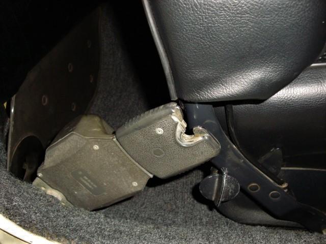

Original plastic cover on '67 vert belt from gallery:
....and fitment within the casing. The newer, bulkier "American Safety" covers might not work as well as an original Klippan cover 'scalped' from a 67 sedan or type3..

As a note, I believe that seat belt has been installed on the wrong side. The "bump" should face inwards, so the seat belt mechanism can be better shifted out of the way.
Someone can correct me if I am wrong.

Ooops... Embarassed I didn't realize this was an OLD post to begin with, and 2 of the photos apparantly didn't appear in my previous post - making nonsense out of what I was trying to say... Rolling Eyes
So, to better 'illustrate' what I was trying to say, here are the two missing photos of the plastic covers for comparison:
American Safety black lobster claw:
...and the Klippan as used in 1967's:
And, Harry - you are correct! The OP's photo with the missing cover is installed on the wrong side. The roll bulge should be facing inboard, not out. At this point, I'm curious to know whatever the outcome might've been 6 years ago for the attempt at putting the 'beefier' American Safety black covers on the Klippan mechanism..
