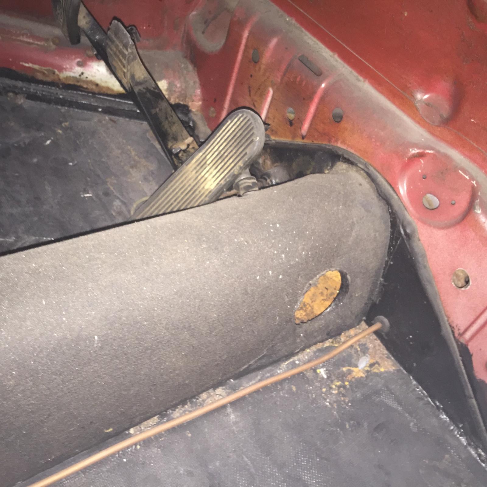

Or you can use a hole saw to make an access port, then you can peek in there and lubricate once or twice a year. Once the carpet is in you'll never know.
I've never actually cut an access port in my tunnel. Are you saying that any hole saw designed for metal cutting will be enough ? Or is something special required?

The hole saw idea is absolutely genius. That means you don't even really need to remove the pedal assembly to install a cable if it does break... may be a bit fidgety but I bet it is possible. One time of cutting and if you lose your cable in the middle of a drive at 2 am and you carry a spare cable (everyone should) it can be replaced in way less time than it takes to take the assembly out... AND you don't risk dropping the clutch pedal and having the cable fall off the hook... I say its a win win. Doesn't look like that hole compromises the structural rigidity of the tunnel either.
I can't imagine a hole saw wouldn't get the job done. (if It is for metal.)

Thanks but I'm not the genius that came up with this, I saw it as a tech article back around 1990 from VW trends. The saw is easily obtained from any big box retailer, lowes. Use with a pilot to get started and prevent wobbling. Notice it's back a few inches and up from the floor. I've never seen the mod cause any problems with structural integrity but its also quite possible to cut a modified u shape and fold up for service then fold down when done. As I said this wasn't my idea there are probably shit loads of cars running around out in California with this mod done. Speaking of structural integrity I've seen tunnel cut in three places to install a clutch cable guide tube when making autostik car a four speed. Here's some pics to get an idea. Sorry Steve but there's still an interest in this procedure.
