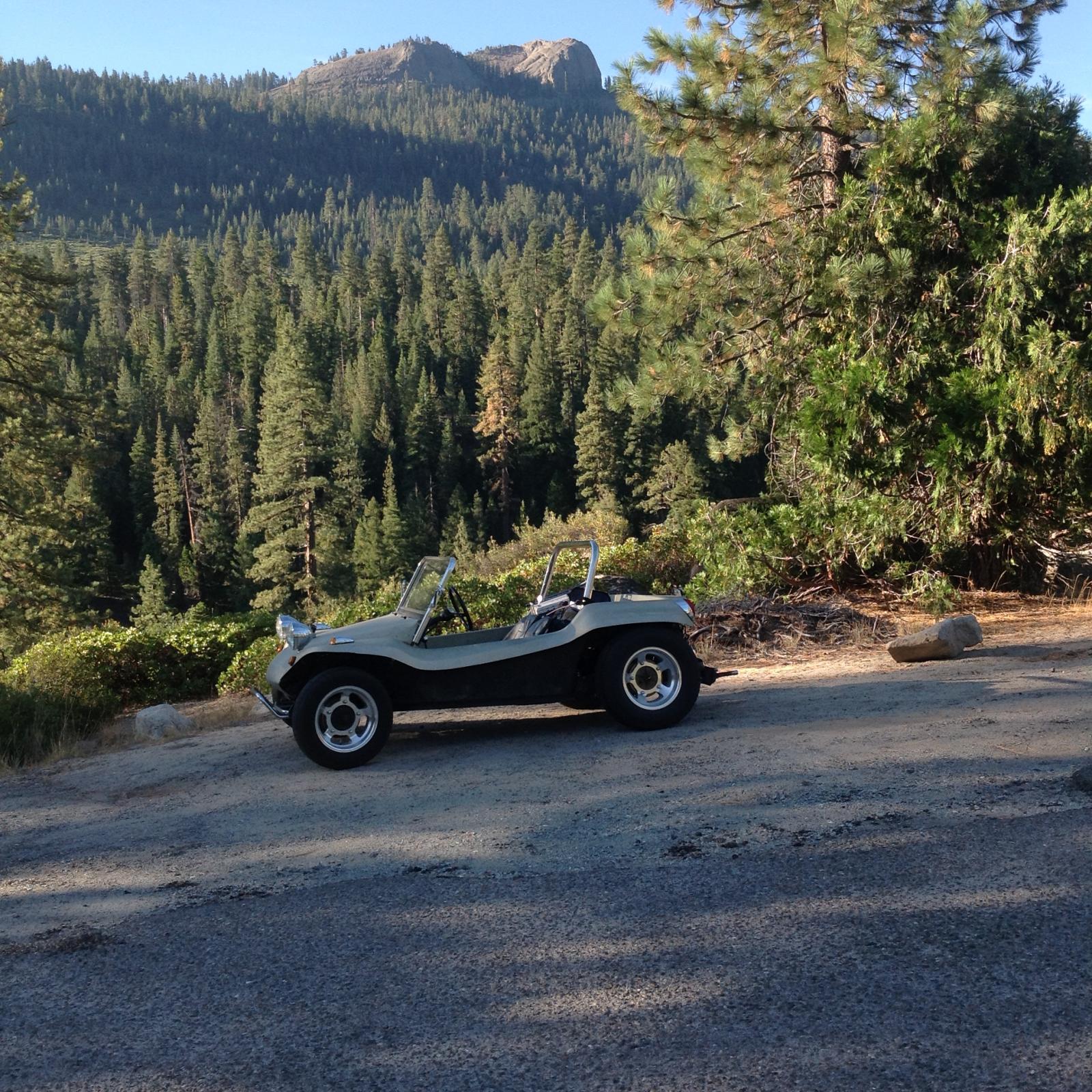

PostPosted: Mon Dec 07, 2015 7:43 pm    Post subject: Re: Manx roll bar angle Reply with quote
For me setting the windshield angle was more difficult than the roll bar. There wasn't a visible seam at the dash to hood like the Manx.
Made a 2x4 wood jig to experiment with the angle. The jig instructions came with the Berrien steering column windshield mount instructions.
All said and done the angle was approximately 28 degrees from vertical as others have said. Using the jig made it easier to do alone.
Once the windshield angle was established the roll bar was easier to set using windshield as a reference. Used a cargo strap to compress the bottom legs of the roll bar to fit into the body without a big struggle. Set top of roll bar 41" from windshield top. The angle looks good to me and allows me to use the Sombrero top from TJ Kustoms although I have not ordered it yet.
(too busy buying parts for another buggy)
Pictures of 2x4 jig and buggy at Sonora pass on the way to Lake Topaz.
More info on windshield angle post on this forum with good information and advice from others.
