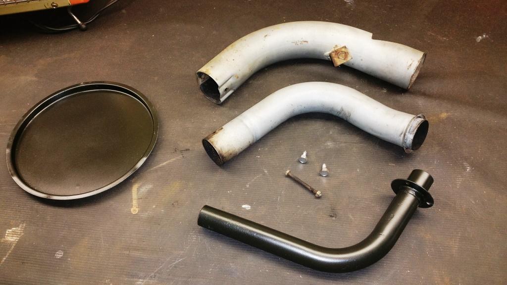

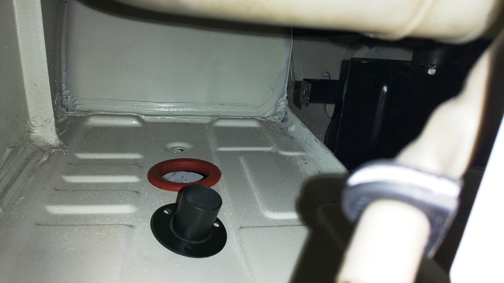

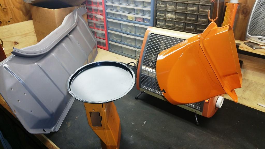

So with Pitwagen getting on his BN4 - his progress kicked me in the but as its high time I put the BN4 in the 74. Its fitment has been holding up inal engine bay resto and putting the engine back in. So I slowly worked on putting the Eberspacher in.
I took it slow because I was cutting holes, and fitting ducting to the fire wall. I wanted it to be right and as the dealer/factory would of done when Heintz or Deiter put one in. Call me Claus because I think it looks good
As some of you may have seen in my 74 thread - I started by cutting the return air stamp in the back, fitting the snorkel receiver, painting it all up with the protective grill on it.
After that I cut the fire wall to accept the ducting - I did it while I had a og one to copy - so I made a duct tape template, traced it and cut it out of the 74's fire wall. I took it then and put it into place, fitting the duct in - drilling a couple new hoels for it as well. Using the duct and and old unrestored unit - I put them in and used them as a template. It helped me find the spot where the stand holes need to be. I took it all out and re painted the firewall a better gray, put new gasket all around and put it in.
When I was painting the firewall, I also painted a duct piece and the paint lid cover on the other side of the engine bay - it was white from the painting of the bus.
I then went to home depot and bought a couple of metal hole bits. A 51mm and a 29mm, closest I could get. Next I used busdaddys super pic of where the holes go and measurements - hence the bits. I did a quick measure - checked it once or twice then drilled some holes! After that I cleaned it up and put the exhaust silicone gaske in - fit perfect Cool
I pretty much stopped there. I still need to put the insulation and board back in the ceiling of the engine bay, I need to put the thermostat duct section & cable in as well as cut the hole in the cab. After that I can fit the heaters exhaust and fresh air intake. Most of that's ready to go, just need to do it. I am also going to peroxide/UV light the snorkel to see if I can whiten it up - looking forward to that one
But the bulk section of the project is done. For now.

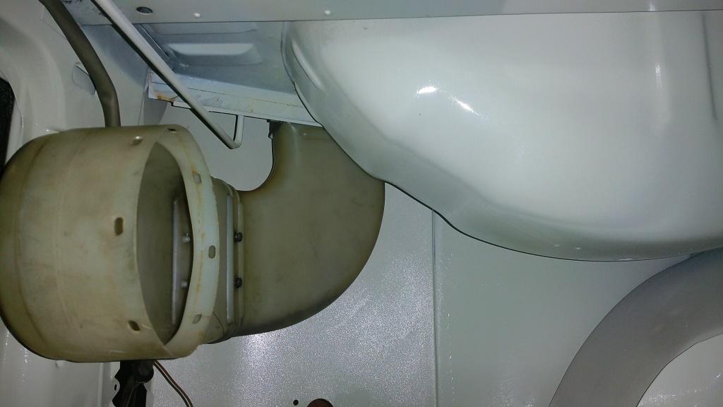

Just a separate post to identify a couple of issues I found with the BN4 install into my fuel injected bus. Didn't want this to get lost.
The hole that must be cut under the back seat next to the left wheel well is much larger that any of the diagrams show due to a raised panel piece that is not present on the earlier non fuel injected units. That extra metal must be removed in order for the discharge pipe that goes into the cabin to sit flat. It is quite obvious and the rubber seal still works well.

Here is the pic Ian did when he put his BN4 in a 79.
t3kg wrote:

Yup. That looks like the bigger cut out. I will try for some underside pics but it will be a few days until the rain stops. Can't get under this beast without jacking it up quite a bit. Everything is done outside. More precious toys in the garage!!

I'll get a pic of the shut off too.
